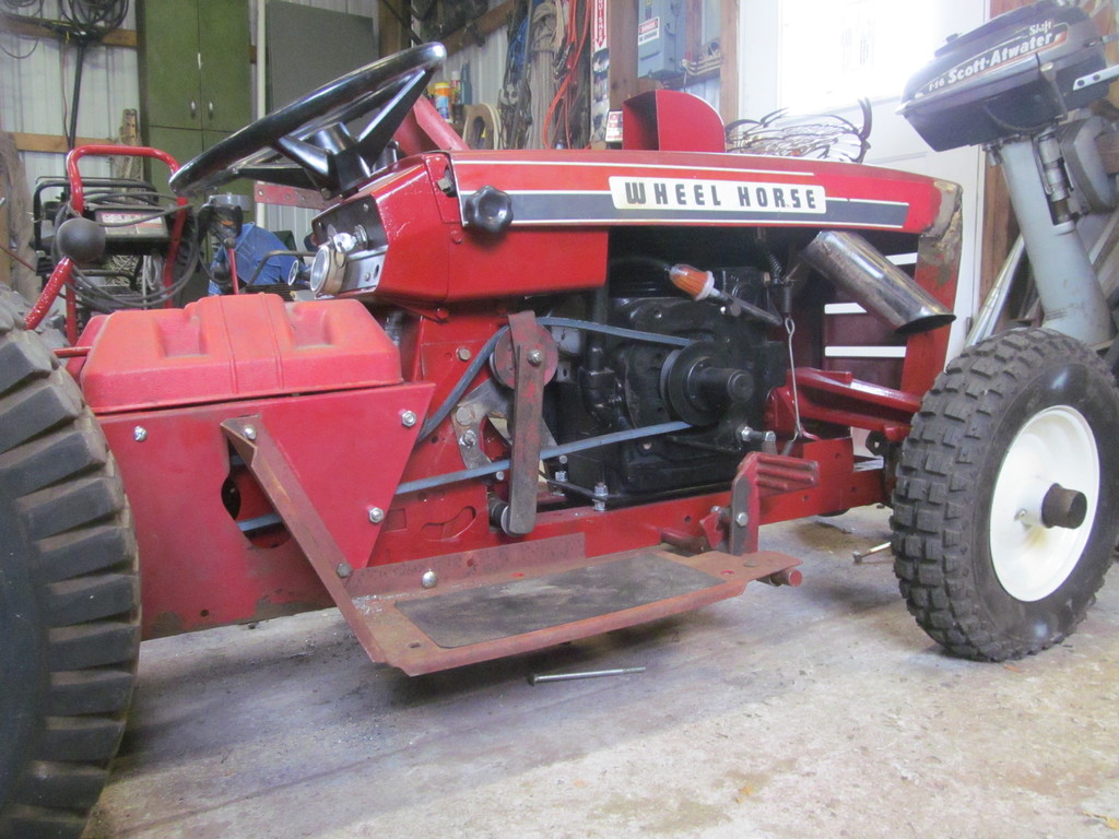

Ed Kennell 44,096 #6 Posted February 13, 2017 (edited) I agree with Jeff and Dennis.... I have good results with the TSC Kevlar belts. They are reasonably priced, available locally, and are rated for the back bend idler use. When I was building the clutch for the low rider, I actually bought 3 different length belts and built the clutch around the one that fit the best with the pulleys I had available. Then returned the other two for a full refund. Edited February 13, 2017 by Ed Kennell 5 Share this post Link to post Share on other sites
