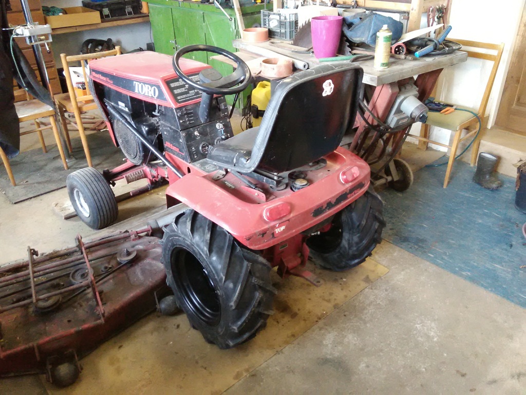

CZHorse 44 #27 Posted March 7, 2017 Just repainted the rear rims and mounted BKT ags.....not original silver, but matt black....need to do the fronts to match! 4 Share this post Link to post Share on other sites

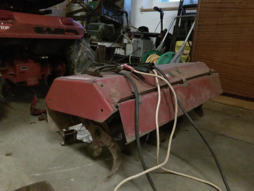

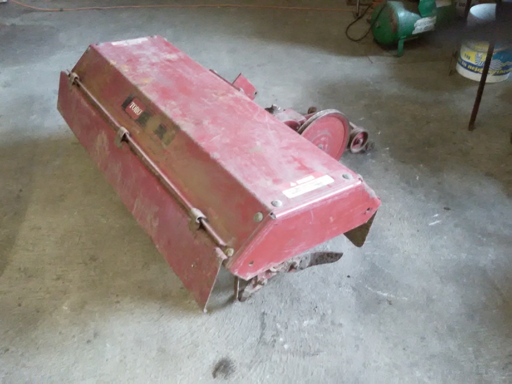

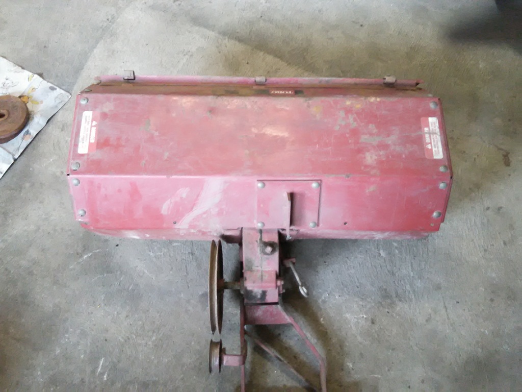

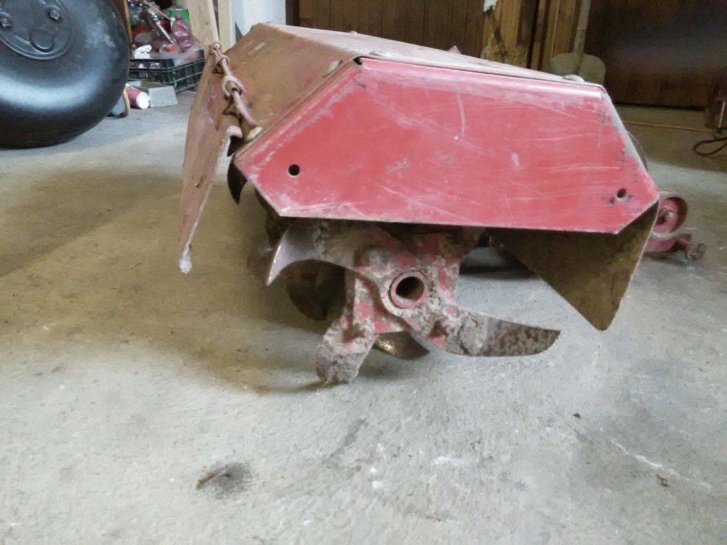

CZHorse 44 #28 Posted March 10, 2017 (edited) Just brought home a rototiller/rotavator. Wheel horse here is CZ are virtually none existent, so when I found the rotavator for sale I was shocked! Better still it was in the town where my neighbour works....I lent him my trailer and he picked it up yesterday It is in amazing condition, tines are sharp and still half covered in paint!! Turned out when my neighbour picked it up that the guy selling was clearing out his grandfather's barn. He also has a mint 416-8 with cutting deck and maybe some other stuff....hoping he has a plough... He had been thinking about taking the implement to the scrapyard!!????? So I may end up with another tractor!! He said he will phone me once he knows what else is hiding! Edited March 10, 2017 by CZHorse 3 1 Share this post Link to post Share on other sites

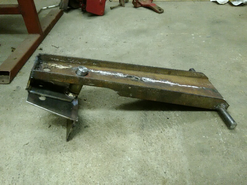

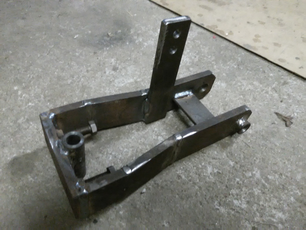

CZHorse 44 #29 Posted March 22, 2017 Some pics of what I have been up to.....😀 3 Share this post Link to post Share on other sites
C-121uk 183 #30 Posted March 23, 2017 Nice find and some nice fabrication work you're doing there! Share this post Link to post Share on other sites

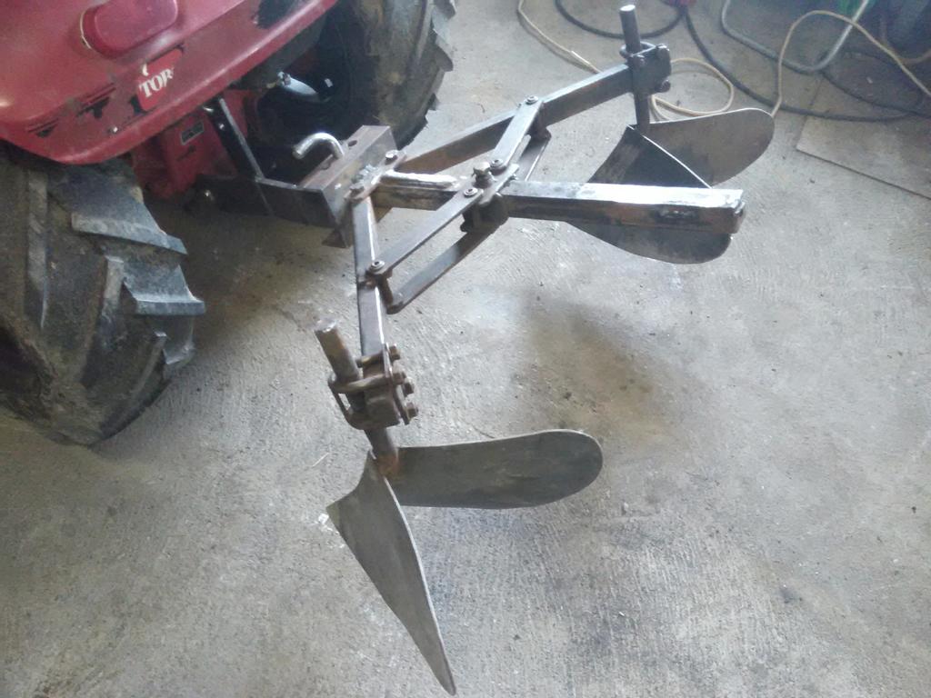

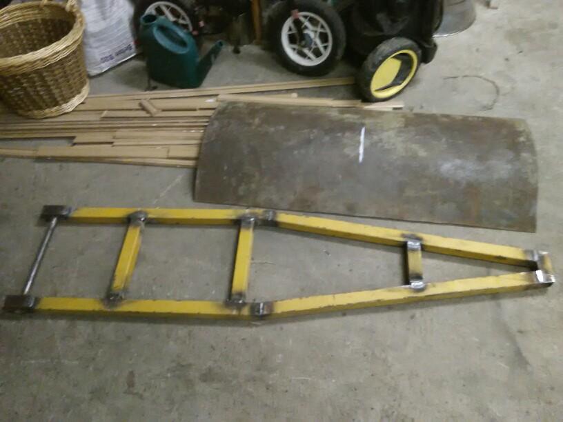

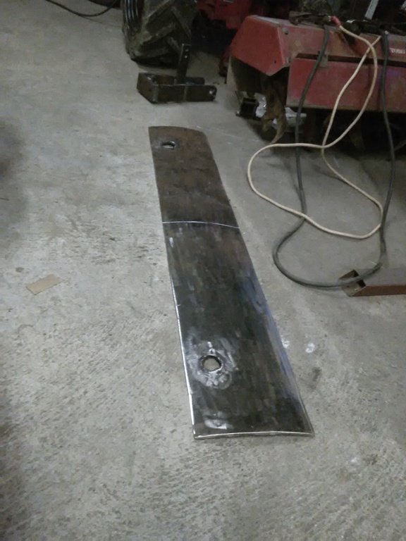

CZHorse 44 #31 Posted March 23, 2017 (edited) Working out dimensions for the potato harvesting plough....see pic. Got the pulley setup for the tiller finished and have a belt on order....measured it at 3400mm, sound about right?? Some things, like the pulleys I have had made at the steelworks where my Father-in-law works. But where at all possible I try to use reclaimed material. The grader blade is from an old 1000L boiler....5mm thick (also have a deeper blade cut from it for a snow plough). The local football grounds are being refurbished and the boiler had to come out. My Father-in-law and I wrestled it out, cut out what I needed and got nearly £100 for the scrap copper piping that was in the boiler.....so, so far I'm quids in! Edited March 23, 2017 by CZHorse 1 Share this post Link to post Share on other sites
CZHorse 44 #32 Posted March 24, 2017 Potato hiller ready. All hitched up and ready to go. Looking forward to the planting season. And yes those blades are stainless steel. 😁 2 Share this post Link to post Share on other sites

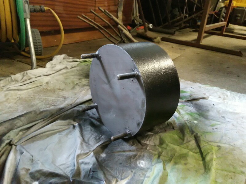

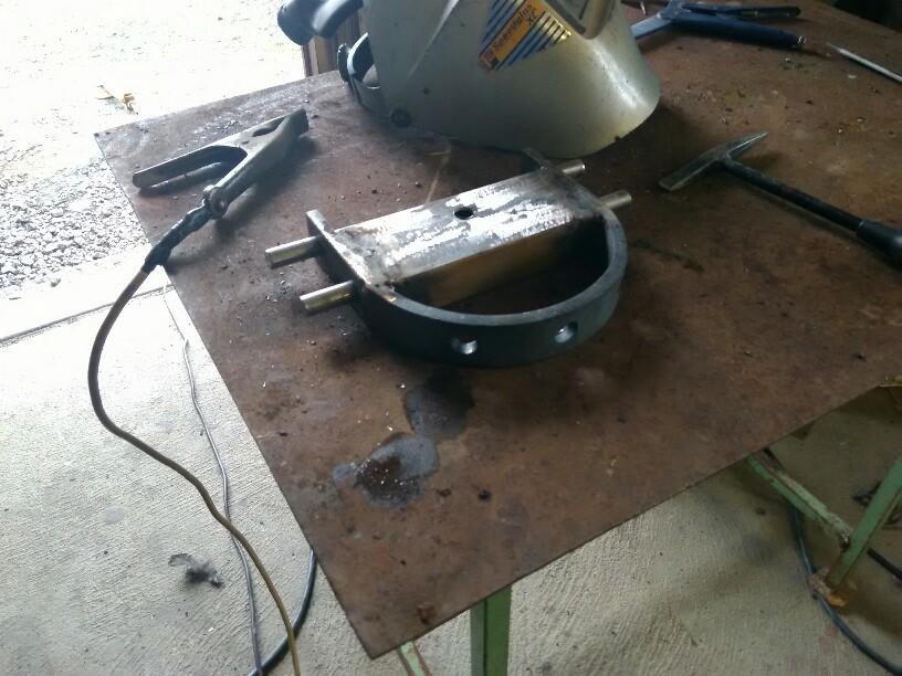

CZHorse 44 #39 Posted April 7, 2017 Wheel weights done. 24cm round stock, cut to 115mm - 41kgs a piece! 3 1 Share this post Link to post Share on other sites
Lee1977 7,356 #40 Posted April 7, 2017 (edited) 7 hours ago, CZHorse said: Wheel weights done. 24cm round stock, cut to 115mm - 41kgs a piece! That's 89 pounds. Should get the job done. I have two layers of 1 1/4" steel boiler plate about 84 pounds on my 312. I've built most of my attachment to. Didn't have to build the clevis hitch, you did a nice job on that. Edited April 7, 2017 by Lee1977 2 Share this post Link to post Share on other sites

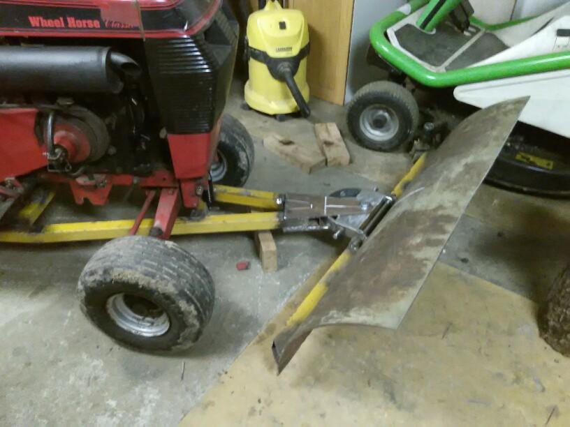

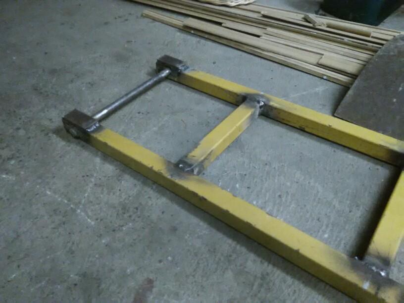

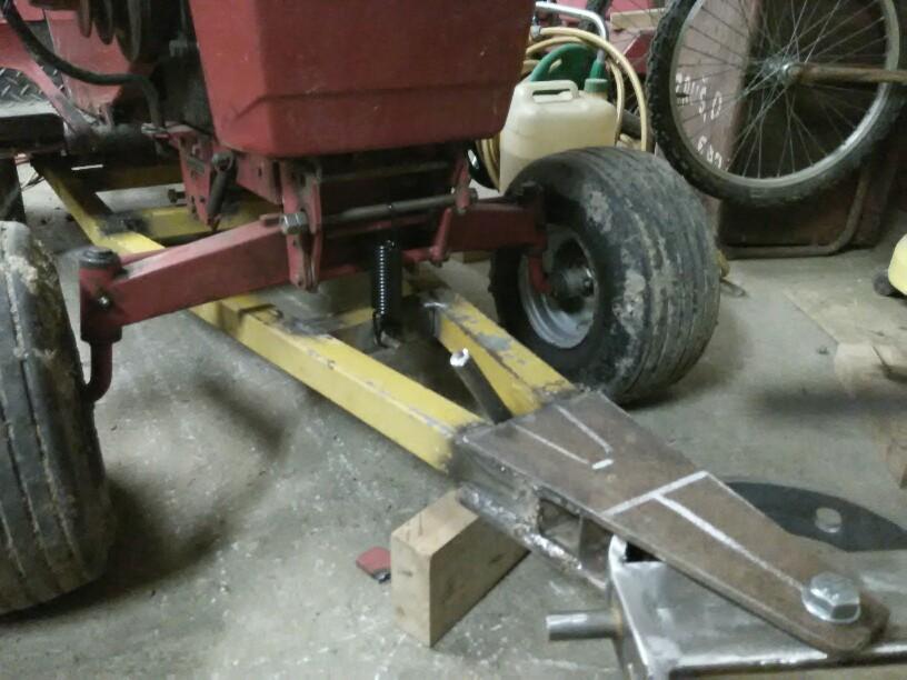

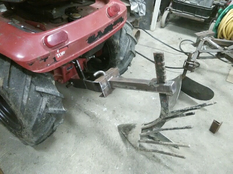

CZHorse 44 #41 Posted January 7, 2018 Long time since I last updated this thread...... Wrong time of the year to be doing this, hope to have it done by the end of the week.....😀 2 Share this post Link to post Share on other sites

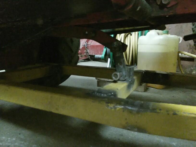

CZHorse 44 #42 Posted January 10, 2018 A little more progress.... 1 Share this post Link to post Share on other sites
CZHorse 44 #43 Posted January 11, 2018 (edited) More progress, just the trip springs and I'm done for this season!! I may add an angle lever at some point.... I have added a basic assist spring as the plough blade is made from 7mm plate and weighs plenty!! The frame is maybe a little long, so may shorten it if I feel the need! Edited January 11, 2018 by CZHorse 2 2 Share this post Link to post Share on other sites

CZHorse 44 #46 Posted January 12, 2018 Having had a look at pictures of the original wheelhorse plough mounted to tractors, I realize that the frame is really too long. I guess this will tend to push the front of the tractor sideways when I have the blade angled. Does anyone have any experience with this? Thanks. 1 Share this post Link to post Share on other sites
CZHorse 44 #47 Posted January 15, 2018 OK, so I also have a question regarding trip springs. I am guessing that the original ones are pretty heavy duty and I presume that they also stop the blade tipping backwards. I guess when moving gravel or heavy soil they have a tendency to trip?? Can anyone with some experience with the original blade give me some details? Share this post Link to post Share on other sites
meadowfield 2,808 #48 Posted January 16, 2018 21 hours ago, CZHorse said: OK, so I also have a question regarding trip springs. I am guessing that the original ones are pretty heavy duty and I presume that they also stop the blade tipping backwards. I guess when moving gravel or heavy soil they have a tendency to trip?? Can anyone with some experience with the original blade give me some details? they are so heavy duty there is nothing other than raised ironworks that trip mine. I think the odd tree root might have tripped it too. 2 Share this post Link to post Share on other sites
CZHorse 44 #49 Posted January 16, 2018 4 hours ago, meadowfield said: they are so heavy duty there is nothing other than raised ironworks that trip mine. I think the odd tree root might have tripped it too. I have put on a second pair of springs and it is much much better...... Just started snowing too!!😀 Share this post Link to post Share on other sites
CZHorse 44 #50 Posted January 17, 2018 On 1/16/2018 at 2:40 PM, meadowfield said: they are so heavy duty there is nothing other than raised ironworks that trip mine. I think the odd tree root might have tripped it too. Of course it very much depends on the distance between the pivot and where the springs are fixed. This influences the overall travel from eye to eye..... Share this post Link to post Share on other sites
