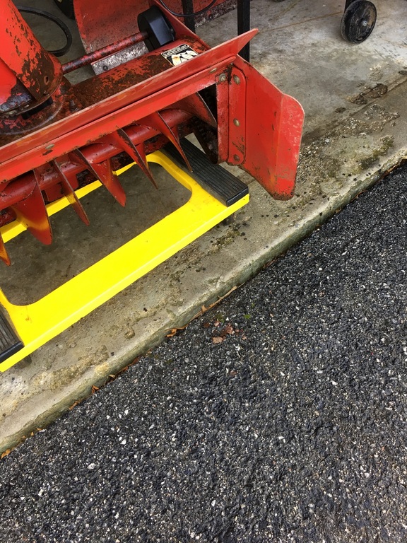

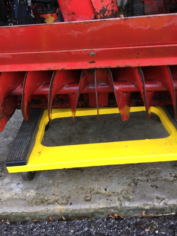

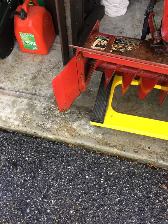

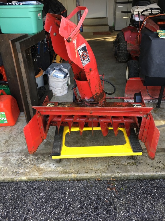

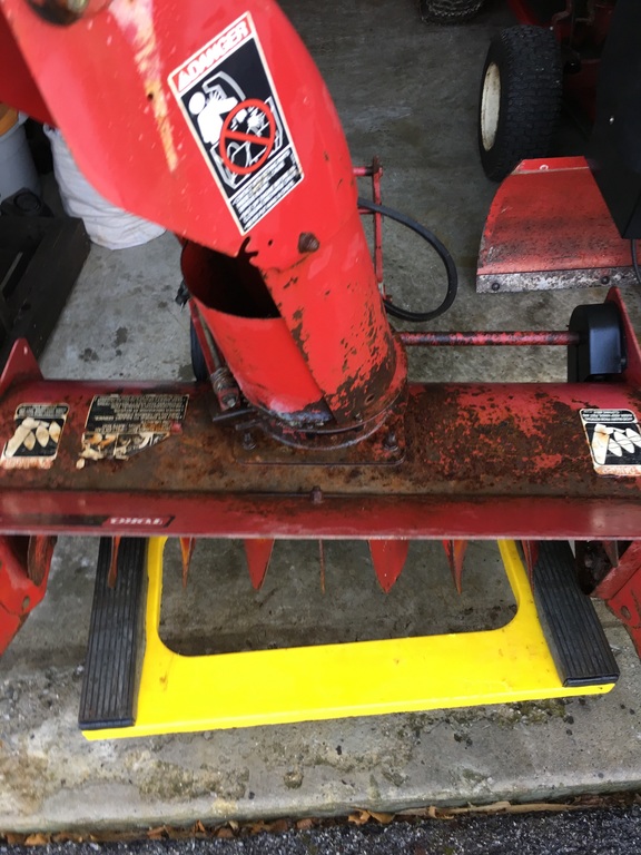

Sodaking27 1,057 #1 Posted February 11, 2017 (edited) Picked up a tall chute today. It's going to need some TLC to get it looking better. Price was reasonable. Going to go completely over it in the summer so it's ready for next winter. Time to start studying all the snow blower threads on the site. Model is 79-360. Auger doesn't look to bad. Side panels are on wrong and bent inward. Edited February 11, 2017 by sodaking27 6 Share this post Link to post Share on other sites
Ed Kennell 43,168 #2 Posted February 11, 2017 It appears the bolting flange for the side wing extensions have been bent in straight with the sides of the blower. They should be angled out and the extensions are reversed. 4 Share this post Link to post Share on other sites
roadapples 6,985 #3 Posted February 12, 2017 Right about the wings Ed ... Share this post Link to post Share on other sites
Sodaking27 1,057 #4 Posted February 12, 2017 Any good suggestions on how to get the flanges bent back to the correct angle? Share this post Link to post Share on other sites
roadapples 6,985 #5 Posted February 12, 2017 Large adjustable wrench.. a little at a time... 2 Share this post Link to post Share on other sites
woodchuckfarmer 333 #6 Posted February 12, 2017 Like roadapples said a little at a time 3 Share this post Link to post Share on other sites

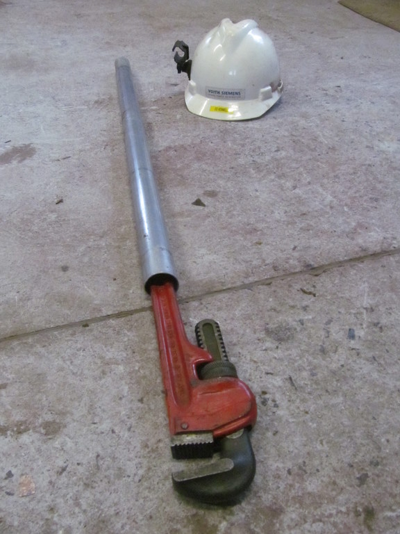

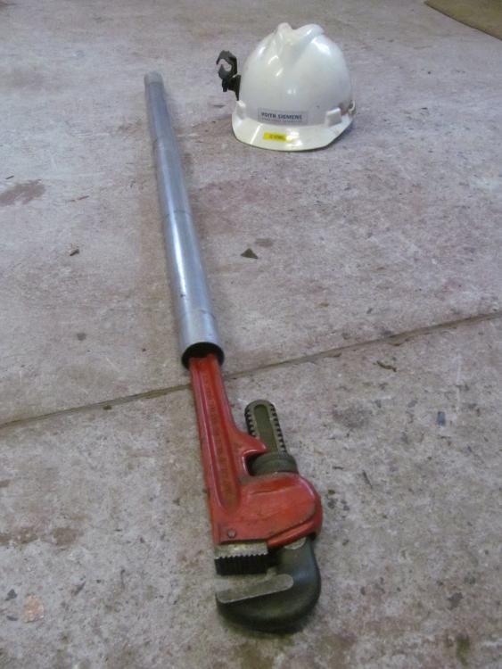

Ed Kennell 43,168 #7 Posted February 12, 2017 (edited) Use the bend on the front of the wing as a template. That angle should be the same as the flange angle. It may help to clamp a backer bar on each side of the flange to get a complete straight bend. I have also used a 24" pipe wrench with a 6' pipe handle extension to make some bends. The challenge is to securely clamp the stationary part to a solid immovable object. I have used the 6X6 post in my pole barn for many of these bends. Of course, if you have an acetylene torch, no problem. Just don't cook the bearings. Edited February 12, 2017 by Ed Kennell 2 Share this post Link to post Share on other sites

857 horse 2,588 #11 Posted February 13, 2017 (edited) We;ll,,you saw it here first folks,,,, when yeah wanna crack a few eggs you drop the hammer. and pick up a pipe wrench accuracy or your money back !!!!!! and Ed don't hollar "FOUR" be for he swings.....!!!!! Edited February 13, 2017 by 857 horse 2 Share this post Link to post Share on other sites
