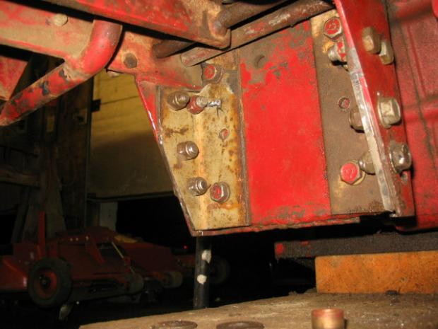

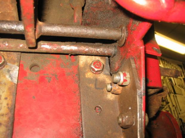

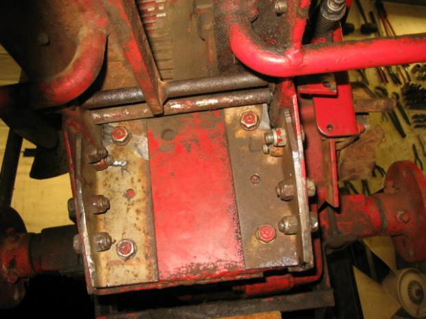

daveoman1966 3,884 #9 Posted February 11, 2017 I ahd the same issue a few years back... used 2 pieces of 1/4" x 2 angle iron...no welding required. ps...welding may close the cracks but I think you'll find it also makes the metal brittle and subject to cracking again. With these two corner brackets / braces it should last forever. As soneone else noted, you'll need new bolts to the trans...about 1/4" longer than original, but not too long. Use 3/8" dia bolts on the sides with nylok nuts. 11 Share this post Link to post Share on other sites
Adams94 1,071 #10 Posted February 11, 2017 I like that, looks very strong! Share this post Link to post Share on other sites
