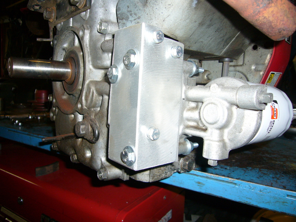

jhunsch 20 #1 Posted February 10, 2017 I had to relocate oil filter because it was in the way of the hood/grill on my Wheel horse 312-8The Kohler M12 K301 broke the rod, So i put a 20 Hp Honda engine in it and had to move the oil filter.Not only was the filter in the way of the grill, it was in the way of the mower deck drive belt.The Wheel horse clutch and drive pulley, and belt guides and belt shield all bolted up nicely to the Honda.I will add more picture later of the final project with the deck installed.Before & after pictureAll done on a drill press 2 x 2 x 4 inch long aluminum. 5 Share this post Link to post Share on other sites
