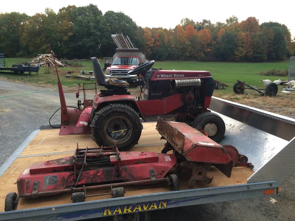

Jams 13 #1 Posted February 9, 2017 I just bought a 1988 Wheel Horse 520H . Came with a 60 inch deck, single stage blower and tiller and chains for $400 It runs and drives but 20 HP Onan surges and know it sat a while ( year) and needs carb cleaning, fuel change basic tune up. Its no show rig... I know NOTHING else about this rig and for that matter any garden tractor. I'm not too green around small engines and will figure it out but if there was some place to look and get started on anything that would be helpful, I would appreciate it. I don't even know how to install the deck...did I say I wasn't too green...:) I also wouldn't mind knowing , at best guess , if the deal was decent or not. I plan a "homeowner" rehab but more looking to just keep on using it as intended, for work. Thanks 9 Share this post Link to post Share on other sites

Adams94 1,069 #3 Posted February 9, 2017 Great deal i would say, but thats a 48" deck just saying, still stole it!. Share this post Link to post Share on other sites

bmsgaffer 2,069 #5 Posted February 9, 2017 But you will be so glad its a 48" when it comes time to swap it in and out. I think you are about 200lbs lighter with the 48 vs the 60. Your 88 wont run the 60" unless you swap in a swept front axle for it, but you likely wont need it. Nice find and great price! If you have a browse through the manuals section you can find all the manuals you could want. Garry will help out probably too. The surging will at the least require a very thorough carb cleaning. The onans are VERY picky about dirt. I put 2 fuel filters on mine, one larger micron filter back by the tank and a small micron between pump and the carb. After I spent two weeks getting my old one to stop surging I was not about to do that again! Oh, and no you are not too GREEN you are RED now! Welcome to the 'Square! (Although if you are mowing all that grass behind you there in the picture, you may want to look into the upgrade!) 3 Share this post Link to post Share on other sites
Jams 13 #6 Posted February 9, 2017 1 minute ago, bmsgaffer said: But you will be so glad its a 48" when it comes time to swap it in and out. I think you are about 200lbs lighter with the 48 vs the 60. Your 88 wont run the 60" unless you swap in a swept front axle for it, but you likely wont need it. Nice find and great price! If you have a browse through the manuals section you can find all the manuals you could want. Garry will help out probably too. The surging will at the least require a very thorough carb cleaning. The onans are VERY picky about dirt. I put 2 fuel filters on mine, one larger micron filter back by the tank and a small micron between pump and the carb. After I spent two weeks getting my old one to stop surging I was not about to do that again! Oh, and no you are not too GREEN you are RED now! Welcome to the 'Square! Thanks for the help and correction on the deck...told you I was new!! HA - I cant imagine hauling the 60 inch deck - this was heavy enough... I planned on taking some time cleaning it up. Read a bunch on carb cleaning...any thoughts on soaking vs spray on tactics like Seafoam? Thanks again - proud to be RED even if just a lighter shade! 1 Share this post Link to post Share on other sites
bmsgaffer 2,069 #7 Posted February 9, 2017 (edited) 37 minutes ago, Jams said: Thanks for the help and correction on the deck...told you I was new!! HA - I cant imagine hauling the 60 inch deck - this was heavy enough... I planned on taking some time cleaning it up. Read a bunch on carb cleaning...any thoughts on soaking vs spray on tactics like Seafoam? Thanks again - proud to be RED even if just a lighter shade! I had tried quite a bit of seafoam and it would just never do the trick. You have to disassemble the carb and manually clean all the spots you can, including the fuel orifices (tiny holes). Then I had to run it through a ultrasonic cleaner for quite a few rounds. (Cheapo harbor freight one, you can search it here) When you are running new fuel line, take time and block off the ends when you are routing the last portion between the fuel filter and carb, this will save you much headache and you wont have to learn the hard way like I did. While you have the top end disassembled for the carb cleaning, go ahead and adjust your valves while you are there and if you are really feeling ambitious get a couple new gaskets and decarbon the heads. It will saving having to do the process again later when these things need to be done. Also, pull the tins and clean up behind them. The 520's are notorious for gunking up the back cylinder, overheating and dropping a valve seat due to slightly less airflow from the belt guard being back there. Edited February 9, 2017 by bmsgaffer 3 Share this post Link to post Share on other sites
WHX?? 55,094 #8 Posted February 9, 2017 (edited) Sounds like Brandon has the basics covered. Get the models & serial numbers down and recorded for the attachments and you can search here in the files section for manuals. Just type the model in the search block upper right. the manuals will go thru step by step on how to attach implements. Also get the IPL's (illustrated parts list) and it will tell you what might be missing. Many times brackets & springs will not make it along for the ride on a new to me tractor. There is a nine pin connector from the engine wiring that you will want to inspect as well as the fuse block. Issues have been know to happen in those areas on machines not particularly well cared for and even some that are. Did someone already mention change all fluids? If not I am now.... some of us run syn 10w30 in both the engine and hydro. Let us know if you need the correct/best filters to use. BTW Edited February 9, 2017 by WHX9 speeling 1 Share this post Link to post Share on other sites
Ed Kennell 44,952 #9 Posted February 9, 2017 Please, do everything Brandon and Jim mentioned above. I will just add a few items. 1. If it still surges after the carb cleaning, clean it again. I cleaned mine 3X before I got it. 2. While you have the tins off for cleaning, replace the gasket on the oil filter base plate. They are notorious for seeping and causing the grass to collect on the oily fins. 3. There is a rubber grommet to seal the oil filter to the tin. This improves the air flow across the rear cyl. 4. I believe venting the belt guard also increases the rear cyl. cooling. Share this post Link to post Share on other sites
