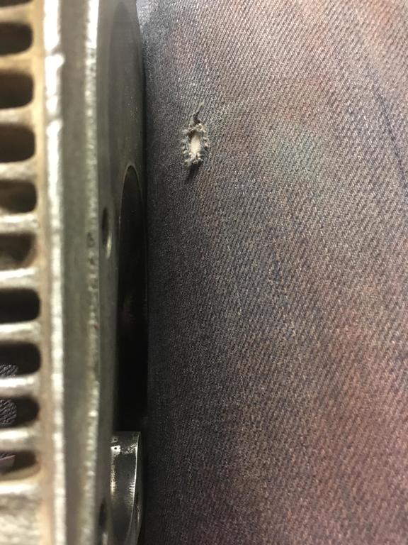

Ashton1118 20 #1 Posted February 9, 2017 I have a k161 head. Does anybody know how thick the lip is supposed to be on them? I don't know if the head has been milled down due to bad rings. Share this post Link to post Share on other sites
slammer302 2,157 #2 Posted February 9, 2017 That looks factory to me 1 Share this post Link to post Share on other sites
Shynon 7,728 #3 Posted February 9, 2017 5 minutes ago, slammer302 said: That looks factory to me Share this post Link to post Share on other sites
JC 1965 1,549 #4 Posted February 9, 2017 Yea , I agree, that looks like factory. I would find a good level surface ( a piece of glass works really good ) and a feeler gauge and check to see if it is warped. Share this post Link to post Share on other sites
