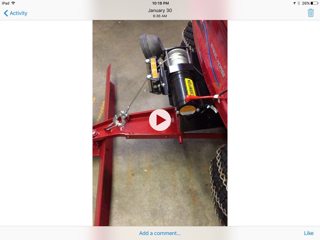

LRE 8 #22 Posted February 23, 2017 (edited) I used to have a 520H tractor and one of the attachments was the mid mount grader blade. I sold the tractor and upgraded to a 522xi and a blower on the front. Then I thought that I have this grader blade laying around so I thought I would modify it to work on the XI so I installed it on the back with a Tach a matic on the rear axle and mounted the winch above the blade. Granted I don't have the ability to lift the wheeels off the ground like I did with the 520 with downward pressure but i can scape the drive clean of residual snow or very lite snows and then blow it away. This project was just finished so the jury's still out if it was worth it but my investment is not very big at this point. Sorry the video won't play but you get the idea Edited February 23, 2017 by LRE 3 Share this post Link to post Share on other sites
