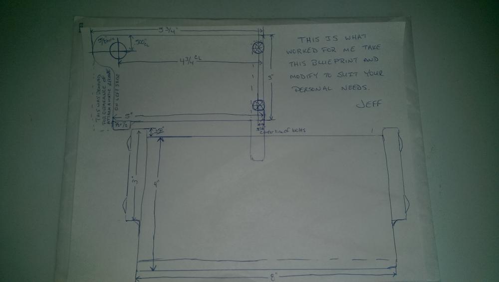

WVHillbilly520H 10,378 #35 Posted February 5, 2017 If you can find the square/retangular weights with 1/2"-5/8" holes for cable style weight machines would be a good candidate for cheap front weights that wouldn't hang low or interfere with hood opening or find my blue print for my suitcase weight hanger now that you have a welder and the front attac-a-matic uses 5/8" diameter rod, also an extra mower mower mule drive can be converted into a weight bracket,Jeff. 2 Share this post Link to post Share on other sites
Duramax7man7 506 #36 Posted February 5, 2017 (edited) Yeah I saw that a couple of months ago in another thread. I think is was my rear ballast thread. I like the look of it! I will definitely look for those rectangular weights for sure. I found another tiller last night and the guy responded today and said "Sorry it's GONE!" but he may be getting another one this week... Man these things are highly desired I guessed. Learned my lesson on asking questions about these... lol Edited February 5, 2017 by Mastiffman 1 Share this post Link to post Share on other sites
