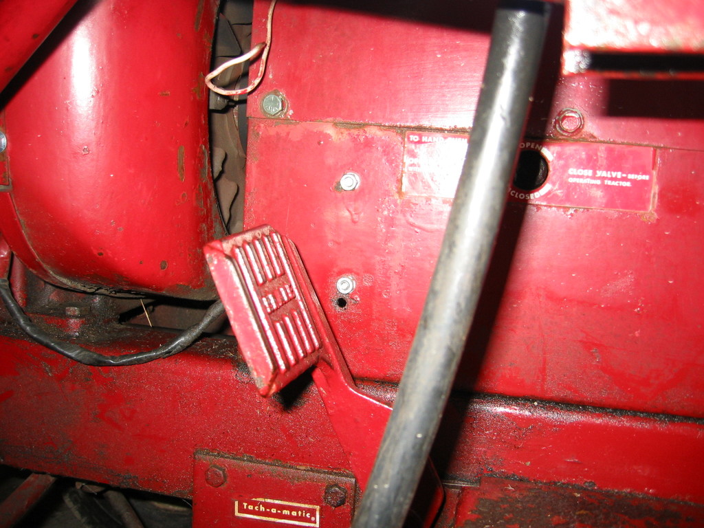

"D"- Man 827 #7 Posted February 4, 2017 (edited) I have a D-200 in my drive that I took some pics of this morning. I removed the side covers to get some straight on views, hope this helps, Mark. You can click on images to enlarge. Edited February 4, 2017 by "D"- Man Share this post Link to post Share on other sites

Ken Burton 3 #12 Posted February 11, 2017 On the side of the hydraulic pump there's a screw to put her in neutral so I can move it. I would like to know if she has to be running before it will go into neutral so I can move it to the insulated part of the shop. If you gentlemen know any other way to get the old girl to move I would appreciate it. Ken Share this post Link to post Share on other sites
pfrederi 18,970 #13 Posted February 11, 2017 Does not have to be running. Turn the valve counter clockwise a full turn. Make sure the parking brake is off and you can push her...it isn't an easy push she is heavy Share this post Link to post Share on other sites

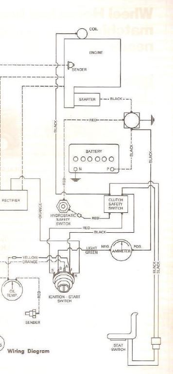

Ken Burton 3 #15 Posted February 24, 2017 Hello Gentlemen. I thought let you know where am I. I change the points and condenser check the coil for spark still have none. Think it has something to do with the wiring. If anyone has a Laymans diagram of the wiring it would be greatly appreciated. I'll try to find the diagram in the manual. But I am far from electrician. Thanks Ken Share this post Link to post Share on other sites
pfrederi 18,970 #16 Posted February 24, 2017 (edited) With the key on do you have 12v at the small + terminal on the coil? If not try running a jumper wire from the battery + to the coil and crank should have spark. (Do not leave the jumper in place for a long time..) If you get spark with the jumper none without it work your way back along the black wire. Towards the ignition switch Edited February 24, 2017 by pfrederi Share this post Link to post Share on other sites
Ken Burton 3 #17 Posted February 27, 2017 Thanks Pfrederi, I got her running I needed that wire diagram that you send me thanks for your support. It was the amp gauge that was bad and two wires that were wrong. The next challenge is to see if she will go forward and reverse I found out the rear end was changed before I got her. I had a mechanic look inside the pump he change a few gasket and said it was good. but so far everything that was done before I got her was mess-up. Thanks Again for your help...Ken If it will not got forward do you have any ideas of why 1 Share this post Link to post Share on other sites
