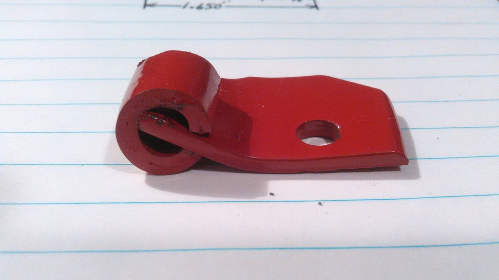

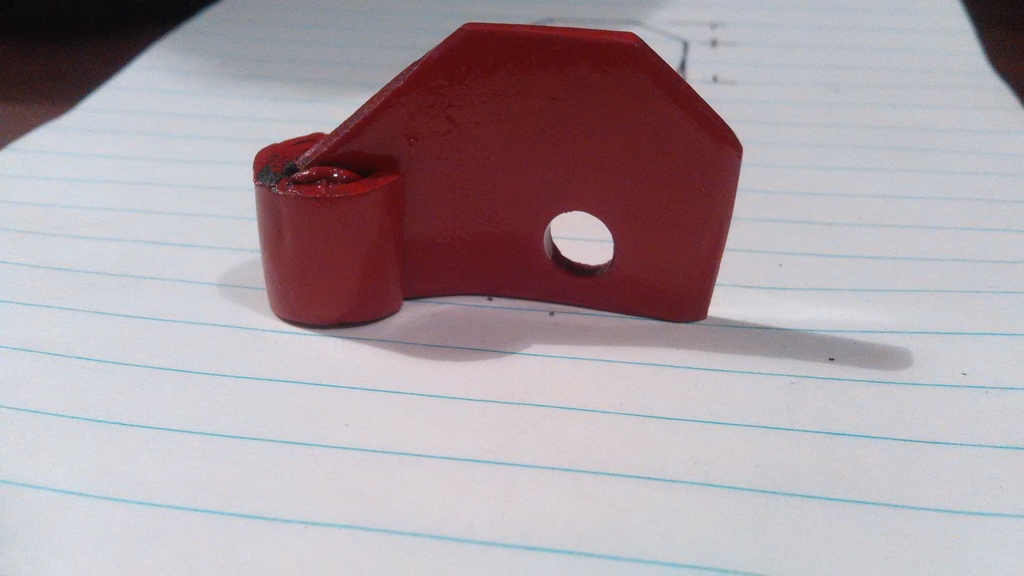

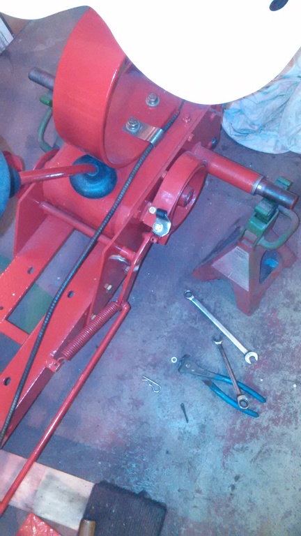

hermitman 116 #1 Posted January 31, 2017 I haven't seen this so someone let me know if its been done before please. I removed lower brake band bolt and fabbed a small plate that swings up or down. Depress brake and swing it down, brake is locked. Swing it up when ready to go. 7 Share this post Link to post Share on other sites
Aldon 4,832 #2 Posted January 31, 2017 Nice ingenuity. Any chance of getting a pic from the side angle? 1 Share this post Link to post Share on other sites

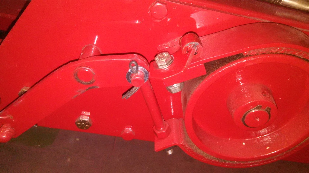

hermitman 116 #3 Posted January 31, 2017 Had to wait for paint to dry ! Here it is installed. Have trouble with close ups. I shake a bit. Good for doing points bad for pics!!! 5 Share this post Link to post Share on other sites
Aldon 4,832 #4 Posted January 31, 2017 (edited) Very nice! I am not very familiar with this set up but how easy is that to access once fenders etc are installed? Edited January 31, 2017 by Aldon 2 Share this post Link to post Share on other sites
hermitman 116 #5 Posted January 31, 2017 this is an old suburban and even with fenders installed ( they're very small ) you can easily reach down with left hand and swivel it around. 1 Share this post Link to post Share on other sites
