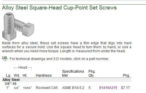

Jakeshorsetuff 36 #8 Posted January 31, 2017 It is not a dog point set screw it is just a square head set screw and where would i get a dog point set screw. The axle moves about 3mm out and in when I pull on it it is the same on the other side but the other side does not leak. Share this post Link to post Share on other sites
pfrederi 19,940 #9 Posted January 31, 2017 (edited) Used to be something called hardware stores that would have these things. Too bad most of them are gone. You might get lucky at a big box store. This is what you want Edited January 31, 2017 by pfrederi 3 Share this post Link to post Share on other sites
