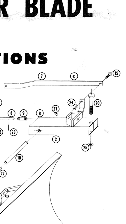

Chris G 3,385 #1 Posted January 29, 2017 I was wondering if I can get some help? I need the measurements on a couple things. One the length of part#2 front channel. Second the measurement from the center of pivot point to the lift arm on front channel. Third the height of lift arm. Thanks for all help! Share this post Link to post Share on other sites
clueless 3,437 #2 Posted January 29, 2017 So you want the measurement from the front of #2 to the center of the hole that the pin #10 goes in? Also the height (length) of #7? Or do you want measurement from the hole that #10 goes in to the hole that # 7 bolts to? Chris Share this post Link to post Share on other sites
Chris G 3,385 #3 Posted January 29, 2017 The length of front to back on part #2. And the length from center of hole on part #2 for #10 to the center of bracket were bolt #15 goes through. Share this post Link to post Share on other sites
clueless 3,437 #4 Posted January 29, 2017 Length of #7 (lift arm) 22.75", Length of #2 (front channel) 14", Length between center of pivot hole to center of #15 bolt hole 6.5" +/- 1/8th. the lift arm has has a couple of bends (dog leg) close to where it mounts to the lift handle, also has oblong holes about 3/4" in both ends. 2 Share this post Link to post Share on other sites

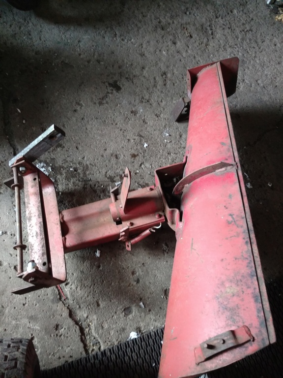

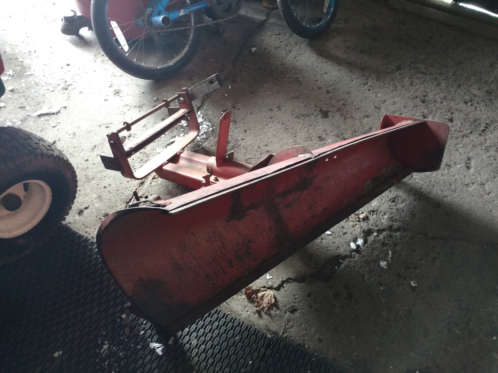

Chris G 3,385 #5 Posted January 29, 2017 Thanks! I need them to make some mods to a blade. I'll post some pics shortly Share this post Link to post Share on other sites
Chris G 3,385 #6 Posted January 29, 2017 I'm adapting this blade to one of my suburbans. There's a little lock ya undo and the blade flips to throw snow opposite way. So has scraper blade on both sides. I'll make another post when I get it all done. Share this post Link to post Share on other sites
