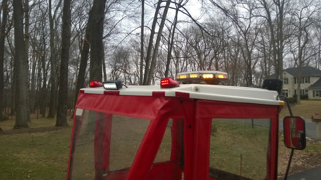

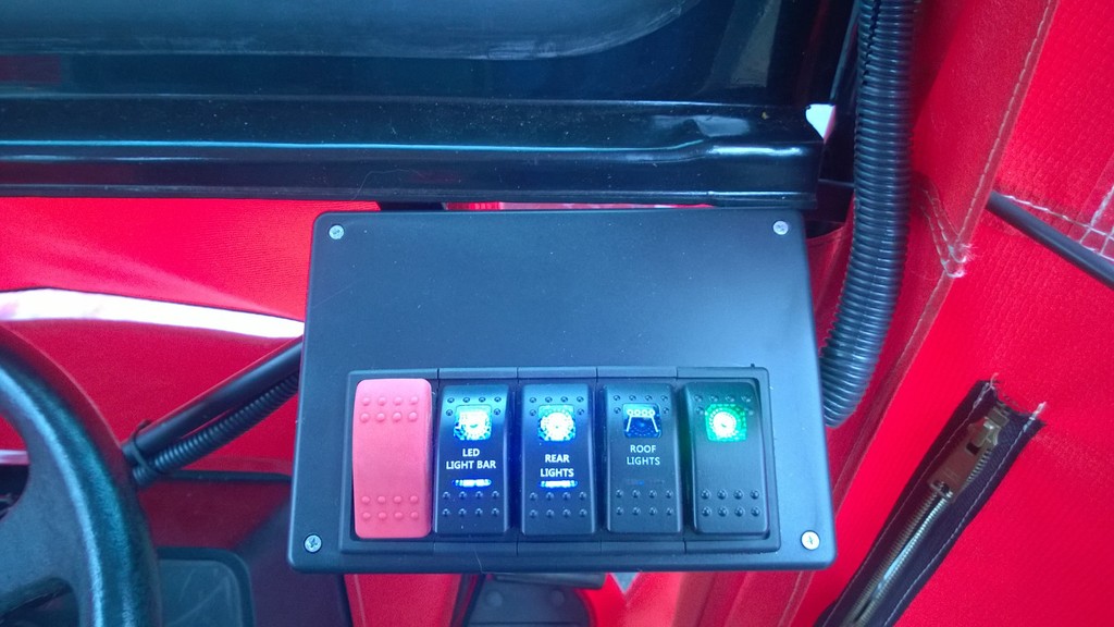

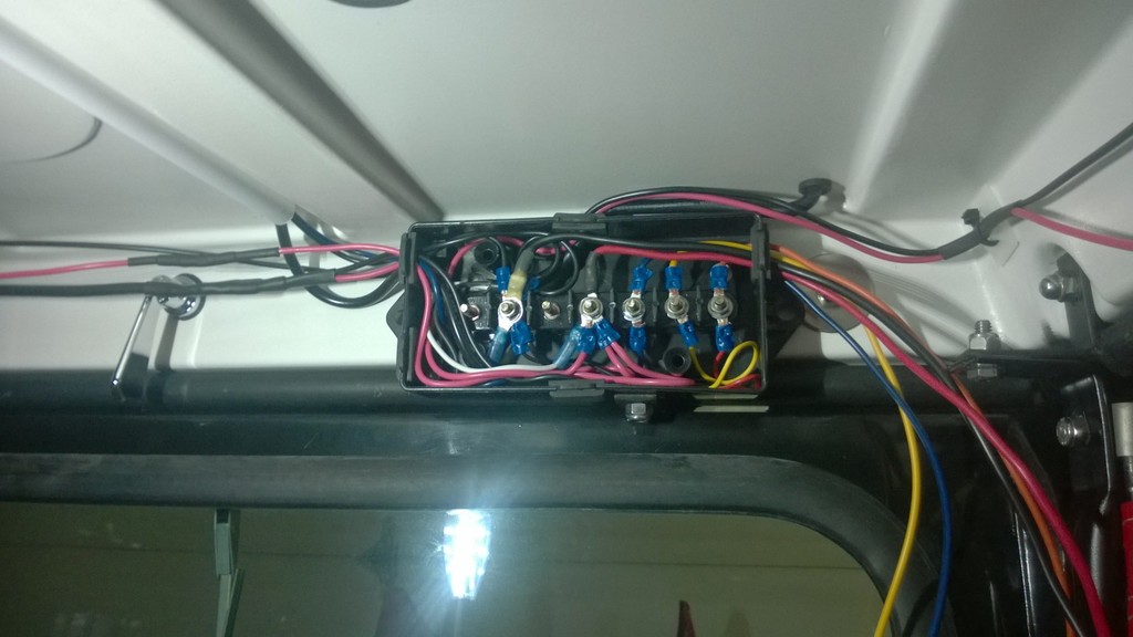

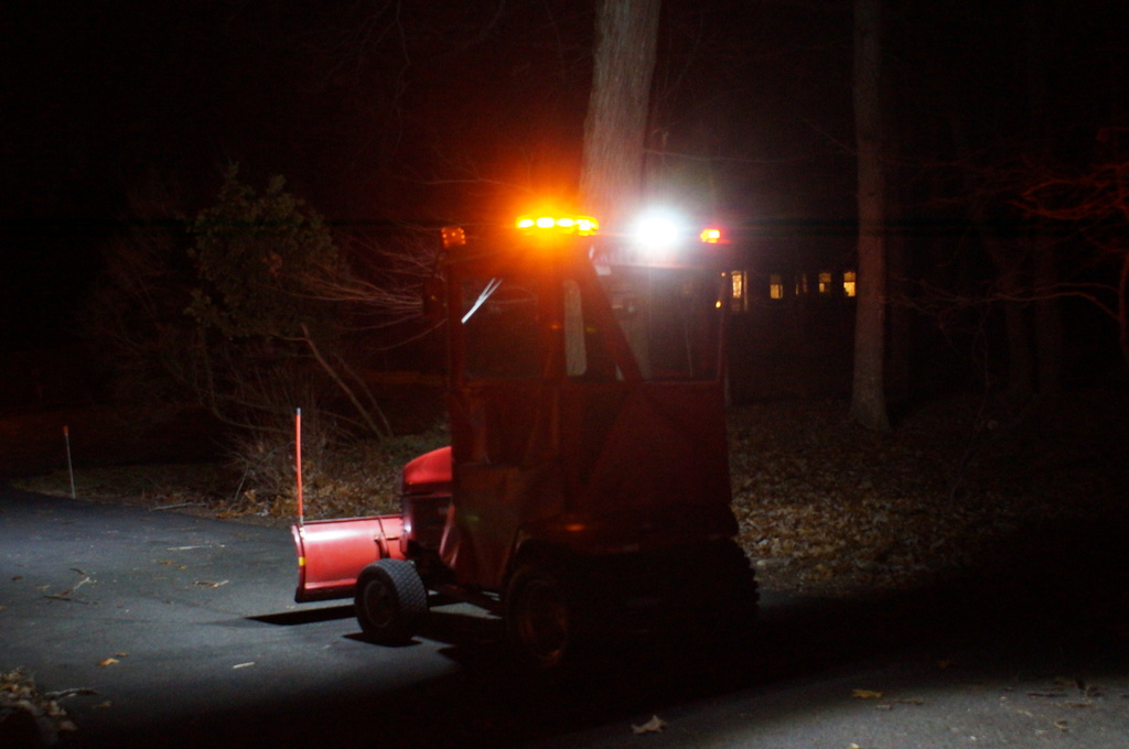

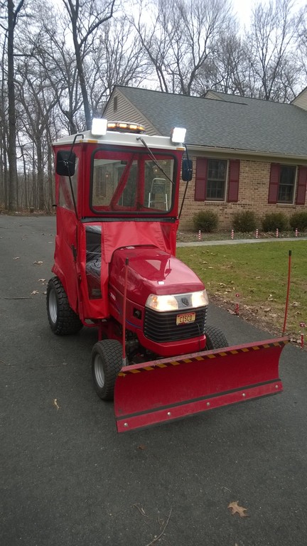

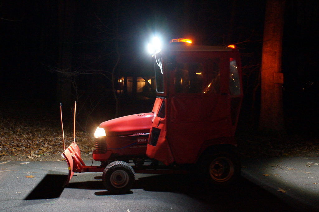

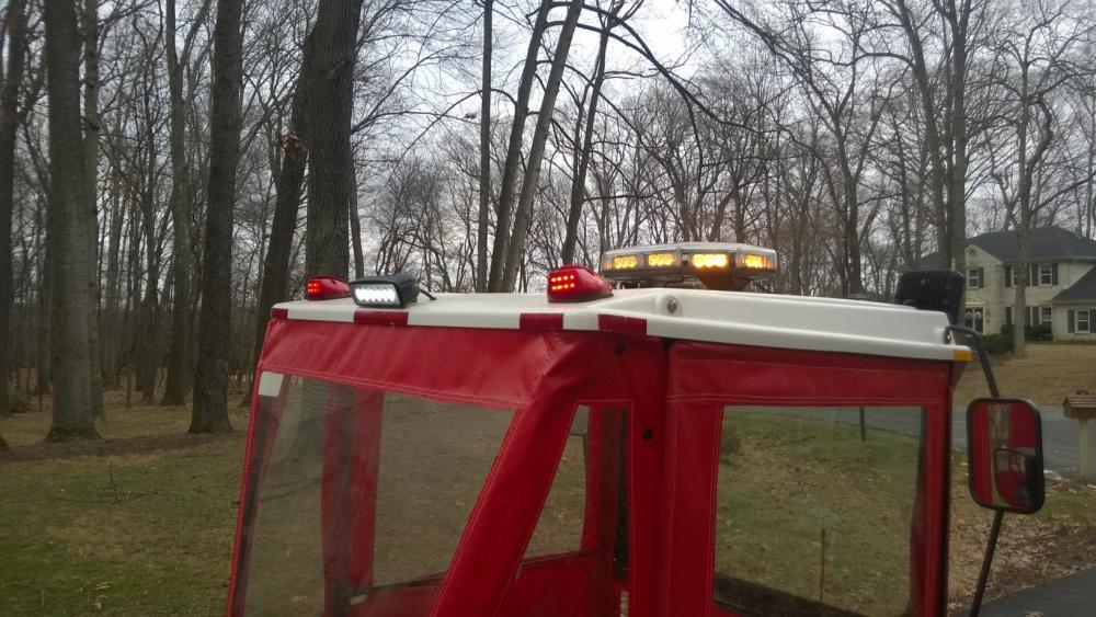

shallowwatersailor 3,214 #1 Posted January 29, 2017 (edited) Last year I never setup my 523Dxi with it's snowthrower and cab because of the lack of snow - and then on January 23, 2016 we were socked in for five days with close to 40" of snow from a blizzard. I never used that tractor! With this turning into another "Winter That Wasn't," I have been refining the installation of my "new/used" cab for the 518xi and the lighting controls compared to the cab on the 523Dxi. Two years ago on my 523Dxi, I had put 27W LED floods on the front and an 18W LED flood on the rear. I had also motorized the chute deflector on the single stage snowthrower. The wiper was manual. This year I have used the cab roof from the 523Dxi's cab for the 518xi. The reason is I have a motorized wiper and it is just easier to start fresh with the other roof. It will again get 27W floods on the front and an 18W flood on the rear. It will also receive copies of the new items I have mounted on the 518xi. The 518xi has received roof mounted taillights, and an amber LED lightbar. The tailights give me piece of mind due to the 518xi not having tailights like the other four 5xi models. Maybe this summer I will pull the seat pan off and finally add them! There is a master fuse at the battery and individual fuses inside the control box. All wire to wire connections were soldered and heat shrunk. I also used a trailer junction box, mounted at the roof, to make removal at the end of the season easier. For the wiring I used 12 gauge stranded to the control box. There is a Weatherpack connector at the firewall. I used 14 gauge stranded to the lights with one 12 gauge ground to the junction box to lessen the number of wires in the loom to the roof. This way all the wiring and boxes can be stored with the roof piece of the cab. Space was left on the face of the box for motion controls of the snowthrower and snow blade. My plan is to have common controls and connections for the attachments to each tractor. That way I can swap duties between tractors. Latest weather says snow next Sunday/Monday!!! Notice the fuse block cover from Glen Pettit. The red switch is a momentary switch for changing the amber lightbar pattern. Edited January 29, 2017 by shallowwatersailor 16 Share this post Link to post Share on other sites
