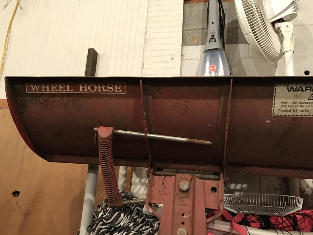

HeyMrP 83 #1 Posted January 28, 2017 (edited) Hi all. Someone about an hour from me is selling this blade. I have messaged him and he says it's missing the bolts. Next I will try to get any model info from him... I assume these blades have model numbers I can check for compatibility with my 310. $30 bucks does not seem like a bad deal. Any tips about what I should check for? Any geniuses here who can identify this by its crummy picture? Edited January 28, 2017 by HeyMrP Removed cl link and added pic Share this post Link to post Share on other sites

stevasaurus 23,466 #8 Posted January 28, 2017 That blade is for the long frame horses. It will fit your 310. You can tell because the blade frame bends to be parallel toward the back end (top in your picture). The short frame blades have the "A" frame. 2 Share this post Link to post Share on other sites

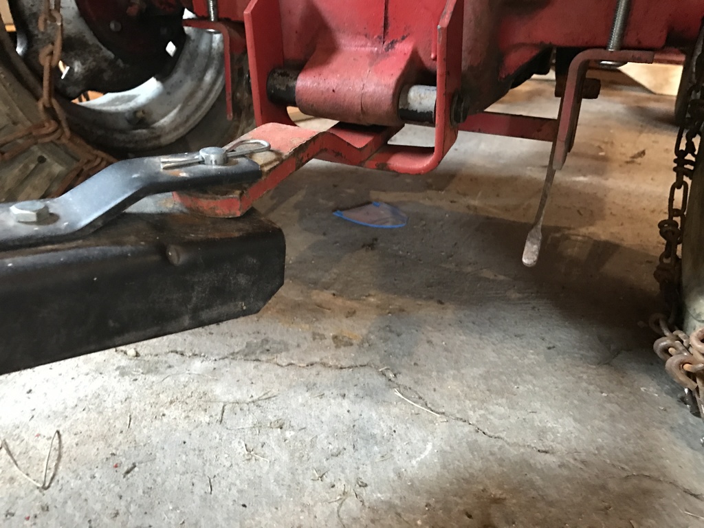

DennisThornton 4,771 #12 Posted January 29, 2017 Great buy but I noticed before it was missing a spring. You will also need a rear axle hitch. How wide is the blade? 1 Share this post Link to post Share on other sites

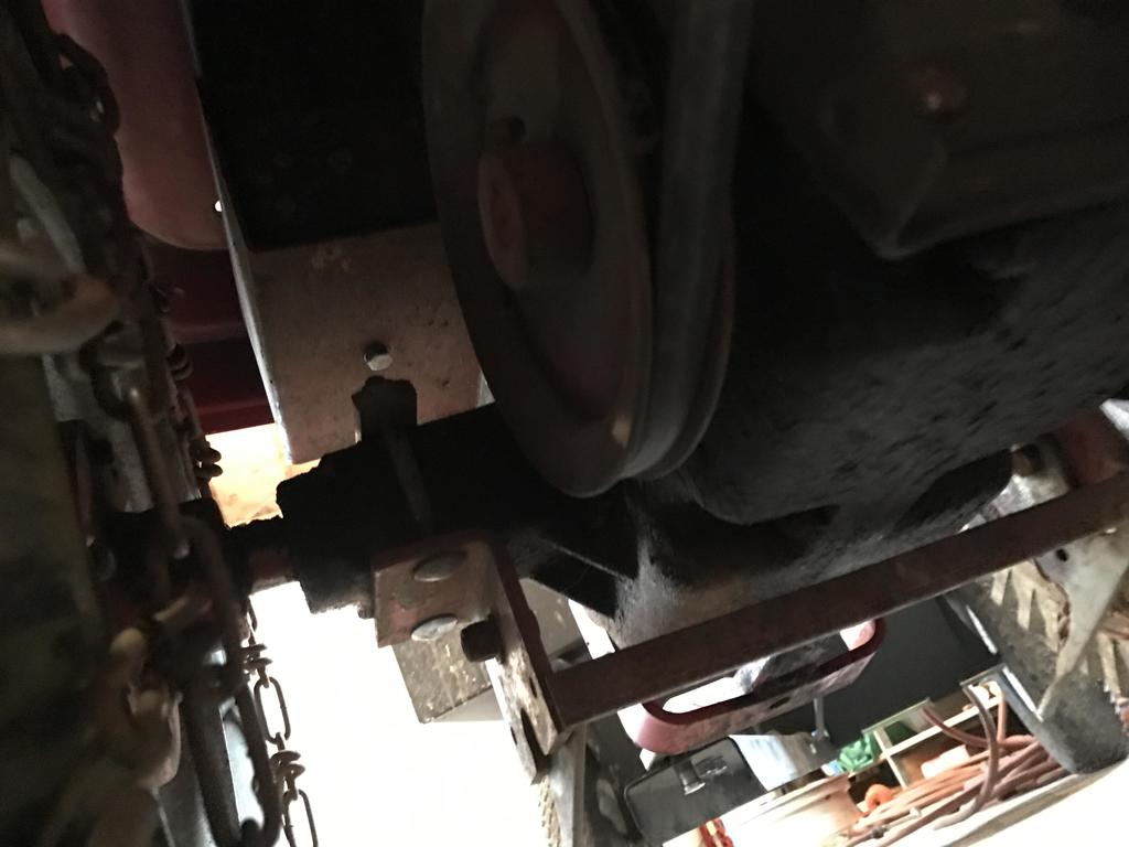

HeyMrP 83 #13 Posted January 29, 2017 9 hours ago, DennisThornton said: Great buy but I noticed before it was missing a spring. You will also need a rear axle hitch. How wide is the blade? Springs I understand. Rear axle hitch? Waz that? Is there one possibly on my 310 already? Quick search of the forums last night and I didn't see anything that enlightened me. I'll measure the blade after church. Share this post Link to post Share on other sites
SylvanLakeWH 29,389 #14 Posted January 29, 2017 9 minutes ago, HeyMrP said: Springs I understand. Rear axle hitch? Waz that? Is there one possibly on my 310 already? Quick search of the forums last night and I didn't see anything that enlightened me. I'll measure the blade after church. It bolts onto the rear axle and has two silver quick connect levers that attach to the rear bar of the blade frame. Take a pic of your axle and post it. Can tell you in 2 seconds if you have what you need...looks like this: 2 Share this post Link to post Share on other sites
HeyMrP 83 #15 Posted January 29, 2017 Oh goodie. My 310 has the hitch. I assume the lever that raises my snowblower will also raise the plow blade (and the mower deck too.) I saw in another pic that there appeared to be another lever for adjusting the angle of the blade. Is that correct? Share this post Link to post Share on other sites

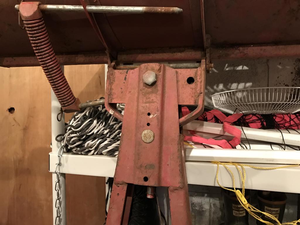

SylvanLakeWH 29,389 #16 Posted January 30, 2017 Yes - The lever that raises the deck will also raise the blade - attaches mid-frame. Also apparently missing is the other lever that 1) moves the blade side to side and 2) holds the cable handle that releases the lock so the blade can move side to side. Although your first post appears to show the cable? Do a search for photos and you can see where it fits. The rod connector goes in the large hole right of the big center nut you can see in the picture in your post No. 11. I do not have the lever and its no big deal. Just gotta plan my route and Get off to switch blade directions... 1 Share this post Link to post Share on other sites

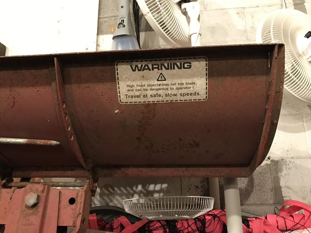

HeyMrP 83 #17 Posted January 30, 2017 Ok. After the explanations, looking at it more, and google finding the above pic I think I understand. The lever on the drivers left will raise the plow. The lever on the drivers right (shown here mounted directly to the plow frame) will pivot the blade (even though the pictured plow does not have the rod that connects the pivot lever to the hole by the main pivot bolt.) The squeeze handle on the pivot lever disengages the lock pin the keeps the blade from pivoting. To make mine complete I need... 1. The rod that is at the far end of the frame (away from the plow) that catches in the rear axle hitch. 2. The pivot lever. 3. The pivot rod/actuator. 4. Another spring. Does all that sound about right? 1 Share this post Link to post Share on other sites

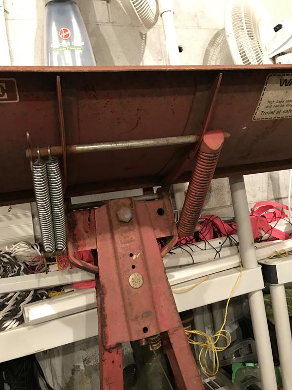

HeyMrP 83 #21 Posted February 2, 2017 Temporary git er done. I'll eventually find parts or a donor blade. 1 Share this post Link to post Share on other sites
SylvanLakeWH 29,389 #22 Posted February 2, 2017 That works!...a little rust on them "new" springs and temporary can become permanent! Good thinking! 1 Share this post Link to post Share on other sites
HeyMrP 83 #23 Posted February 3, 2017 One step closer. Share this post Link to post Share on other sites
