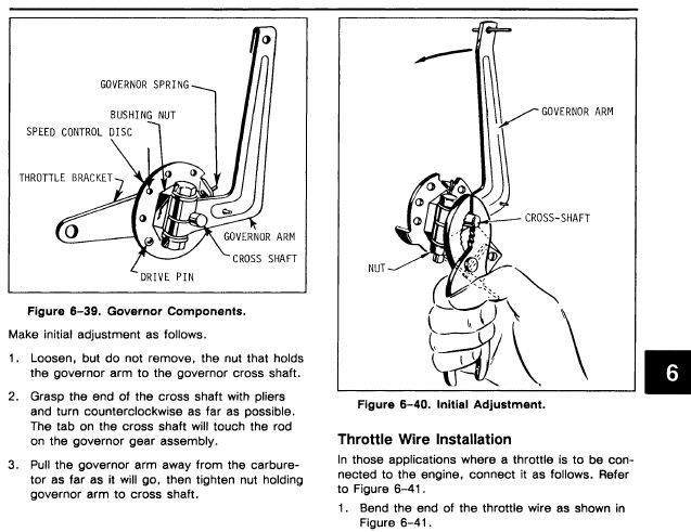

pfrederi 19,784 #2 Posted January 26, 2017 Does the engine governor seem to work OK when you load the engine (other than PTO...like going up a hill or hauling a load.) Does the hub of the PTO get hot after it runs for a few minutes?? 1 Share this post Link to post Share on other sites
redhead 10 #3 Posted January 26, 2017 governor seems to work ok have not tried going up hill or hauling load weather has not been good also i just got this tractor a few weeks ago will try to get it out and climb a hill and see what happens Thanks for your imput and i will let you know what i find out Share this post Link to post Share on other sites
pfrederi 19,784 #4 Posted January 26, 2017 Another question...does the engine slow a lot when you engage the PTO initially??? 1 Share this post Link to post Share on other sites
