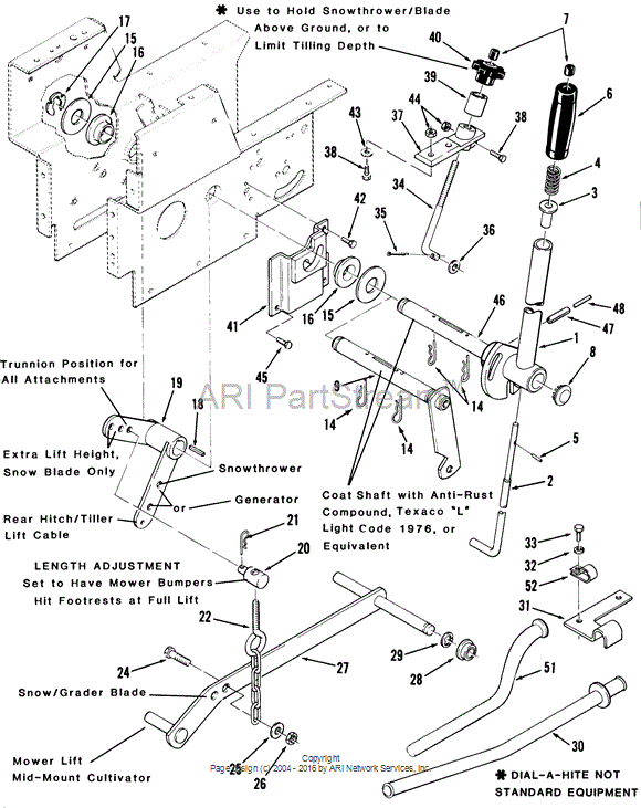

daveoman1966 3,882 #3 Posted January 25, 2017 (edited) This is the lift apparatus for the gt-1100. What items do you need? Edited January 25, 2017 by daveoman1966 3 Share this post Link to post Share on other sites

JeanUKWildcat 15 #8 Posted January 26, 2017 Thank you all for the warm welcome. 20 hours ago, daveoman1966 said: This is the lift apparatus for the gt-1100. What items do you need? The handle part cause my button doesnt seem to be working well. I thought maybe the spring is rusted but I sprayed it and still nothing. So im not sure if its something with the spring or what. Share this post Link to post Share on other sites
wallfish 19,303 #9 Posted January 26, 2017 5 hours ago, JeanUKWildcat said: The handle part cause my button doesnt seem to be working well. I thought maybe the spring is rusted but I sprayed it and still nothing. So im not sure if its something with the spring or what. Remove the rubber handle and the spring is right there. Have a look see at it and go from there. If the handle is bent, that will cause sticking issues too. 1 Share this post Link to post Share on other sites
JeanUKWildcat 15 #10 Posted January 27, 2017 14 hours ago, wallfish said: Remove the rubber handle and the spring is right there. Have a look see at it and go from there. If the handle is bent, that will cause sticking issues too. Thanks for that information. Ill try that before I order one. Share this post Link to post Share on other sites

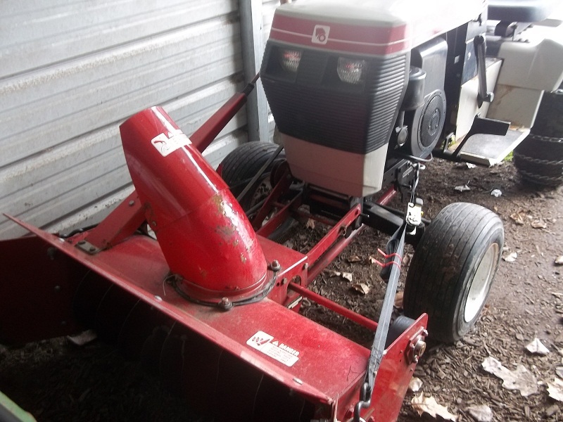

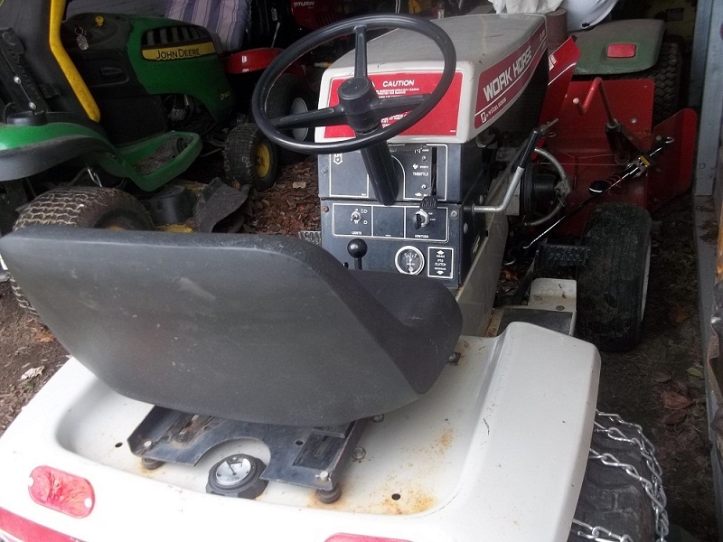

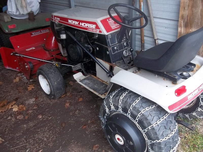

JeanUKWildcat 15 #12 Posted January 29, 2017 (edited) For those who wanted to see it. I do have the Mowing Deck for it as well. Edited January 29, 2017 by JeanUKWildcat 2 Share this post Link to post Share on other sites
