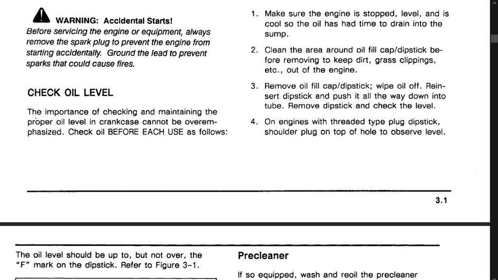

PetesPonies1 119 #9 Posted December 2, 2021 On 1/22/2017 at 8:44 PM, gregg'shorses said: Als Also to check oil don't screw it in. Just rest it in the hole . Clean area around first of course That's not what the owners manual says. It says to insert the dipstick as far as it will go. That would seem to include screwing it in to get the most depth. Share this post Link to post Share on other sites

pfrederi 19,881 #13 Posted December 2, 2021 To be sure threaded plug dipsticks are checked NOT screwed in 1 Share this post Link to post Share on other sites
Jeff-C175 7,207 #14 Posted December 2, 2021 (edited) I've got at least one machine, my walk behind snow thrower, but it has a Briggs motor, that says to screw the dipstick in to check the level, and it's printed right on the dipstick! I guess it depends on the manufacturer... Edited December 2, 2021 by Jeff-C175 2 Share this post Link to post Share on other sites

PetesPonies1 119 #17 Posted December 2, 2021 18 minutes ago, Jeff-C175 said: I've got at least one machine, my walk behind snow thrower, but it has a Briggs motor, that says to screw the dipstick in to check the level, and it's printed right on the dipstick! I guess it depends on the manufacturer... It's a Kohler I'm posted about. Says dipstick "into filler opening as far as it will go" Share this post Link to post Share on other sites

pfrederi 19,881 #21 Posted December 2, 2021 18 minutes ago, PetesPonies1 said: So what? You like inaccurate information SAVED FOR POSTERITY? Makes no sense. get accurate information posted for others to read. No i want accurate info. if it is tube type dipstick push it all the way in. If it is a screw in plug type is sits on the block. 1 1 1 Share this post Link to post Share on other sites
PetesPonies1 119 #22 Posted December 2, 2021 3 hours ago, pfrederi said: No i want accurate info. if it is tube type dipstick push it all the way in. If it is a screw in plug type is sits on the block. OK. I'll take a pic of what I have in the literature. Share this post Link to post Share on other sites
