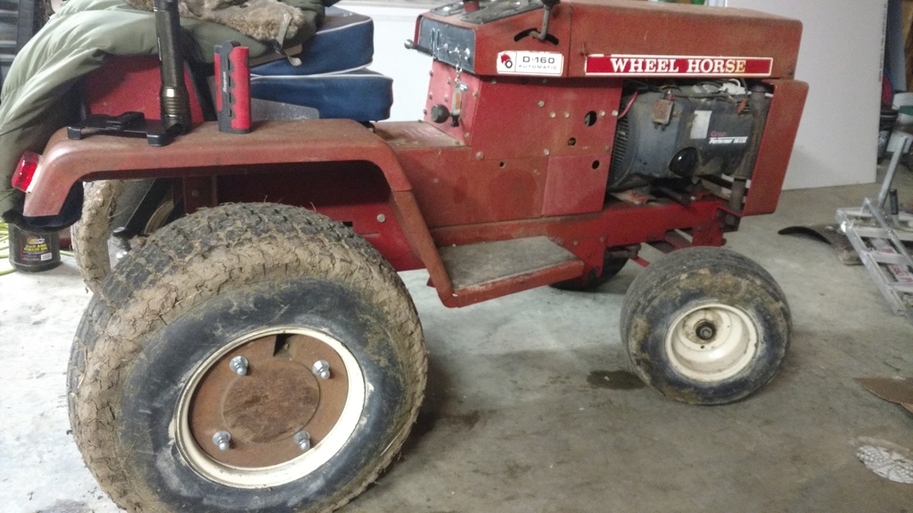

meby 27 #1 Posted January 20, 2017 Finally got my weights on the tractor. I've had them sitting around since last spring and we turned them down to fit earlier this winter. Cast iron in a lathe makes such a mess! The mounting holes were right, but the diameter was to big. Originally they weighed 62 lbs each. We wound up at 46 lbs x4 for 184 lbs total. I also put chains on it to plow with... what a difference. Later this year I'd like to get some Carlisle Tru powers on it and load the tires. 4 Share this post Link to post Share on other sites
KC9KAS 4,745 #2 Posted January 20, 2017 @meby I bet that weight really helps! Am I looking at 2 weights on this rear wheel? Nice that they don't stick out to far. Share this post Link to post Share on other sites
meby 27 #3 Posted January 20, 2017 Two weights per side. yeh, not a fan of weights sticking past the wheel. Share this post Link to post Share on other sites
