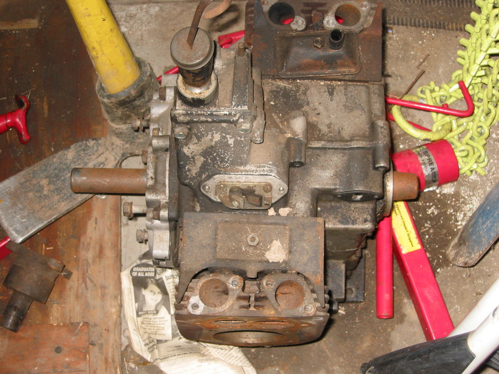

pfrederi 19,933 #2 Posted January 19, 2017 (edited) My guess would be the points have some corrosion on them from sitting. Are you familiar with small engines?? My C175s are sleeping for the winter and I do not have any good pictures of points. This is a stripped KT17. You can see the points just below eh oil dipstick. Yours would have a sheet metall box covering them. If you have a points file that is first choice to clean them if not a new dollar bill run back an forth between the contacts can work. Do you have a multimeter?? Edited January 19, 2017 by pfrederi 2 Share this post Link to post Share on other sites
