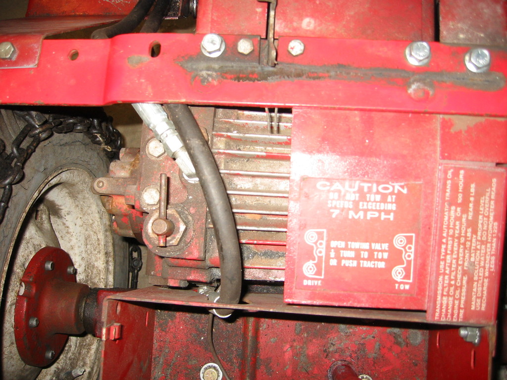

pfrederi 19,940 #2 Posted January 15, 2017 You rotate the tow valve 180 degrees. In this picture you see the roll pin sticking though the valve. Long end is to the front, that is drive position. Turn it 180 degrees so it points back and you can push. 2 Share this post Link to post Share on other sites
Jaymon74 84 #3 Posted January 15, 2017 This is what mine looks like. I have even taken all of the plugs out, with negative result. Share this post Link to post Share on other sites
pfrederi 19,940 #4 Posted January 15, 2017 (edited) That is not an original pump set up . What is the model # of your tractor. is there a metal tag on the hydro with a sundstrand ### I am wondering if the hydro gear unit was replaced by a piston to piston at some point. Edited January 15, 2017 by pfrederi 1 Share this post Link to post Share on other sites

pfrederi 19,940 #7 Posted January 15, 2017 (edited) 18 minutes ago, JAinVA said: I don't know much about the Sundstrand unit but with a Eaton 700 it will only move when under power.That is unless the motion lever is moved to the forward or reverse position, then it can be easily moved.Don't know if that would work in this case but it would be easy enough to try. On the Sundtrands you have to release the tow valve 14 minutes ago, Jaymon74 said: It is supposed to be a 1-7231 model. Could not find a tag on pump, did see casting stamp but couldn't make it out. Originally yours was a hydro gear On the left side of the tractor just in front of the axle housing is the hydro motor. If it is sort of figure 8 shaped it is an original hydro gear if it is round it has been converted to a piston to piston. When hydrogears failed they were NLA so WH replaced them with piston to piston units. The tow valve on them is different...I think!! I have to do some research Edited January 15, 2017 by pfrederi 2 Share this post Link to post Share on other sites
Ed Kennell 44,997 #8 Posted January 15, 2017 My three different models of Sundstrands have the Tow release on the left side. The one on top shown in Pauls picture, the one in the front left that is a screw driver slot, and the one on the rear that is a hex head bolt..7/16 I think. 3 Share this post Link to post Share on other sites

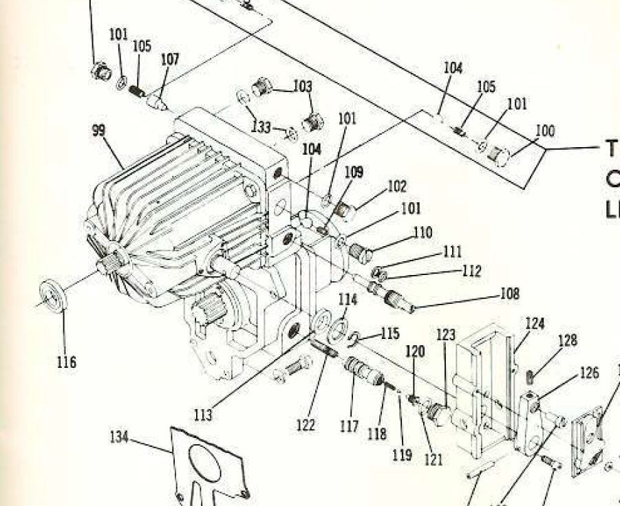

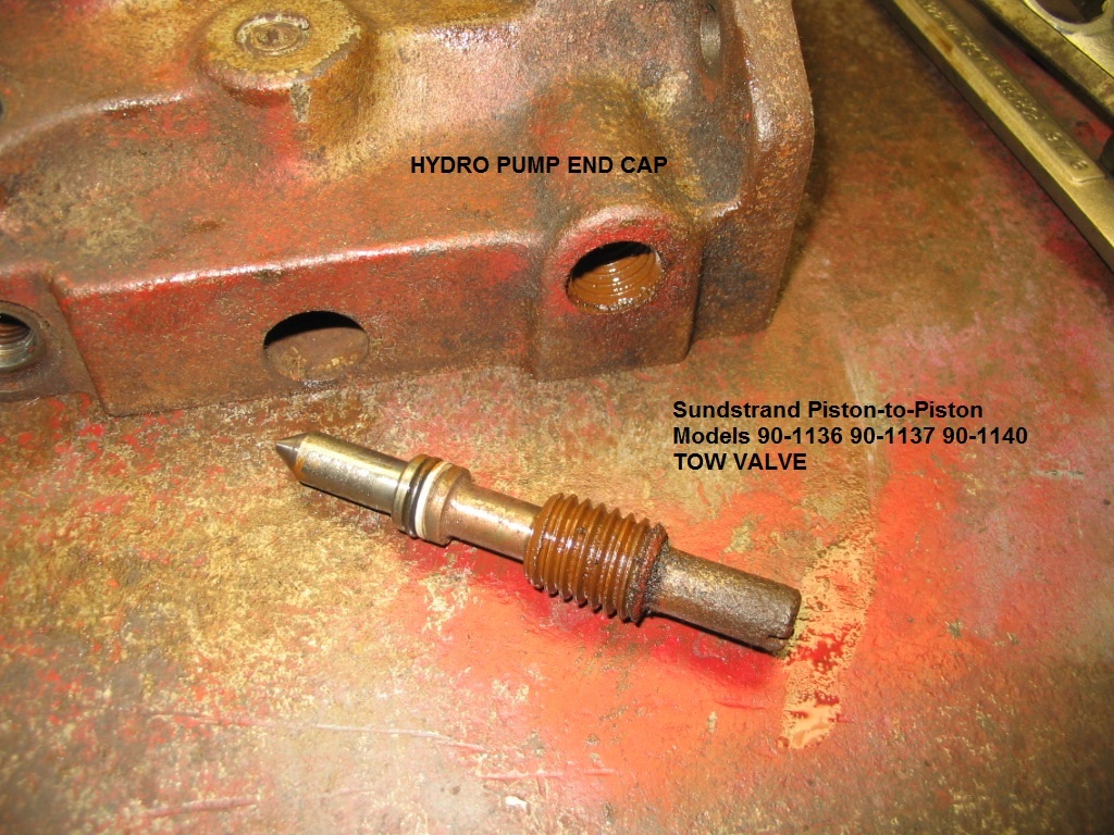

pfrederi 19,940 #9 Posted January 15, 2017 (edited) If it has been converted the tow valve would be in different location. it is #108 in the picture and would be a flat blade screw driver project/ Screwed it to drive back out a turn to push Edited January 15, 2017 by pfrederi 4 Share this post Link to post Share on other sites
Ed Kennell 44,997 #10 Posted January 15, 2017 Also the transmission drive must be engaged as this releases the parking brake. 4 Share this post Link to post Share on other sites
Jaymon74 84 #11 Posted January 15, 2017 3 minutes ago, pfrederi said: If it has been converted the tow valve would be in different location. it is #108 in the picture and would be a flat blade screw driver project/ Screwed it to drive back out a turn to push That is exactly how mine is. Thank you! Share this post Link to post Share on other sites

Ed Kennell 44,997 #13 Posted January 15, 2017 Those slotted tow release valves are notorious for being frozen. I would make sure you have a good hardened tight fitting drive socket. Snap On has them. 3 Share this post Link to post Share on other sites
Jaymon74 84 #14 Posted January 15, 2017 1 minute ago, Ed Kennell said: Those slotted tow release valves are notorious for being frozen. I would make sure you have a good hardened tight fitting drive socket. Snap On has them. Good advice. I'll be careful with it. 18 minutes ago, pfrederi said: Excellent point...something I frequently forget ..almost counter intuitive to me...engage the drive system if you want o push it. I probably wouldn't have figured that one out. Thank you. 1 Share this post Link to post Share on other sites
