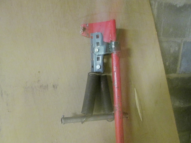

Ed Kennell 44,706 #2 Posted January 13, 2017 (edited) From Glen Petit in our vendor section. On mine, I used sections of garage door springs and trampoline springs until I got the desired lift assist. I attached mine to a rod that clips into the mid tach-a-matic. Edited January 13, 2017 by Ed Kennell 8 1 Share this post Link to post Share on other sites

W9JAB 156 #9 Posted January 13, 2017 (edited) I did this to my blower, found a spring at ACE, not much different from a "hobby Horse" spring hooked one side on the cross bar and drilled a 1/4" hole on the lift bar. It work fine. I do like the twin spring set up. Edited January 13, 2017 by W9JAB spelling 4 Share this post Link to post Share on other sites

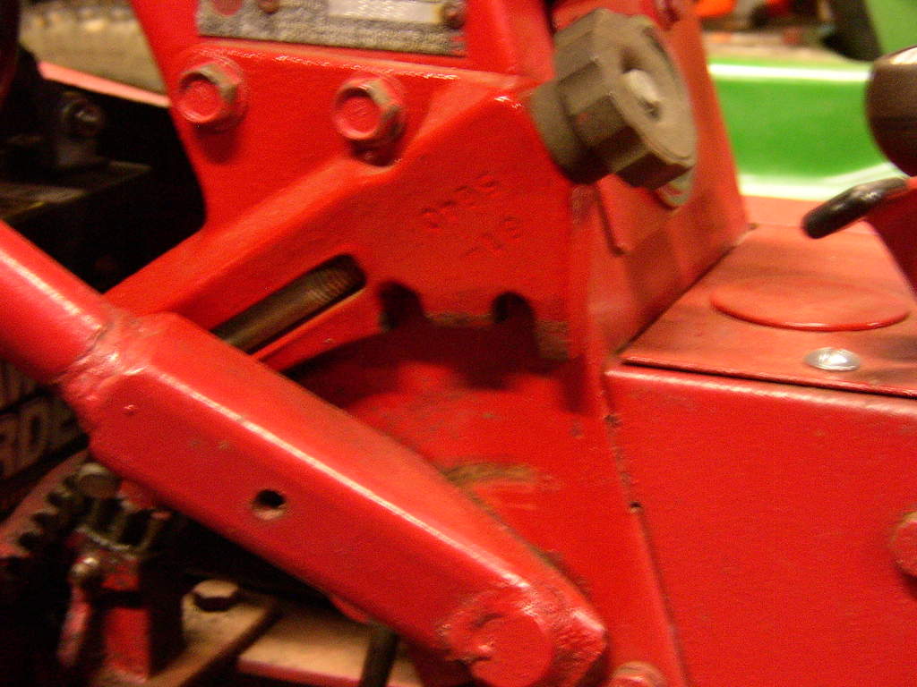

JimmyJam 542 #16 Posted January 14, 2017 Still on the subject of snowblowers... as for the lift arm, where is the best (optimal) rock shaft hole to use? Manual sez 1st hole. Is that the lowest hole? Is it the top hole? Some use other holes. My lowest hole is too tiny for the snow-blower pin, so I chose the middle hole. Tough to raise manually. Suggestions? Share this post Link to post Share on other sites
SPINJIM 1,996 #17 Posted January 14, 2017 Need to use the upper hole on the lift arm to get less resistance to lifting. You should be able to find the Owner's Manual for your plow under 'Manuals' on this site. Jim 4 Share this post Link to post Share on other sites
JAinVA 4,638 #18 Posted January 14, 2017 (edited) I believe its the top hole.I had the blower on the 416-8 last winter without the lift spring and I had no issue in lifting the blower.I'm in my 60s and am not all that big.I have the blower on the 416H this year because it is better suited to the task and lifting is effortless.Try the top hole. Edited January 14, 2017 by JAinVA 4 Share this post Link to post Share on other sites
JimmyJam 542 #19 Posted January 14, 2017 Oh. Ok. I thought the manual said 1st hole; to me I thought that meant lowest hole. My bad. I will switch it out tomorrow morning and try it out. Thanks! 1 Share this post Link to post Share on other sites

JimmyJam 542 #21 Posted January 14, 2017 May make a world of difference! It is taking me two hands on the manual lift to lift that heavy snow-blower on the lowest hole. Top Hole. Lift assist spring attached. We will see. Now help me out here with the lift assist spring: Should I adjust the eye-bolt (spring tension) with the snow blower in the complete "down" position or "Raised" position? Share this post Link to post Share on other sites
SPINJIM 1,996 #22 Posted January 14, 2017 It's easier to adjust it in the 'raised' position, then lower it and try it out. Trial & error. Owner's manual says 1 1/2" from end of eye bolt, but I found 2" to be better for the snowblower. The assist spring makes a big difference for the first few inches of lift, but after that you're lifting too much weight with no 'assist'. Most of the time I only need to lift the unit a few inches, not all the way up. So I cut a new notch in the slide for the lift arm. It locks into place with the unit about 3" off the ground. Jim 4 Share this post Link to post Share on other sites

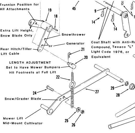

wheelhorseman 3,244 #24 Posted January 14, 2017 3 hours ago, JAinVA said: I believe its the top hole.I had the blower on the 416-8 last winter without the lift spring and I had no issue in lifting the blower.I'm in my 60s and am not all that big.I have the blower on the 416H this year because it is better suited to the task and lifting is effortless.Try the top hole. 3 hours ago, SPINJIM said: Need to use the upper hole on the lift arm to get less resistance to lifting. You should be able to find the Owner's Manual for your plow under 'Manuals' on this site. Jim This should help. 6 1 Share this post Link to post Share on other sites
JimmyJam 542 #25 Posted January 14, 2017 Thanks Lowell. That drawing puts things in perspective. 2 Share this post Link to post Share on other sites
