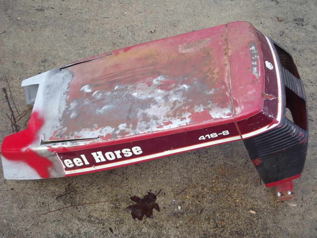

JAinVA 4,638 #8 Posted January 12, 2017 Notfishin, Just so you can see how much wider the 520 hood is at the rear than a 300-400 hood look below.The 518 hood is the only one I'm aware of that has no louvers. 1 Share this post Link to post Share on other sites
Jerry77 1,218 #9 Posted January 12, 2017 1 hour ago, JAinVA said: Notfishin, The 518 hood is the only one I'm aware of that has no louvers. 516 don't either..... Share this post Link to post Share on other sites
JAinVA 4,638 #10 Posted January 12, 2017 I stand corrected. Share this post Link to post Share on other sites
