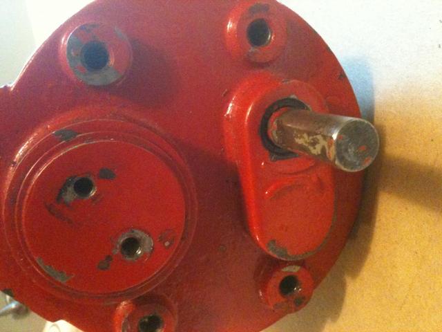

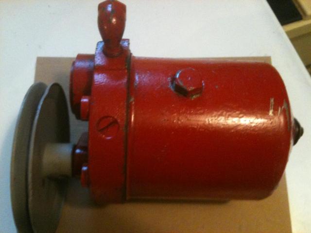

Lane Ranger 11,578 #2 Posted January 11, 2017 (edited) You have to remove the right side panel off the tractor, the hoses and there are two bolts (apparently four as the photo shows two on top and two on the bottom) holding the Hein-Werner pump in the side of the frame. Make sure to look at the 953 Manual drawing. It is available on Red Square. Edited January 11, 2017 by Lane Ranger 3 Share this post Link to post Share on other sites
