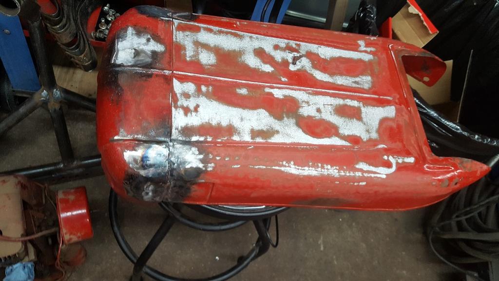

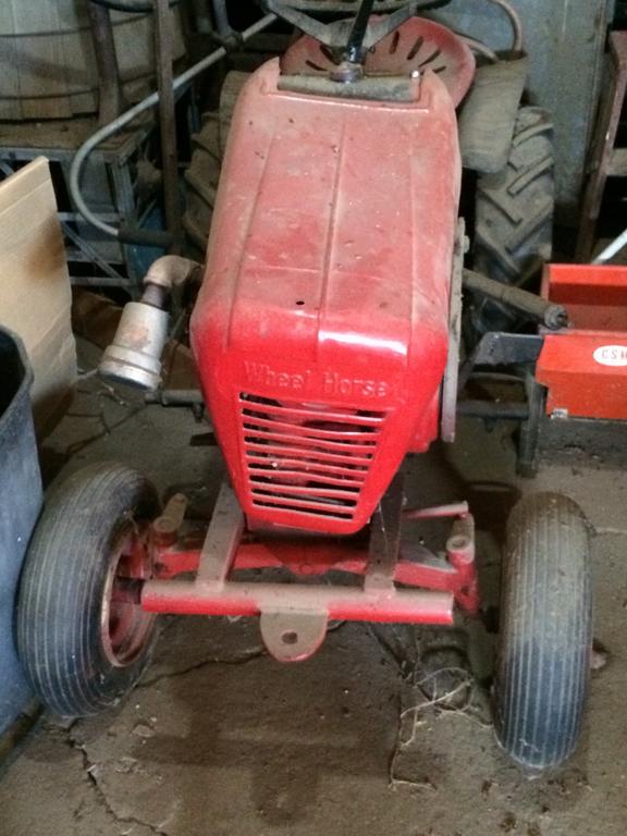

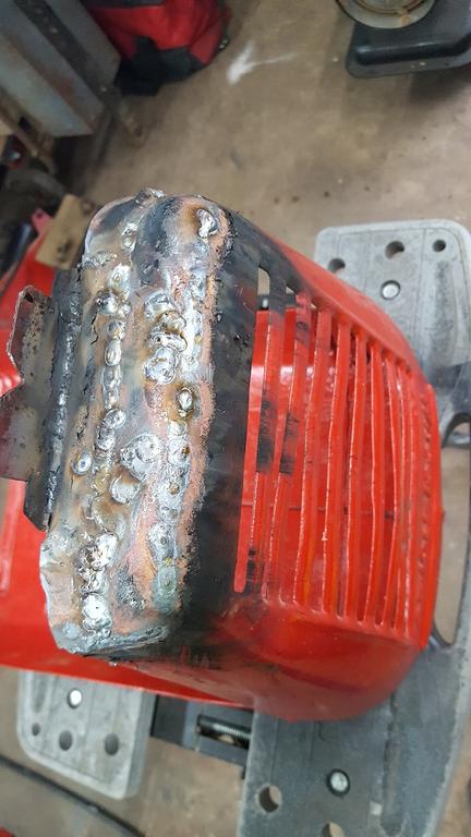

clemet 146 #5 Posted January 10, 2017 (edited) Here is what I started with. Here is the progress so far. I have been cutting and welding up all the pieces removing as much of the damage as possible. I will end up using body filler to smooth out the welds. Edited January 10, 2017 by clemet 7 Share this post Link to post Share on other sites

Texas Todd 1,025 #7 Posted January 11, 2017 That is a lot of welding. Well done! 1 Share this post Link to post Share on other sites

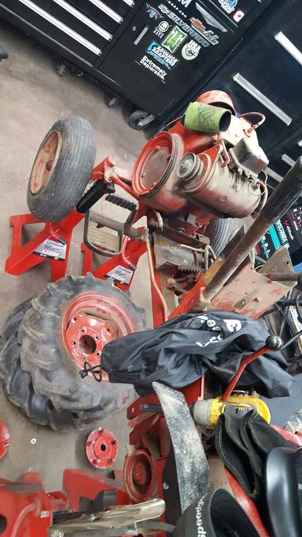

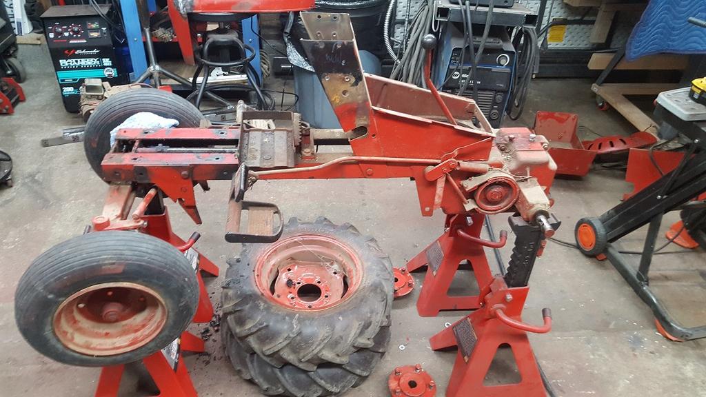

clemet 146 #11 Posted January 22, 2017 Got the hood as good as I could. It still has some imperfections, but I am happy with the way it came out. I will be adding another coat still. Then I tore it the all the way down so I can start on the frame and transmission in order to work from the bottom up. When I saw the peanut butter come out of the trans and not a lot at that I was worried. Everything is cleaning up good though and I have ordered all the needle bearings and seals so that I can freshen it all up. 4 Share this post Link to post Share on other sites

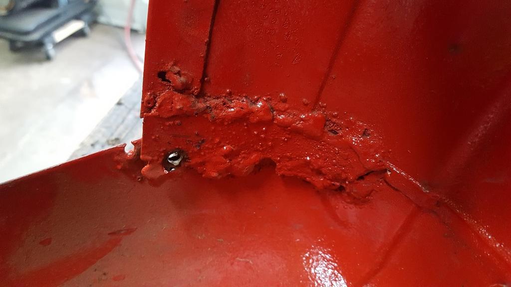

clemet 146 #13 Posted January 23, 2017 I got the inside of the transmission cleaned up, and the case cleaned and primed. Then I cleaned up the frame and found the "dreaded" transmission mount cracks. I have seen some of the ways people have fixed it, but decided not to go to the extremes and only used 2x2 14 ga angle to reinforce the corners after grinding and welding the cracks. 7 Share this post Link to post Share on other sites

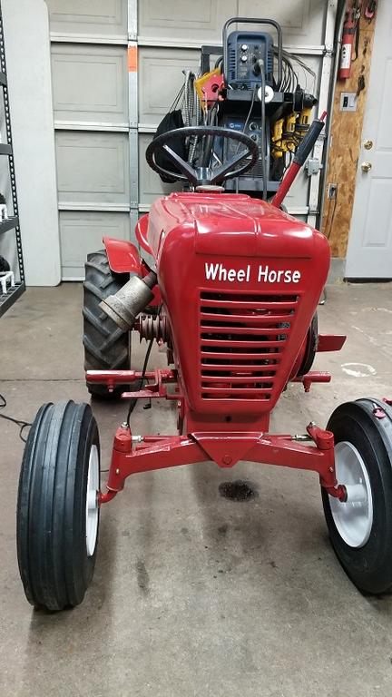

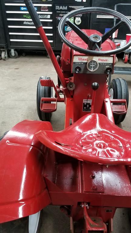

clemet 146 #17 Posted February 10, 2017 (edited) Here is the progress from tonight. It's a little filthy, but there is no scoring or obvious wear in the cylinder walls. I will hone it once I get it cleaned up. The only thing I found is my valve spring compressor won't work with this engine so I have to pick up a different one tomorrow, and then I can finish the tear down so that I can get it cleaned. I have all the parts here for the rebuild including new valves, con rod and piston. Ignore the screwdriver that is for me to remember where to reconnect the linkage when I put everything back together. Edited February 10, 2017 by clemet 1 Share this post Link to post Share on other sites

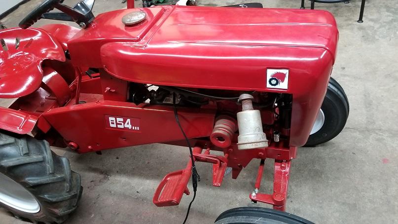

clemet 146 #18 Posted September 11, 2017 (edited) After a bunch of time spent working I finally had time to get this one back in the shop and finished up. Now to get a mower deck for it so that I can mow the yard with it next year and see how many people stop and ask about it. Pictures are in no particular order just re-adding the ones lost when photobucket decided to be a pain in the rear. Edited September 11, 2017 by clemet 2 1 Share this post Link to post Share on other sites
