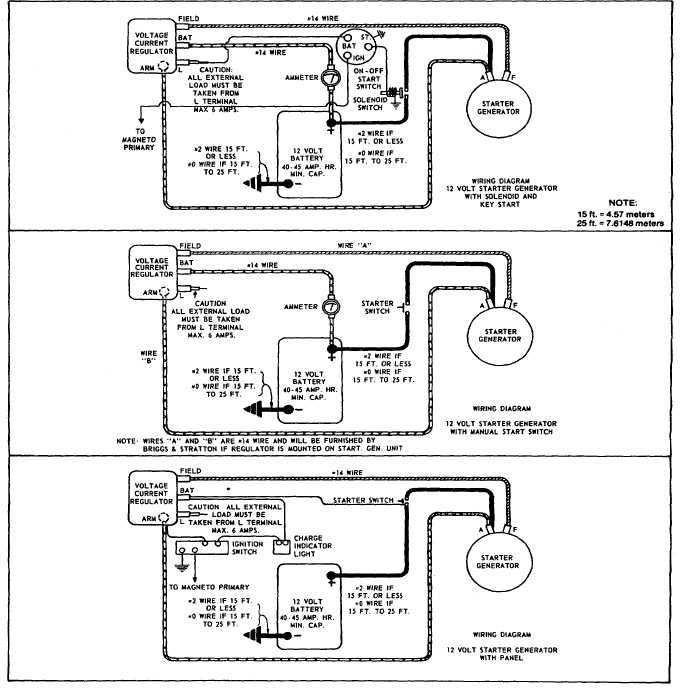

953 nut 64,174 #7 Posted January 5, 2017 Mike and Garry have both given you good information. Before you remove the S/G try a few basic checks, be sure the battery is fully charged, clean and tighten all electrical connections including grounds and use a jumper cable from the battery "+" terminal to the S/G "A" terminal to be sure it isn't the key switch causing the problem. Here are a couple more things to look over to help decide what is going on. Starter Generator Assembly Trouble shooting.docx Your switch will be like the illustration on the top (minus the solenoid and you have a battery ignition system, not Magneto) unless a previous owner altered it. The wiring diagram in your owner's manual is good too. 2 Share this post Link to post Share on other sites
