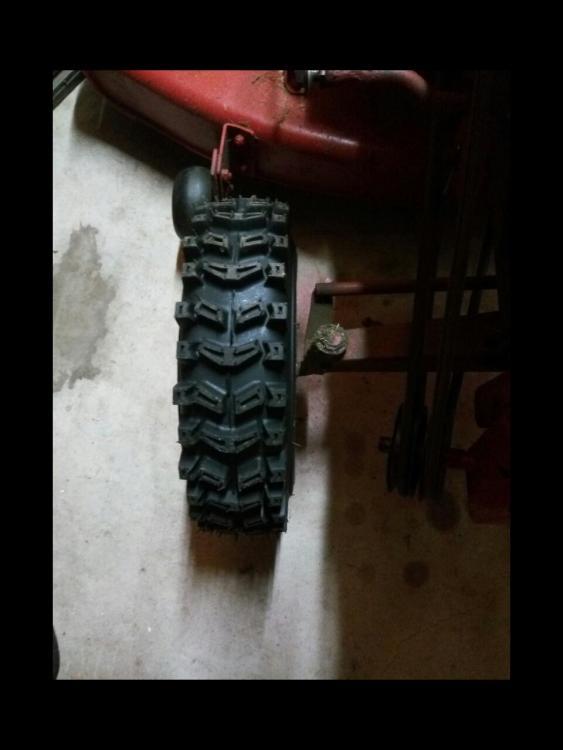

mmmmmdonuts 274 #2 Posted January 2, 2017 I got a pair of xtrac tires on the front of my Raider. I use my Raider for mowing and snowblowing and they seem to be a fantastic all around tire and have improved my steering quite a bit. I got the 4.8-8 on the Raider. http://www.carlisletirestore.com/store/xtrac.html 3 Share this post Link to post Share on other sites

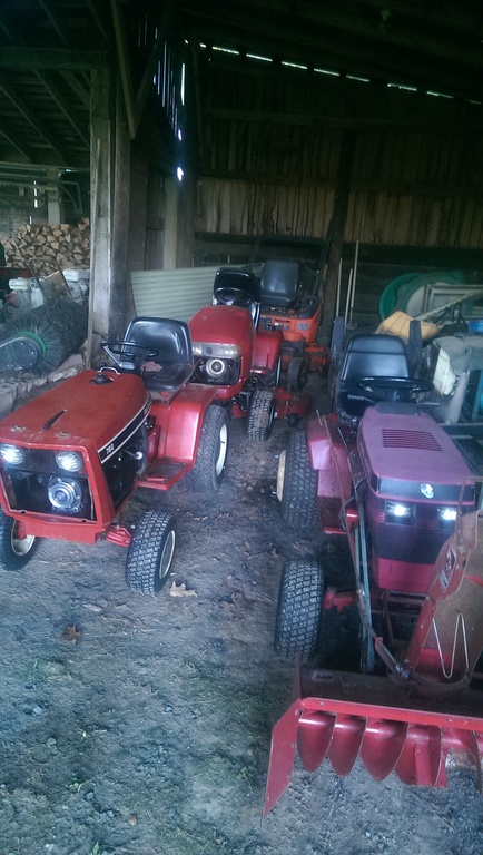

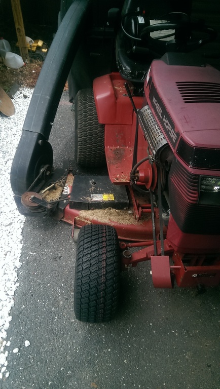

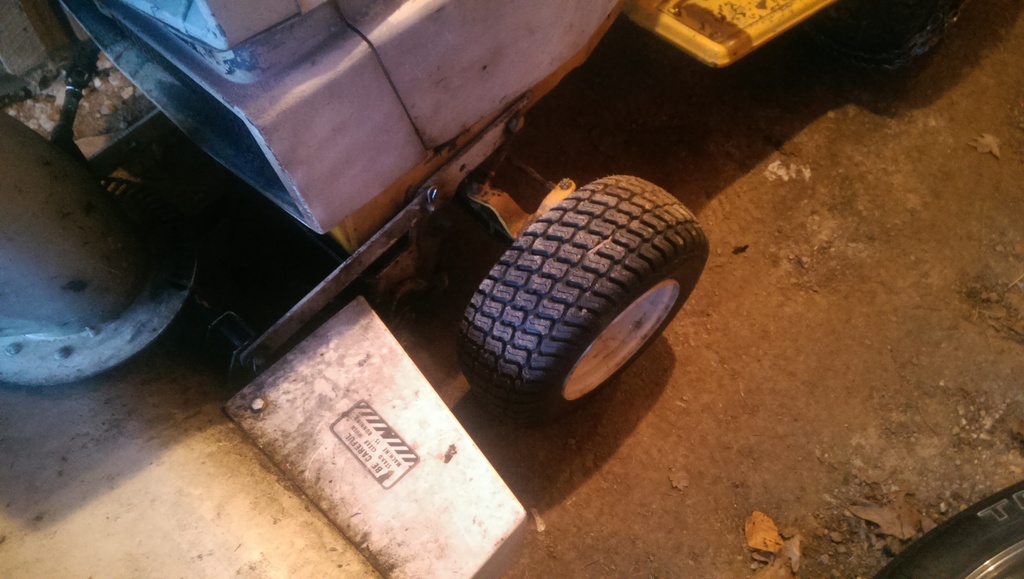

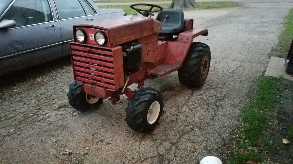

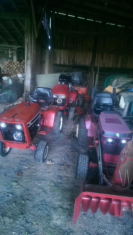

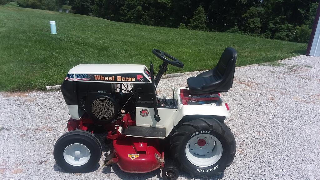

WVHillbilly520H 10,376 #3 Posted January 2, 2017 I like my newer style turfs on the front of my 520(16x7.50-8) they have wider rims, and dad's 1450 CC also on FIL's 782(16x6.50-8) which seem to ride/steer better than the smooth ribs that was on the Cubs, (last pic should show the size difference) ,Jeff. 5 1 Share this post Link to post Share on other sites

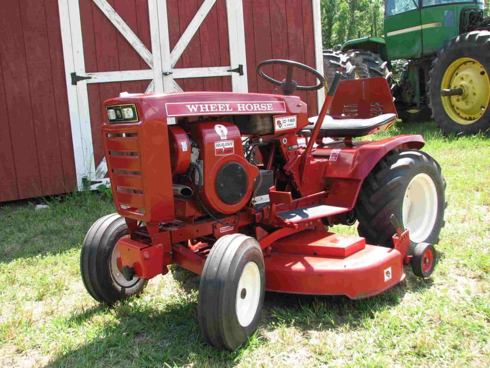

tbarnhart 240 #6 Posted January 3, 2017 Check the width of the rims on that 160. The early ones came with a narrow rim. Although they had 16x6.50x8 tires from the factory, they were pulled in on the narrow rims and bulged a bit in the middle. I wouldn't go any wider with those wheels. The later ones had wider wheels. I know my '74 model has the narrow ones and I went with the 4.00x8 deestone tri-ribs. They fit well and I think they go well with the whole look of the tractor. I've been happy with them. If you have the wider wheels, I'd jump on those Vred v61s. They just look right for a tractor. 1 Share this post Link to post Share on other sites

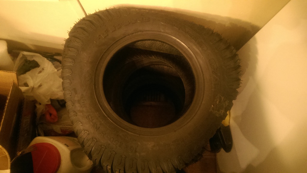

Lee1977 7,129 #20 Posted October 1, 2019 I have the 400 x 8 Deestone from Greater Cleveland Tire on my 312-8. On narrow rims they measure 16.5" in height. Share this post Link to post Share on other sites

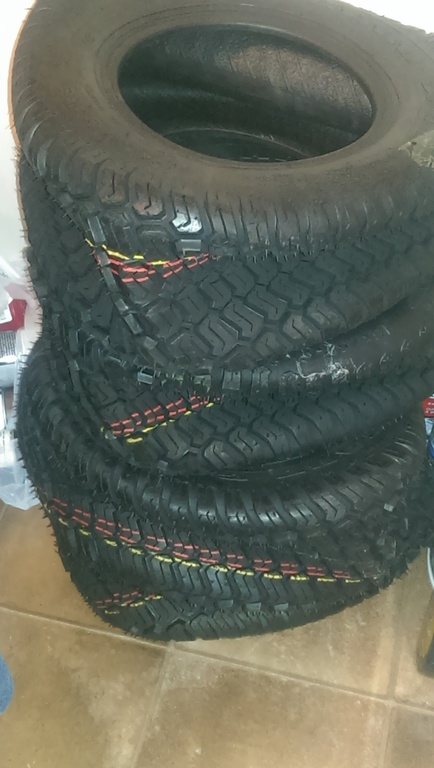

JohnnyD 0 #23 Posted October 2, 2019 (edited) Thanks so much guys should have them delivered to my house by Thursday and once I get em on soon I'll post some pics. Edited October 2, 2019 by JohnnyD Share this post Link to post Share on other sites

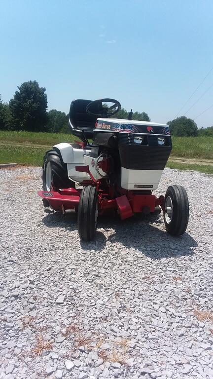

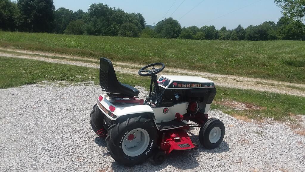

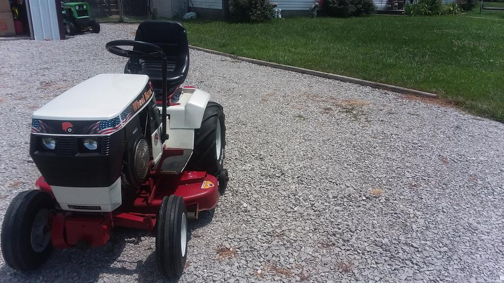

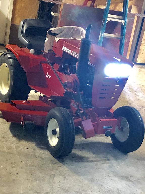

Warning:Unsupervised 82 #25 Posted July 18, 2023 Been meaning to post pics with mine on my 414-8 for a yr because this post really helped me out. Triple bypass in Jan got in the way of posting my Triple Rib tias....lol These are Deestone 4:00-8 on 4" rims? May be 3.5" rims but old WH rims made for 4:00 tire with tapered bearings if that helps any. Done forgot actual rim width sorry all. 4" is my bet, Lordy Lordy I think I'm an old fart folks. Well no more sliding around slowing my old arse down, Im safer cruising on high now..lol. Well high sometimes, I really sped her up substantially..so hit high you hang on tight, yeehaw! Grip is just fantastic on my hills with tri-ribs, I highly recommend them. Best part its just like having power steering man! If you suffer from upper extremity issues like myself, this is your answer! They don't call them "Easy Steer" for nothing that's a fact. 3 Share this post Link to post Share on other sites
