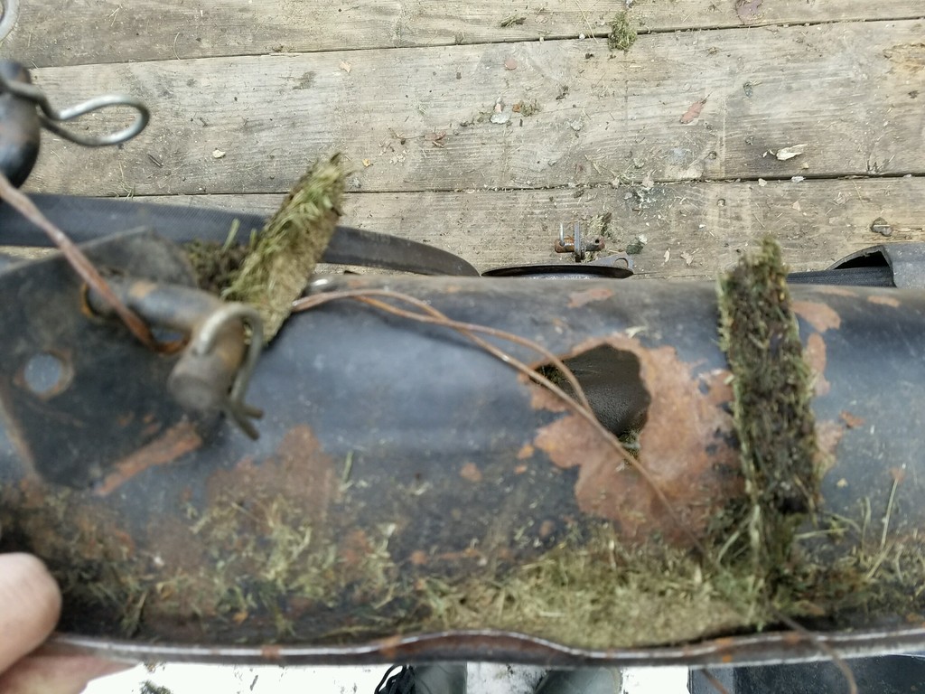

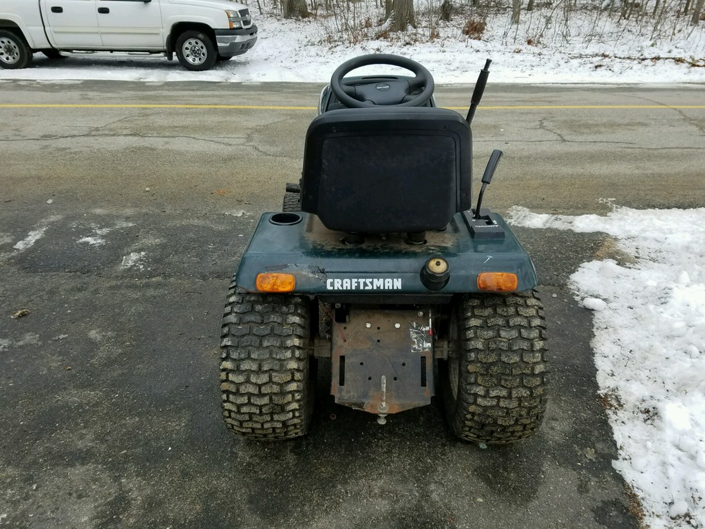

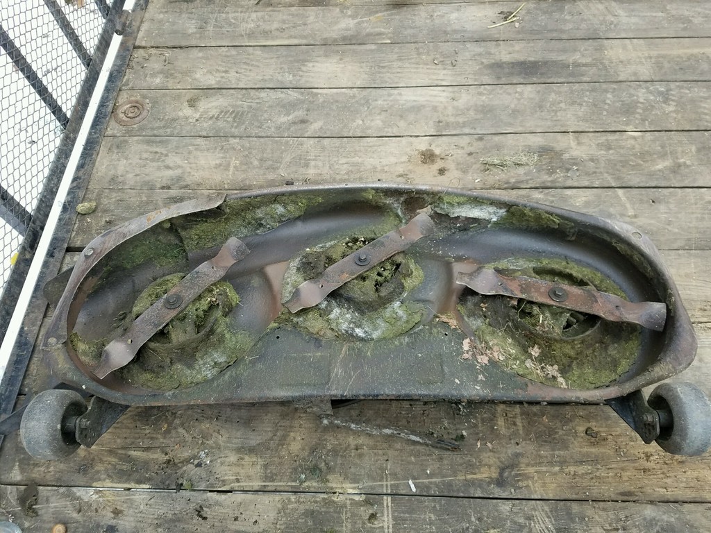

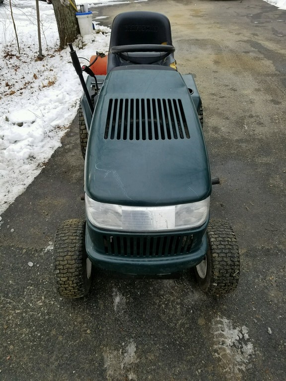

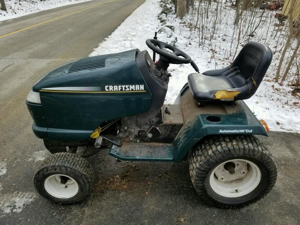

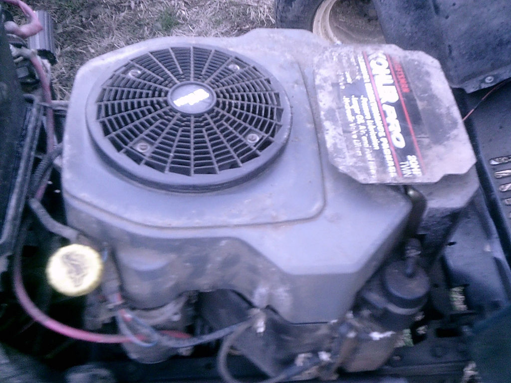

Docwheelhorse 2,792 #1 Posted January 1, 2017 (edited) Happy New Year all... Well if you haven't seen my other posts I had one last road trip for 2016.... it got started looking for a 46" deck for my Craftsman GT5000---the GT5000 only comes with a 50" deck and no bagging option. So..... find a 46" deck and swap it on from a GT3000 and you can put a bagger on. Well the guy seemed to have a bunch of tractors etc...and I "flipped" through his stuff and he had a 1056 with a snow plow (couldn't resist that...) plus an old "junk" Sears LT 1036... I ended up buying the GT3000 he had, the 1056 and the LT 1036.... story on the GT3000 was that the previous owner dropped it around a foot out of his shed and that the transmission was "shot". I didn't care as I was buying it for the deck anyways.... turns out the deck is a bit beat up... but I should be able to get it welded and working for my bagger. Welll..... LMAO---after I got the deck off and tires blown back up I crawled under and the belt had simply popped off the idler... put it back on, threw in a battery and it started right up and I was driving it around. It does have a cough/gag in the carb I will need to address but it runs nice and drives just as good! It needs a bath BAD but that may wait till spring, I did clean the mouse nest out of it. I can't believe that this guy with a yard FULL of Bolens tractors and so on didn't spend 5 minutes seeing what was wrong.... Engine video---I DID NOTHING but put in a battery... its running on the gas in the tank!! http://vid430.photobucket.com/albums/qq30/andoverct/20161231_131548video_zpsxnstqs1z.mp4 Tony Edited January 1, 2017 by Docwheelhorse Modified link 3 Share this post Link to post Share on other sites
