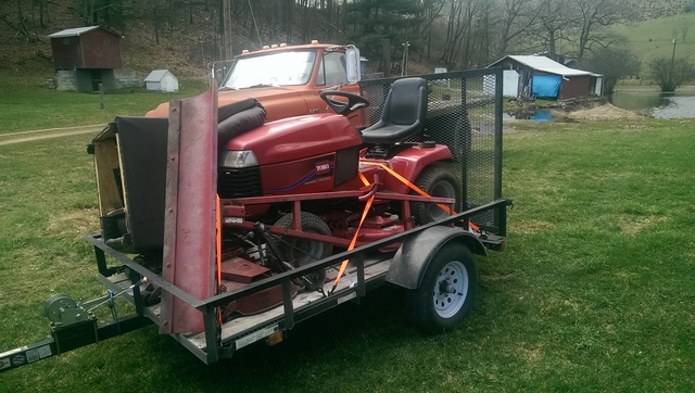

bmsgaffer 2,069 #7 Posted December 29, 2016 This trailer is a bit over 8' long. I did not have the tractor pulled up all the way to keep the tongue weight proper, but that may only net you 4" or so.... I would take the tandem as I am pretty sure a snow blower is longer than the room I had left. Also, bring extra wood to lengthen ramp as I don't think the snow blower will lift more than 4-5" off the ground and may not clear the ramps. 1 Share this post Link to post Share on other sites

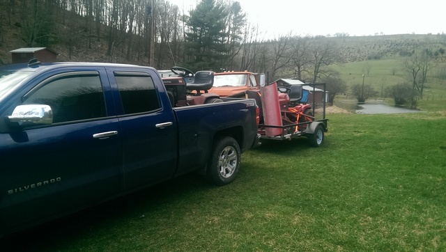

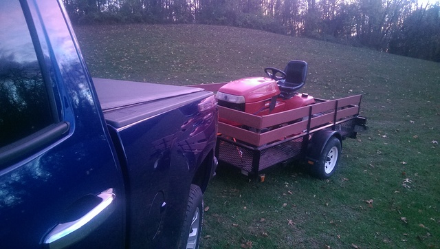

WVHillbilly520H 10,378 #8 Posted December 29, 2016 I used a 6'x12' trailer last month just to tug a 520xi with 60" deck home as the deck was too wide for my 5'x8' without removing, but when I brought the Dxi home with 48" deck snow plow and a 520h 48" deck on the 5'x8' it was all I wanted on there,Jeff. Share this post Link to post Share on other sites
