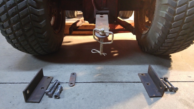

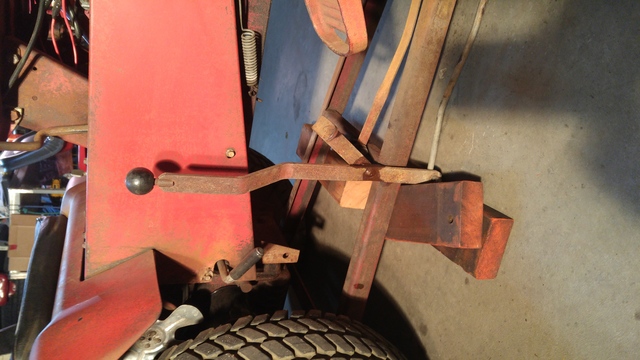

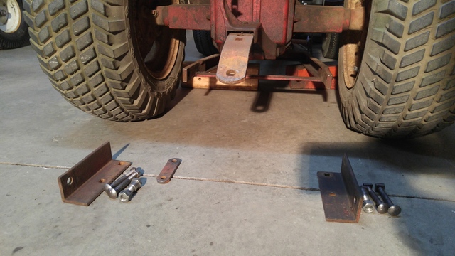

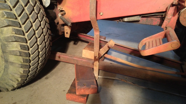

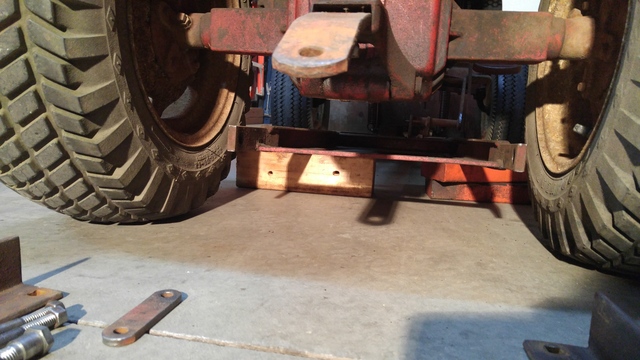

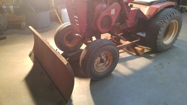

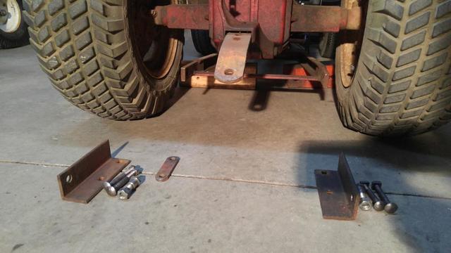

gt4 196 #1 Posted December 27, 2016 If anyone has a picture or has ever hooked up one of these foot triggered plows, could you please post one up for me. I'm a bit confused how and where the rear brackets attatch on the 875. Thanks Share this post Link to post Share on other sites
oldlineman 1,626 #2 Posted December 27, 2016 (edited) the angle peaces go on the rear axle houseing and the short bolt goes through the angle and the hole on the end of the plow. Might be easer to put angles on the plow and then bolt brackets to the axle. I don't have a picture but someone will be here soon with one i'm sure. I believe the angles go on the front with the flat straps going on the back side with the long bolts going between them, probably turned out. Edited December 27, 2016 by oldlineman 1 Share this post Link to post Share on other sites
gwest_ca-(File Mod) 11,920 #3 Posted December 27, 2016 Looks like you may have this one which you can download Garry 1 Share this post Link to post Share on other sites
gt4 196 #4 Posted December 27, 2016 So i didn't get any u bolts with it, do i need to get a set of those for the bracket? Share this post Link to post Share on other sites
gwest_ca-(File Mod) 11,920 #5 Posted December 27, 2016 The carriage bolts and the strap in your photo will replace the U-bolts. Garry 1 Share this post Link to post Share on other sites
