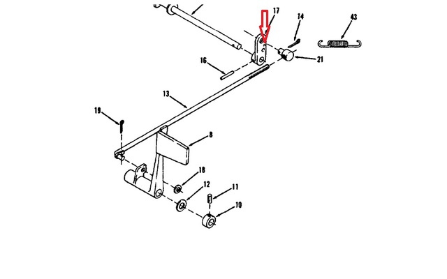

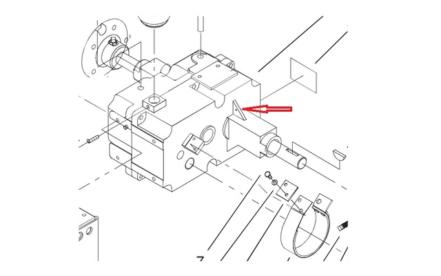

gwest_ca-(File Mod) 11,472 #4 Posted December 23, 2016 Left and right is always from the operator's position in the seat. The spring goes on the left side of the transmission. Small hole in the lever behind the pedal Small hole in the cast web above the left axle housing. Finding the holes in illustrations is almost as hard as finding them on the tractor. The first damper used was simply an air shock with a small hole in the end. Air movement was restricted by the hole and dirt would plug them up. Removing them for a thorough cleaning restored their effectiveness. A couple of designs followed that used a high pressure shock and when they fail they are done. Garry 1 Share this post Link to post Share on other sites
