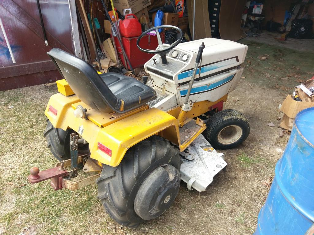

Duramax7man7 506 #1 Posted December 17, 2016 Hey Gang, Just figure that I'd show some shots of my hitch fresh out of the box and installed and in use... I'm not using this thing for much other than a ballast weight setup of 100lbs but it's PERFECT for it! So worth the money with a well built attachment. Will have many uses in the feature! Thanks Fellas! 13 Share this post Link to post Share on other sites

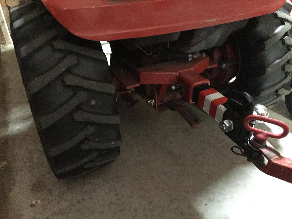

GlenPettit 1,717 #6 Posted August 21, 2017 (edited) Craig: I'm easily moving around a 3,000# trailer on a reasonably level gravel drive, backing up and turning it (with lug tires and a weighted front), I'm sure the tongue weight is 5-600# but then a little bounce will make that well over 1,000# -- and this receiver system has absolutely no problem handling it. I have had two of these hitches for last 3-years and they are great, highly recommend them. Especially like the extended hitch distance when towing a cart, much easier to turn (but it can be a shin nicker, from experience). Note: With weight behind the axle, it will lighten the front some and reduce steering, especially in snow, must have extra weight up front too. Glen That's a 7/8" tractor hitch pin with d-rings holding the receiver to the tranny (TSC - $10, not supposed to freeze/rust in place) and the hitch was for ATV's, with 3 uses. Edited August 21, 2017 by GlenPettit 1 Share this post Link to post Share on other sites
cschannuth 3,817 #7 Posted August 21, 2017 1 hour ago, GlenPettit said: Craig: I'm easily moving around a 3,000# trailer on a reasonably level gravel drive, backing up and turning it (with lug tires and a weighted front), I'm sure the tongue weight is 5-600# but then a little bounce will make that well over 1,000# -- and this receiver system has absolutely no problem handling it. I have had two of these hitches for last 3-years and they are great, highly recommend them. Especially like the extended hitch distance when towing a cart, much easier to turn (but it can be a shin nicker, from experience). Note: With weight behind the axle, it will lighten the front some and reduce steering, especially in snow, must have extra weight up front too. Glen That's a 7/8" tractor hitch pin with d-rings holding the receiver to the tranny (TSC - $10, not supposed to freeze/rust in place) and the hitch was for ATV's, with 3 uses. Thanks very much. I assumed the hitch could handle it no problem. I was more worried about the rear axle and where it attaches to the transmission tunnel since it probably gets a lot of torque put on it. Thanks again. Share this post Link to post Share on other sites
Duramax7man7 506 #8 Posted August 22, 2017 I"m sure the hitch can handle hundred's of pounds easily! The Axle will break long before the hitch will. that's for sure. Share this post Link to post Share on other sites

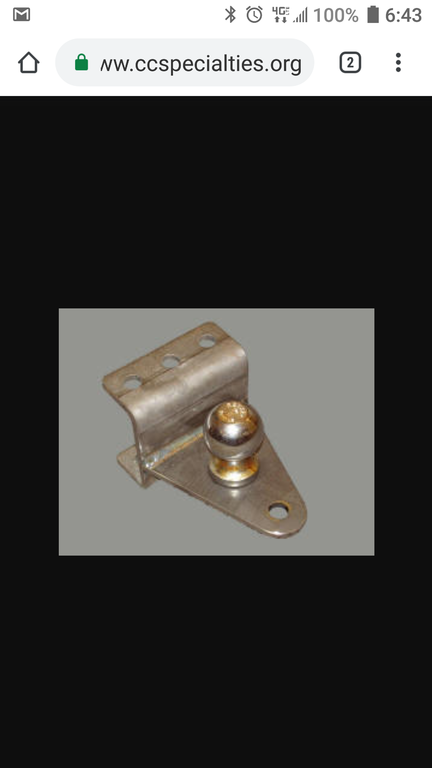

WVHillbilly520H 10,376 #10 Posted September 27, 2018 (edited) 32 minutes ago, Whnewone said: Where did you get this from. I also wonder if they make it where it can move up and down with hydraulic lift. A vendor here in our classifieds, Rupert's Brother welding, ...do you have a sleeve hitch? I'm sure I could draw you up something to be made to use with it. Edited September 27, 2018 by WVHillbilly520H 1 Share this post Link to post Share on other sites
Blackhood Bill 722 #11 Posted September 27, 2018 That picture gave me an idea. Thanks 1 Share this post Link to post Share on other sites
Machineguy 877 #12 Posted September 28, 2018 2 hours ago, Whnewone said: That picture gave me an idea. Thanks That Hillbilly is a pretty sharp guy! 1 Share this post Link to post Share on other sites
WVHillbilly520H 10,376 #13 Posted September 28, 2018 12 hours ago, Whnewone said: Where did you get this from. I also wonder if they make it where it can move up and down with hydraulic lift. 12 hours ago, WVHillbilly520H said: A vendor here in our classifieds, Rupert's Brother welding, ...do you have a sleeve hitch? I'm sure I could draw you up something to be made to use with it. 12 hours ago, Whnewone said: That picture gave me an idea. Thanks Or you could go here...https://www.ccspecialties.org/3points_sleevehitches.html...that is if you have a sleeve hitch, if not go here...https://www.wheelhorsepartsandmore.com/hitches-liftkits.html#!/Hitches-&-Rock-Shaft-Kits/c/23548047/offset=12&sort=normal...if you are trying to use it for trailers or wood splitters...i made a couple for myself and dad like this 1 on his 1200. Share this post Link to post Share on other sites
