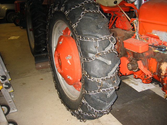

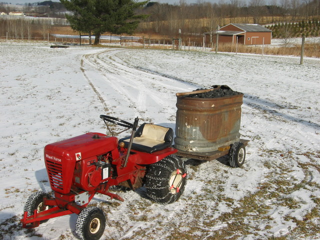

pfrederi 19,933 #1 Posted December 15, 2016 I know there has been a lot of discussion on AGs vs chains etc. You would think that the big Carlisle ags on my 310-8 would do fairly well hauling things in the winter. Not so. I had planned on using the 310 this winter to haul coal up from the barn to the shop and house. I have a horse trough trailer that holds about 750lbs of coal (10-14 day supply).. My faithful Lawn ranger has hauled it up for many years with out a problem. Tried today to test the 310, I hauled the ashes down in a 30 gal trash can and dumped them then came back up empty. The 310 with AGs barely made it back up the hill, lots a wheel spin no way she could bring up the coal wagon. So the 310 is going away till mud season and the 49 yr old Ranger will go back to work. 14 Share this post Link to post Share on other sites

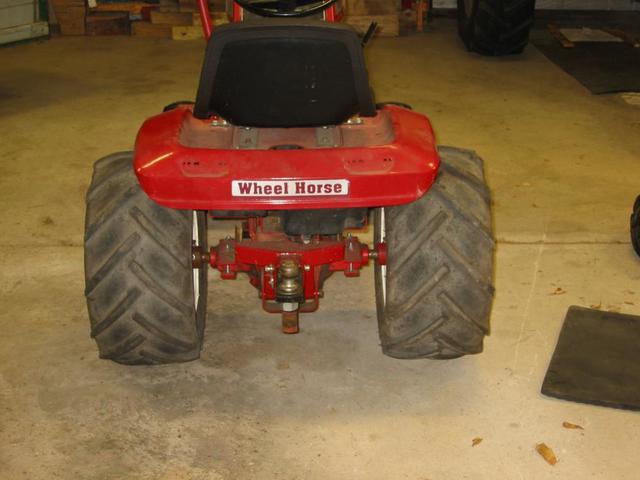

pfrederi 19,933 #8 Posted December 15, 2016 I use it year round and in muddy season i do not want to make big ruts that would come from fluid filled tires. Also I understand chains on AGs. You have to have double ring chains or duo-link..like I use on the big tractors. My DC3 has 600lbs of iron weights but doesn't go out with out chains in the winter. The Farmall M had 700 lbs of beet juice in each rear and also is worthless once the ground freezes hard with out chains. (Hard to find double ring or duo links for Wheel Horses) Yes narrow is best. My Plow and blower Horses have 6.00 12s with weights and chains. Haven't had to use the Case yet this year and didn't use it at all last year. the Horses are more than enough. Guess i was just surprised how poorly the Ags on the 310 did. 7 Share this post Link to post Share on other sites

Coadster32 793 #17 Posted December 16, 2016 (edited) I noticed in this this picture...you might consider moving in your hubs a bit. Looks like there's alot of room to the transaxle. I agree with most said as far as traction. I also switched from loaded AG's to turfs and chains with better results. Edited December 16, 2016 by Coadster32 2 Share this post Link to post Share on other sites

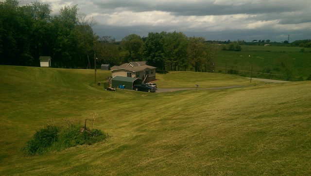

WVHillbilly520H 10,378 #20 Posted December 16, 2016 Now just my but looking at what I have to mow, loaded weighted AGs work best for me and I'm a little on the cheap side so I don't have extra wheels/tires combos and I don't like change them out or attachments much either so a set of 2 links over the AGs in winter and I'm set all good no traction problems and as far as ride 7-10 psi in the loaded tires no issues for me,Jeff. 2 Share this post Link to post Share on other sites
pfrederi 19,933 #21 Posted December 16, 2016 3 hours ago, Coadster32 said: I noticed in this this picture...you might consider moving in your hubs a bit. Looks like there's alot of room to the transaxle. I agree with most said as far as traction. I also switched from loaded AG's to turfs and chains with better results. I have wondered about the spacing...The hub and axle end are flush. I am reasonably sure the axles are original to the tractor, not sure why the big gap Share this post Link to post Share on other sites
slim67 2,824 #22 Posted December 16, 2016 47 minutes ago, WVHillbilly520H said: Now just my but looking at what I have to mow, loaded weighted AGs work best for me and I'm a little on the cheap side so I don't have extra wheels/tires combos and I don't like change them out or attachments much either so a set of 2 links over the AGs in winter and I'm set all good no traction problems and as far as ride 7-10 psi in the loaded tires no issues for me,Jeff. That is a beautiful piece of land there. 1 Share this post Link to post Share on other sites

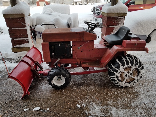

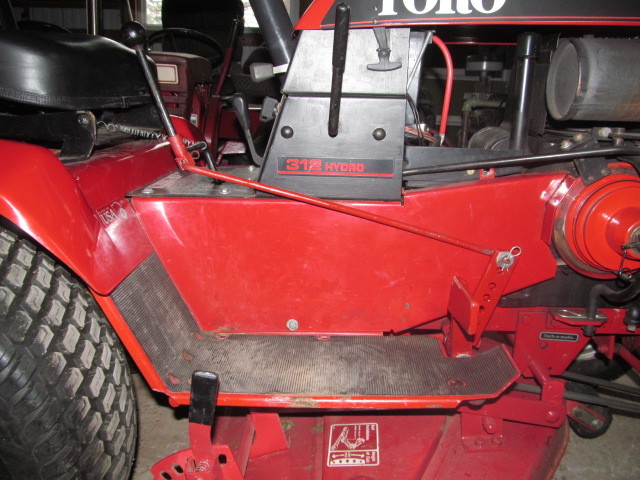

Ed Kennell 44,954 #23 Posted December 16, 2016 I know we have discussed this in other threads, but while we are talking traction, I'll say it again. Two years back I bought a 312 auto for resale. It came equipped with a 42" SD deck, cab, 48" blade, hyd lift, wheel weights and rubber chains. After using it last winter to clear the five driveways of my neighbors, it is no longer for sale . It is now my dedicated snow plower. I was pleasantly surprised and amazed at the traction the rubber chains possessed. I have added the foot control to free up a hand to operate the lift and the antisway bracket on the front attach-a-matic. This set up really works well in the areas where many changes in direction and back dragging from garage doors is required. Another plus is, If a wheel does spin, I don't have to be concerned about scuffing up a neighbors newly coated blacktop. 2 Share this post Link to post Share on other sites
