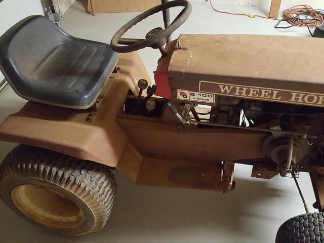

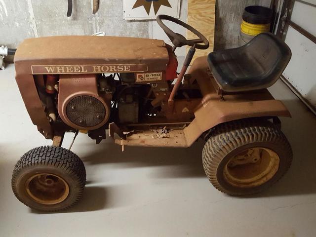

Drillbit 45 #1 Posted December 12, 2016 Hi all, I'm new here. See pictures of a 1977 B-100 Wheel Horse that I grew up with. My dad bought this brand new when we moved to a farm in 1975. It has been through 3 of us sons, mowed a hell of alot of grass and I even made a snow blade/pusher out of 2 pieces of 5" channel welded on top of each other that bolted to the back of the hitch of this fine machine along with a set of snow chains. Did a great job. The old Kohler engines are monster tough. This is is going to be my winter restore project. Still runs great. I have been bitten by the wheel horse bug. I am having a tough time finding the rear tires though. 22 x 7.50-12. Any alternatives? 18 Share this post Link to post Share on other sites
Sparky-(Admin) 24,072 #2 Posted December 12, 2016 You can upsize to a 23x8.50x12 rear tire with no clearance issues. Mike..... 4 Share this post Link to post Share on other sites

Drillbit 45 #14 Posted December 14, 2016 Thanks all for the very warm welcome. I know what some of you mean by keeping the PATINA look, but this one has lost almost all of the exterior paint. I can rub my fingers across the hood or fender and get nothing but rust film. There is a cover plate missing on the gear shifter that I thought may be hard to find, but my dad found it in his shed. Amazing how these things work out. 1 Share this post Link to post Share on other sites

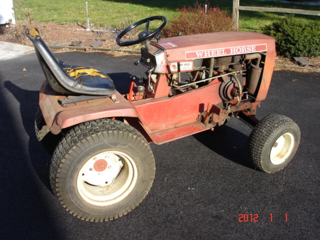

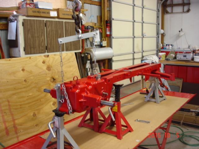

Marv 994 #15 Posted December 14, 2016 Welcome Drillbit. Got right under my skin you did. This is my B80. It's life story is very similar to yours. Decided to restore it. Obviously I am slower than the 7 year itch. second picture is where it sits now. Maybe I will get it finished one day. Enjoy yours and I hope your restoration progresses faster than mine. Marvin 4 Share this post Link to post Share on other sites

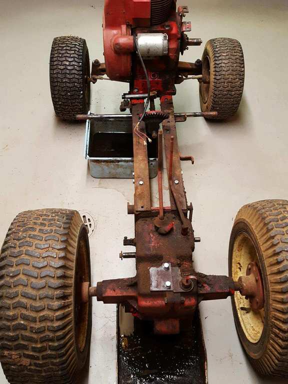

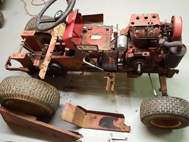

Drillbit 45 #16 Posted December 24, 2016 Marvin, that chassis looks great! Well, I'm on my way to the tear down and I'm starting to accumulate more and more bolts and pieces of course. I'm a pretty good mechanic but as we all know when disassembling anything that we don't usually do all of the time, one tends to wonder if he's gonna remember if this goes behind that or in front of this, etc.... when it comes time to reassemble. I'm taking a few pictures as I go to help as far as cable, wire routing and linkages. I hope someone here knows these tractors like the back of their hand when it comes to "where does this go". 3 Share this post Link to post Share on other sites

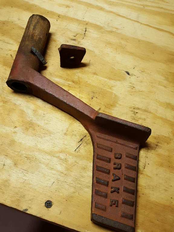

Drillbit 45 #22 Posted January 15, 2017 Well, I'm on my way with the tear down. Everything was going good. I've been noting the parts that I want to replace as I go. I had to do some welding to the steering column frame as i noticed that it was not painted on some parts from the factory and had rusted bad and cracked at the base. All good until I got in a hurry while trying to get the set collar off that holds the brake pedal on. I decided to use a hammer on the pedal linkage tab to get the set collar off. Broke it off. Gosh ,darn, I said politely since no one was listening (lol). This is cast iron. I hope I can get a good weld on it. Cast is not very easy to weld. 2 Share this post Link to post Share on other sites
Walt 339 #23 Posted January 15, 2017 When repairing cast iron in the stamping and forging press repair industry we would cut v's and fill with brazing rod. Not sure how well it would work on something that thin tho. Share this post Link to post Share on other sites
BOB ELLISON 2,981 #24 Posted January 15, 2017 You can post in the wanted column for a replacement and someone has one. Go down to Classifieds / wanted section and post for a break pedal. 1 Share this post Link to post Share on other sites
