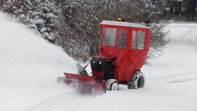

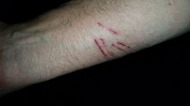

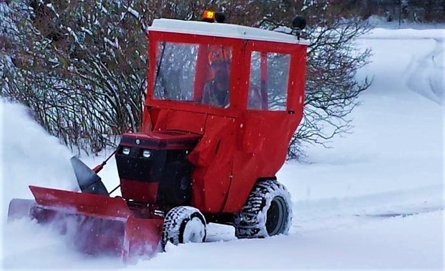

WHX?? 55,451 #1 Posted December 11, 2016 So this new to me cab reared up and bit me a little......the zipper on the left side that you have to reach thru to turn the chute did a little abrasive work on my arm. Lesson learned button down yer sleeve or wear gauntlet style gloves! Have had worst injuries via the rolling pin but still could have been avoided. Was so nice & cozy in ther no jacket! Plan to extend it into the cab but a 2 stage is in the future. Excuse me right side... 12 Share this post Link to post Share on other sites

WHX?? 55,451 #5 Posted December 12, 2016 I was havin so much good seat I never even noticed I got bit till I got her back in the shop!!! Share this post Link to post Share on other sites

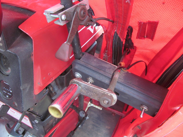

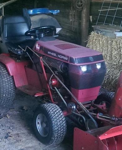

WVHillbilly520H 10,378 #10 Posted December 12, 2016 (edited) Ed I like that mechanical chute deflector control thanks for the tip and inspiration ,less $ and aggravation than the electronic styles in my opinion, and the solid stone deflector really helps with getting that snow up the chute as I've done that myself on my single then put it over on my 2stage and my here's my crank extension it too was on the single now on the 2stage ,Jeff. Edited December 12, 2016 by WVHillbilly520H 4 Share this post Link to post Share on other sites

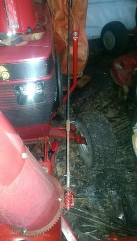

Ed Kennell 45,166 #11 Posted December 12, 2016 (edited) Yeah , it works well now Jeff. I used a throttle assembly off the old walk behind tiller that I converted to the front mounted MAD MAX tiller. I originally had the cable connected directly to the chute deflector and in that set up the cable had to be extended to close the chute against the force of the snow. This did not work very well as the cable assembly works much better at pulling than pushing. So I added the lever on the chute and now the chute closes fine when I pull the cable. Sorry, I didn't mean to hijack your thread Jim, but if you do something like this, hopefully this may help. I just noticed the picture was not the final version of the linkage. The pivot is now in the center of the lever and the cable is on the front end. Edited December 12, 2016 by Ed Kennell 1 Share this post Link to post Share on other sites

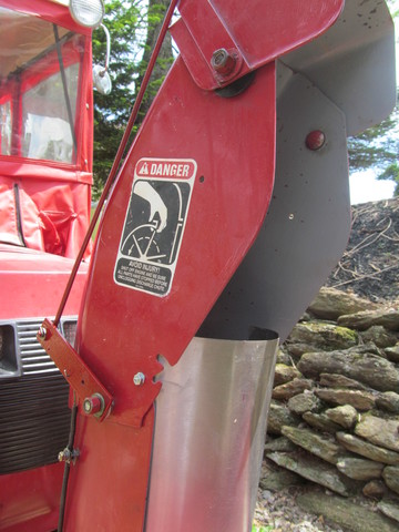

WHX?? 55,451 #13 Posted December 12, 2016 13 hours ago, WVHillbilly520H said: Ed I like that mechanical chute deflector That is a good idea Ed ...the short chutes don't have that kind of adjustability and what they do have is useless... right along with the cable chute rotator ...what a pain. I would like to just cut the crank off and add a 3/8" rod coupler to bring it in the cab. Trouble is the single piece crank arm on the right side singles moves quite a bit from up position to down and is hard to reach with the blower in the up position, even with the zippered opening all the way open. 1 Share this post Link to post Share on other sites

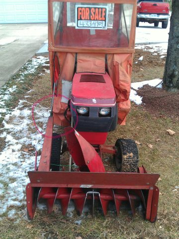

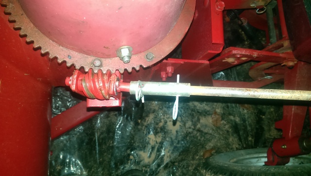

WVHillbilly520H 10,378 #20 Posted December 12, 2016 Jim, on your older single I would just cut the handle off above the washers/spring retainer (circled in pic of my 417 cab donor) then do a solid extension with the next size up pipe or metal tubing like I did with crank handle and it wouldn't need any extra support from the mid tach-a-matic, then on the 2 stage(unlike the tall chute single) there is no universal joint because of how the lift linkage works basically lifting it level to the grill/hood unlike the single pivoting in the front tach-a-matic, and my crank handle 3/8" diameter rod now measures 44" from the worm gear to the first bend inside the cab then approximately 3" 90° bend to another 90° bend 4" for your hand, basically just like the handle on the single, hope this helps,Jeff Share this post Link to post Share on other sites
