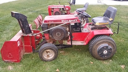

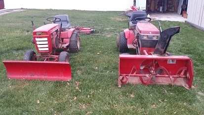

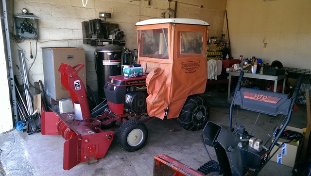

Redisbest 22 #1 Posted December 11, 2016 (edited) Do any of you know if there is presently anyone producing a 2 stage snowblower for older Wheelhorse...(314-8) ...I have an old single stage on a B 80 and a plow on an old hydro 876....that rig will push almost anything...I need a 2 stage for my 314...plenty of singles but 2 stage WH are hard to find around here(northern Michigan)...and was wondering if they are to heavy for a 314.... my dad has one on a 520H.....it's kinda hard to steer on that.... I've also had to do a lot of repairs on that snowblower over the yrs....I would like to put an after market one on if possible.... thanks Edited December 11, 2016 by Redisbest Share this post Link to post Share on other sites
WVHillbilly520H 10,378 #2 Posted December 12, 2016 First off if no one else has said so...To the best of my knowledge there was an aftermarket one (Berco/Bervac?) years ago but no longer in production, the 2stage is nice and can be run on your 314 as the one I bought last year the P.O. had used it on a 314 then a 315, and IMHO you would be just fine with a tall chute single stage as I have used mine from 2000 till last year on my 520 it will throw snow nearly as far as the 2stage ;easier to lift and steer; cheaper to repair, and easier to run with single cylinder Kohler, good luck on your endeavors,Jeff. Pic#1 tall chute single, #2 the 2stage you're familiar with (both on my 520H) and the Berco/Bervac? style on another member's rig. 3 Share this post Link to post Share on other sites
