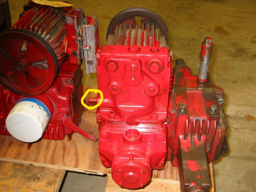

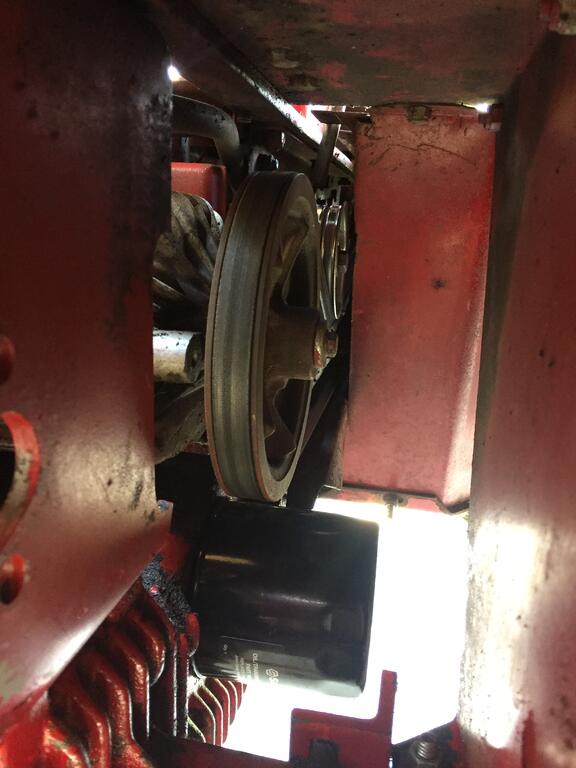

JimSraj 572 #76 Posted June 19, 2021 Sure looks like it’s the second picture. Mine is in the tractor so I can’t see all around it but the filler pipe is exactly as in your picture as well as the bolt pattern and pulley location. So where the heck is the tow valve? Share this post Link to post Share on other sites
pfrederi 20,305 #77 Posted June 19, 2021 IF (big if) it really is a piston to piston hydro (which means there was a big modification sometime in your GT14's life the tow valve would be the circled item. You really should take a picture of the left side of the transaxle so we can be sure what you have (Aim for the area circled in second picture) Share this post Link to post Share on other sites

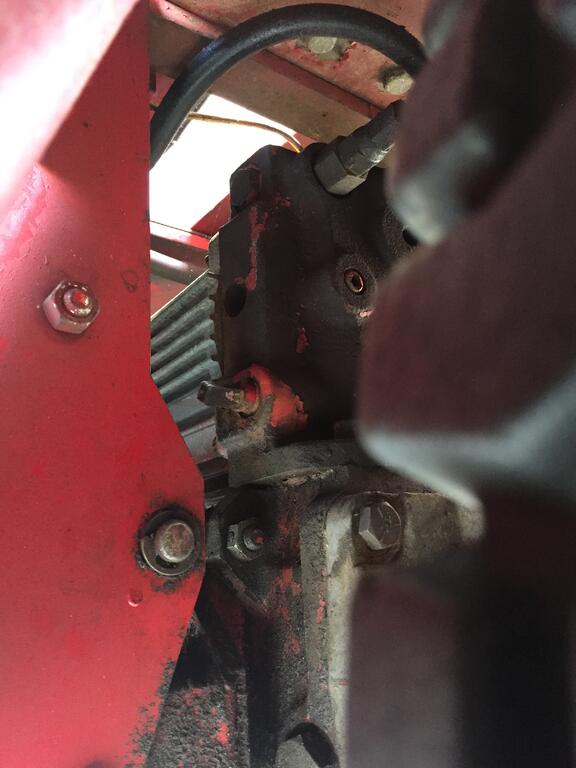

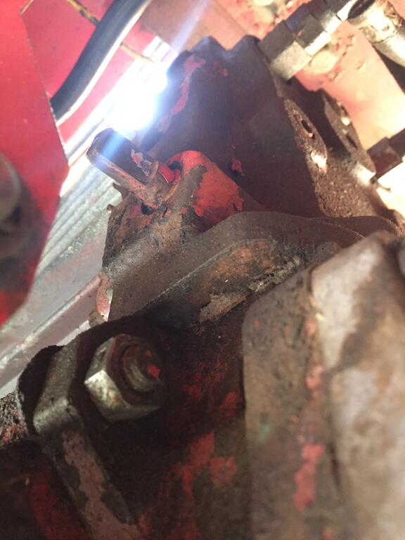

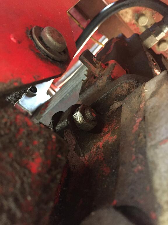

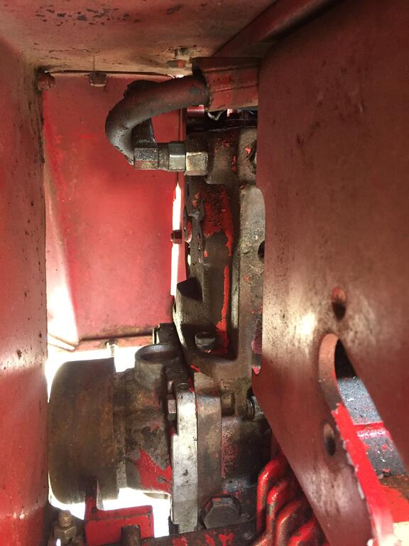

JimSraj 572 #78 Posted June 19, 2021 Ok so I took a few pictures and I’m pretty sure it’s the second one in the pics you sent. I believe you said piston to piston? First pic is looking up and toward the rear. Shows what I’m thinking is the tow valve. It’s got a square end. Second pic is just a better picture Used the old Horse to spread fertilizer and crabgrass suppressor before the rain. He’s got a little knock until warmed up. Once warmed up it disappears. Started working on the mower deck this afternoon. It had a couple poorly repaired cracks in one side of the mounting frame and it was bent out pretty badly. Managed to cut the braze out and get it pretty straight before welding. Considering welding in a reinforcement to keep it from moving again. Share this post Link to post Share on other sites

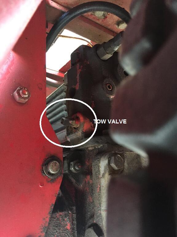

daveoman1966 3,882 #79 Posted June 19, 2021 The hyd power source of your GT-14 isn't original. A p.o. switched to a Sundstrand Pistoin-to-piston unit. Anyway, this is the tow valve.. 1 Share this post Link to post Share on other sites
JimSraj 572 #80 Posted June 19, 2021 Thanks again. I’m glad to know where it is even though I hope to never have to use it. Share this post Link to post Share on other sites
