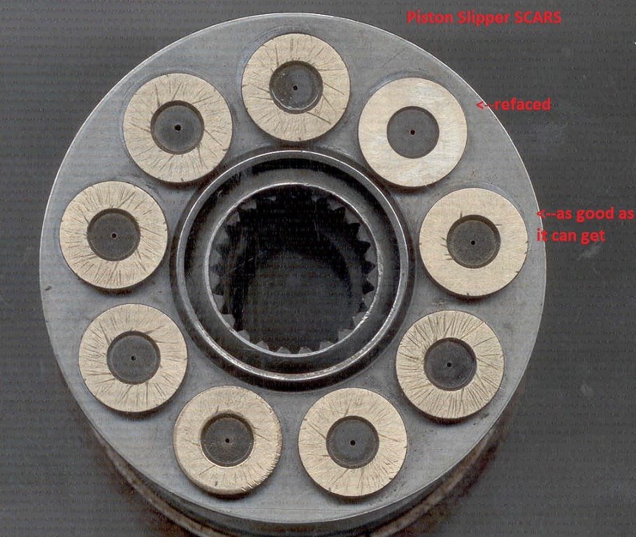

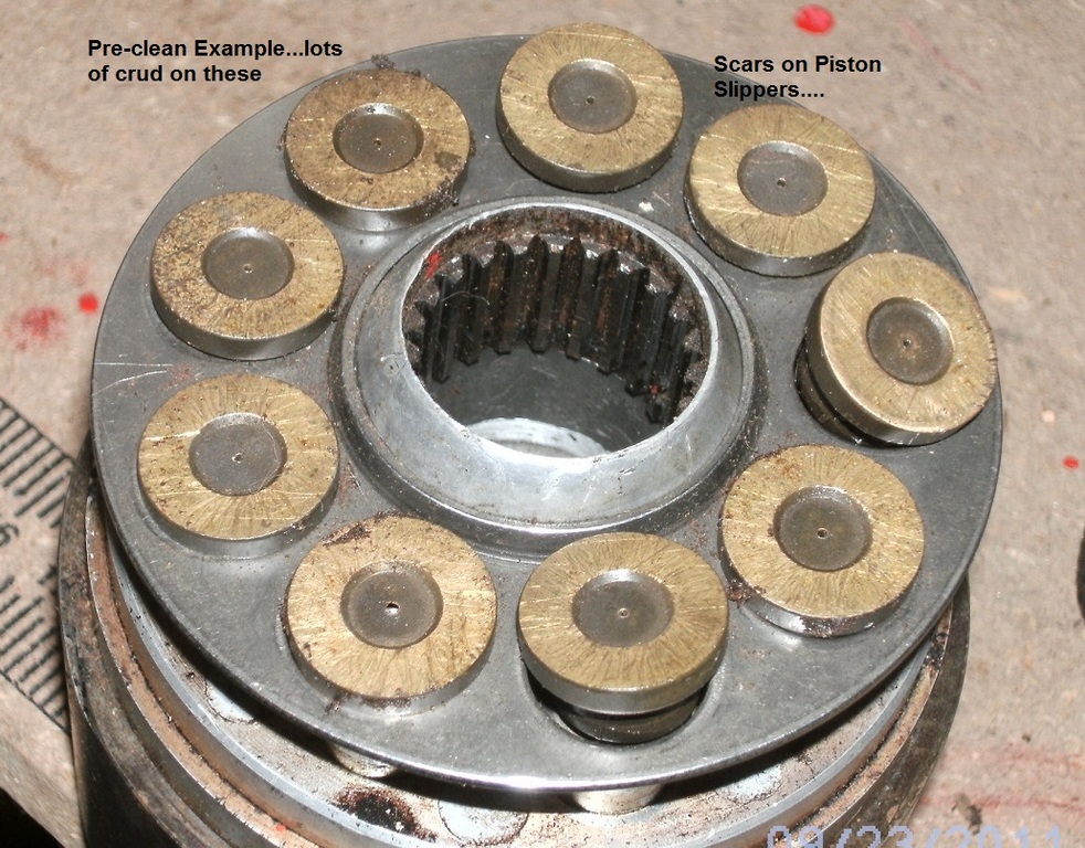

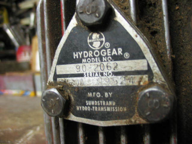

daveoman1966 3,884 #68 Posted March 9, 2017 The GT-14 Hydro-gear power unit is made by Sundstrand. Here is the tag. Here is also why your tractor has no power...the brass piston slippers are probably scored and need refinished. There are PROBABLY other issues as well and it'd be a good idea to pull hydro pump from the Hydro-gear to have a look-see. If your piston slippers are scored like this, MAYBE to just refinish them would solve your problems. If not, then there are other issues at hand. I have rebuild a few of these over the years and can provide pics internals and the issues you may encounter. 1 Share this post Link to post Share on other sites

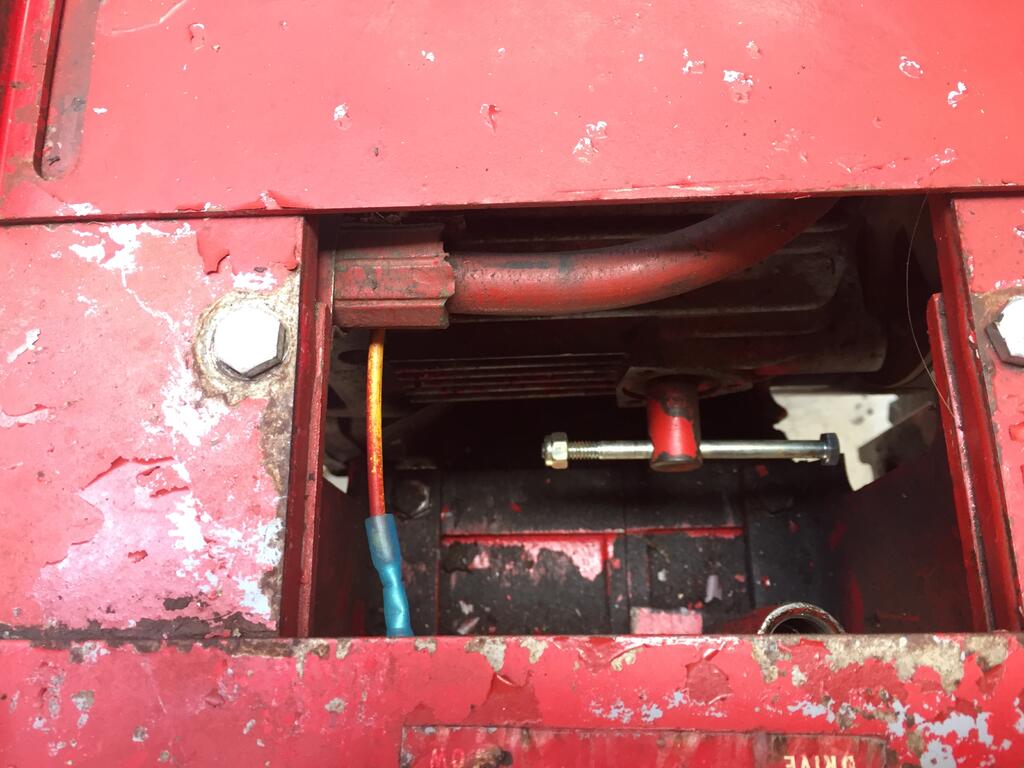

JimSraj 585 #69 Posted June 13, 2021 I’m gonna jump into this old thread Bri recent got a 1-7441 GT14 and I’m changing fluids, filters, etc. so I know when it was last done. Unless I’m missing something it looks like the tow valve on mine is on the rear of the transmission case. Anyone run into this? Share this post Link to post Share on other sites

JimSraj 585 #72 Posted June 14, 2021 I’ll try to get a picture of it ASAP. 1 Share this post Link to post Share on other sites

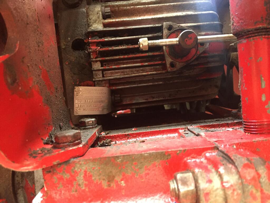

JimSraj 585 #74 Posted June 15, 2021 That’s a good possibility. I found the tag on the unit and it’s a 90-1173. Original was 20-2062 if my info is accurate. Changed the fluid today and found it was oil not trans fluid so replaced with 10-30. New Stens filter as well. Guessing whoever swapped out the unit converted to oil for whatever reason. I’ve attached a couple photos of the unit. View from the rear and the from the top. I added the bolt bc I wanted to see if I could move the valve. Probably going change it to a roll pin so it stays put. Thanks again! BTW, I see you are in NE PA, I’m just outside of Klecknersville in Northampton County. Share this post Link to post Share on other sites

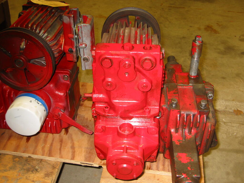

pfrederi 21,156 #75 Posted June 15, 2021 That is not the tow valve that is the opposite side of the motion control. 1173 wwere use on D series hydros and some C series hydros. The motion control shaft was out both sides as the C series mounted differently than the D series. This pump could be used in either one. It also would be piston to piston unit and I wonder if the hydro motor was changed out (if it was they had to change the drive gear. What does you hydro motor look like... #1 hydro gear (what came on GT-14) #2 Piston to piston.... 1 Share this post Link to post Share on other sites
