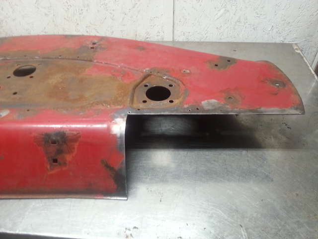

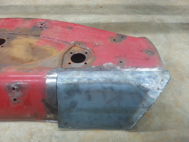

boesabot 20 #1 Posted December 8, 2016 I've decided that I am going to do a restore for my 42" deck has some bad metal so i have cut it out and plan on fabricating new gonna be slow process but its a start. Tough to find time between work and family I plan on leaving my tractor like it is with the exception of some mechanical and electrical replacements wiring ignition system and worn bearings fuel lines ect. I will continue to up date as I make progress please feel free to leave feedback and ideas 2 Share this post Link to post Share on other sites

Ed Kennell 43,912 #4 Posted December 9, 2016 One thing I do when rebuilding decks is to add 1/16" thick bolting plates to the inside of the decks under all the bolts to spread out the load and prevent stress cracks. You can usually get two bolts in one plate and if the surface is flat maybe more. I cut the plates, clamp them in place and then scribe off the square holes. Then drill the holes on the drill press and file the corners out square. Of course all painting is done before final assembly. And to the 3 Share this post Link to post Share on other sites

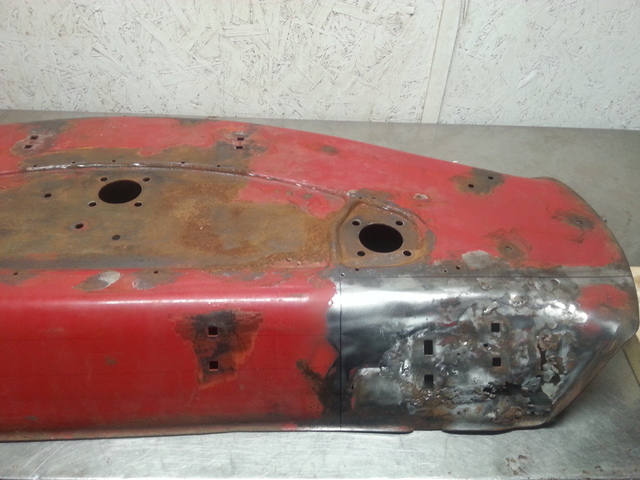

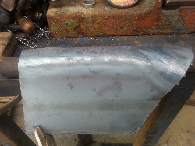

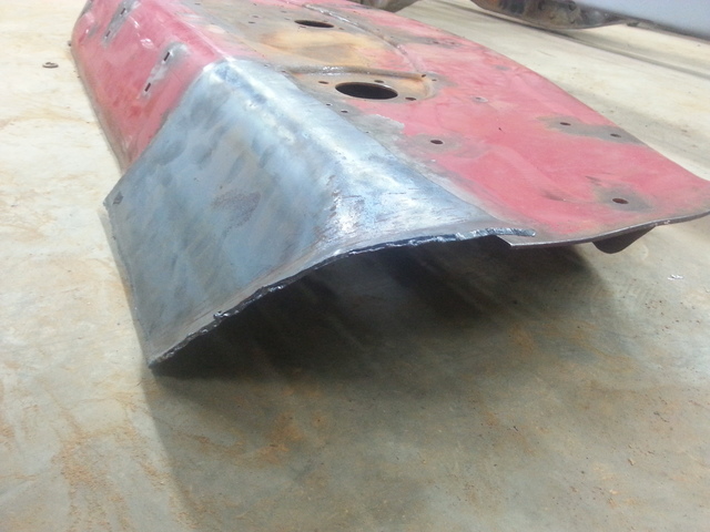

boesabot 20 #5 Posted December 9, 2016 Great idea I will definitely consider it got to make it more rugged. I made little progress this evening I got a rough pattern in place and trying to get it in shape it won't be identical but hopefully close enough for satisfaction. I would prefer to have a old deck and cut and piece but I figured I would try my hand 3 Share this post Link to post Share on other sites
Ed Kennell 43,912 #6 Posted December 9, 2016 Looks good. Share this post Link to post Share on other sites
Sarge 3,470 #7 Posted December 9, 2016 Here's a tip - don't flame cut sheet metal you plan to mold into a shape - you seriously risk cracking that hardened outside edge along the cut . Oxy system cutting produces an insanely hard edge that can become quite brittle as you try to work it . Just don't get in a rush to weld it on and spread that heat out very slowly - if you can't lay your hand on it you're going too fast . Sarge 1 Share this post Link to post Share on other sites

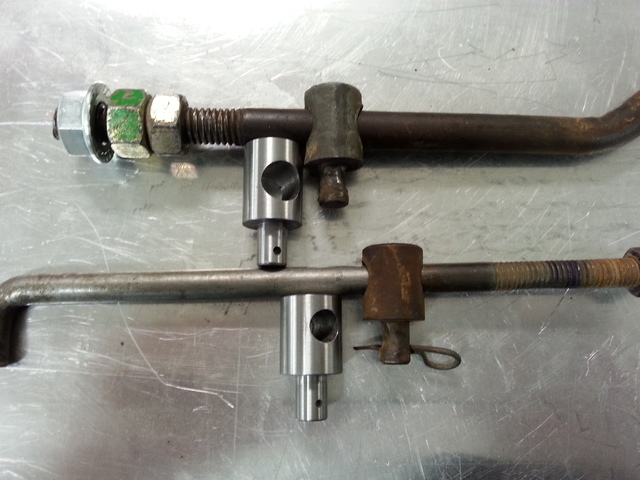

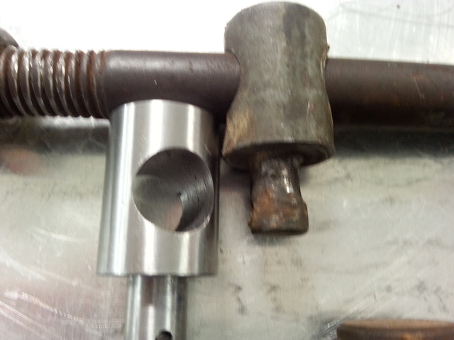

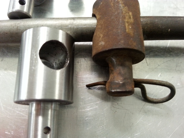

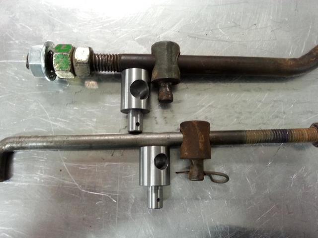

boesabot 20 #11 Posted December 10, 2016 Had a chance to finish the lift studs/hangers today 1 Share this post Link to post Share on other sites
Cole J. 71 #12 Posted December 18, 2016 Nice project, I'm going to eventually start working on my deck, so I will be interested in following your progress. Share this post Link to post Share on other sites
cleat 8,155 #13 Posted December 19, 2016 Did you make those trunnions ? They look perfect. Cleat Share this post Link to post Share on other sites
