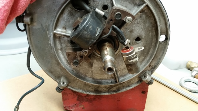

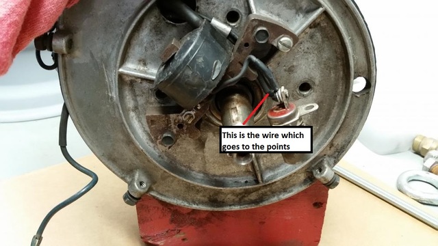

Racinbob 12,642 #2 Posted December 8, 2016 One goes to ground and the other to the condenser. The condenser has been removed from the holder in this picture. From the condenser it runs to the points and kill button. Check the resistance from the plug wire to one of the black wires. Use the 20,000 ohm scale. Ideally it should be under 6 ohms. 5 Share this post Link to post Share on other sites

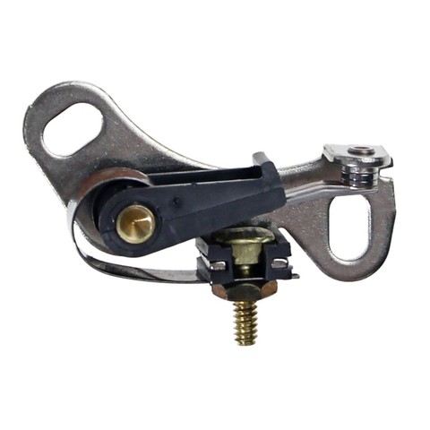

nigel 150 #3 Posted December 8, 2016 That's great but have you a pict of the points end please anyone Share this post Link to post Share on other sites

Racinbob 12,642 #6 Posted December 8, 2016 (edited) Hopefully somebody will come along with a picture for you. I really don't see how they could be wired wrong. There's only one terminal. You may have two wires going to it. One from the condenser and one for the kill switch. Try disconnecting the kill switch wire. If the coil checked out OK and what Chris suggested I would get a new spark plug too. I just grabbed this picture. The wire lands on the post pointing down. You probably have a screw rather than the post. Edited December 8, 2016 by Racinbob 1 Share this post Link to post Share on other sites
