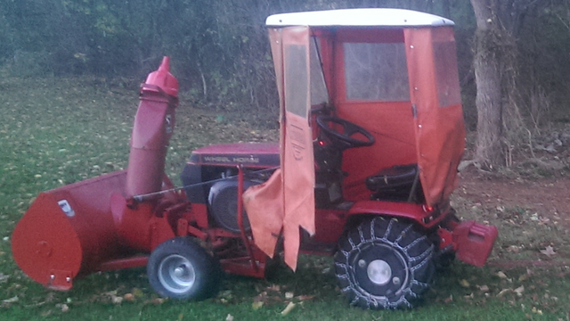

WVHillbilly520H 10,376 #6 Posted December 6, 2016 Kinda like this, fluild filled AG tires with chains,75# cast iron weights, 120+ # suitcase weights and a cab,Jeff. 3 Share this post Link to post Share on other sites

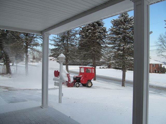

Ed Kennell 42,142 #7 Posted December 7, 2016 All weighted down and chained up. Only a 2" snow on Valentines day but Climbing a steep driveway. 3 Share this post Link to post Share on other sites

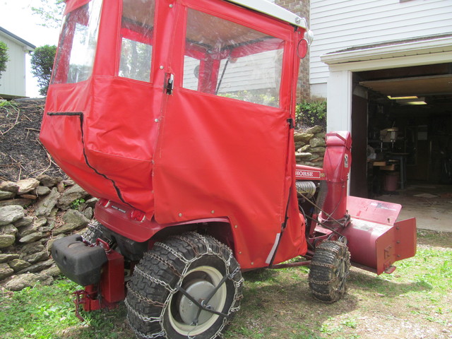

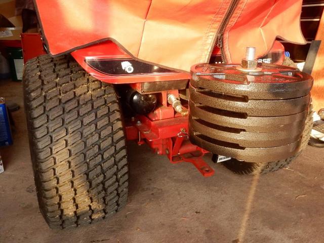

Kurt-NEPA 755 #9 Posted December 7, 2016 I would suggest chains and wheel weights (or loaded tires). But if you have a hitch may my solution will work 2 Share this post Link to post Share on other sites
