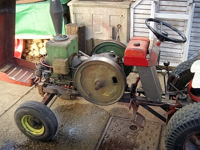

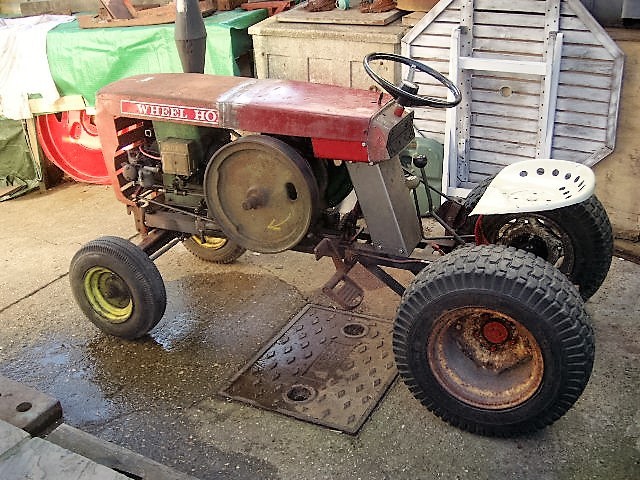

chris sutton 610 #1 Posted December 4, 2016 First drive of my wheelhorse fitted with a stationary engine. 20 Share this post Link to post Share on other sites
neil 2,410 #2 Posted December 5, 2016 British engineering at its best , nice job Chris 3 Share this post Link to post Share on other sites
Sparky-(Admin) 23,514 #3 Posted December 8, 2016 Love the way it sounds! Definitely needs a belt guard fabbed up. Mike.... Share this post Link to post Share on other sites

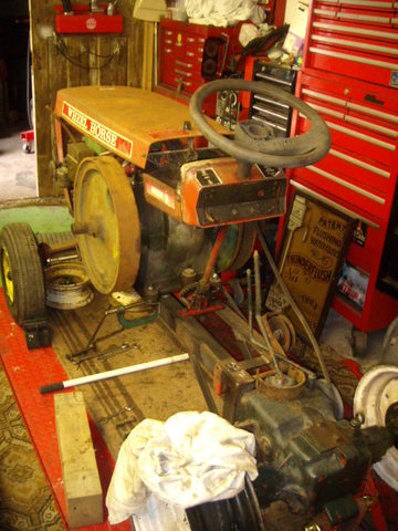

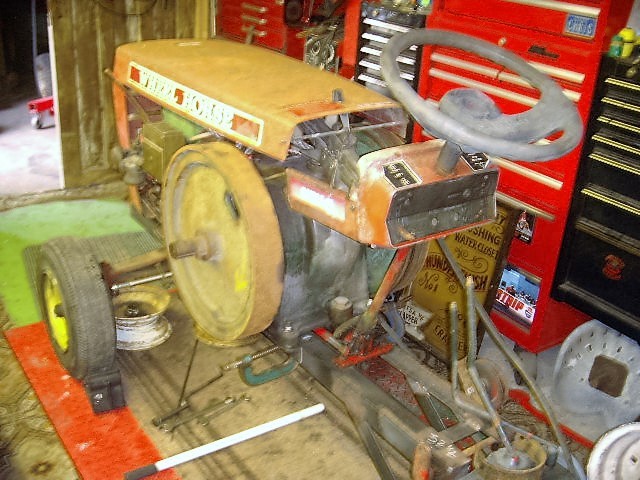

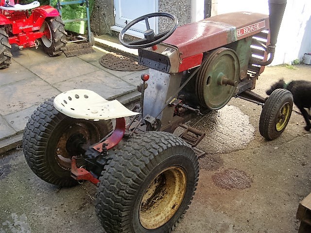

chris sutton 610 #4 Posted December 8, 2016 Just thought I would add a few words to the vid and how it came about. It all started when I made the trip to the Big show in PA and saw a couple of guys with Wheelhorse's with stationary engines fitted and loving the sound I had to have one. Mine started life as a Raider 10 but I had to make a new chassis 9" longer and extend the steering also weld 2 hoods together, the Engine is a 1948 Bradford 4 HP water cooled horizontal and runs through a 8 speed gearbox. I'll add photo's of the build as I come across them. 1 Share this post Link to post Share on other sites

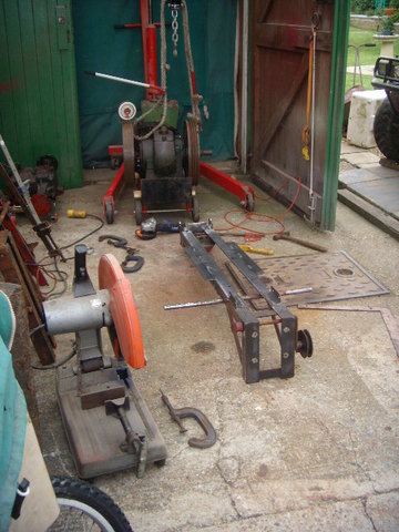

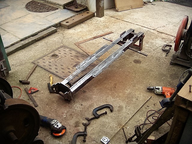

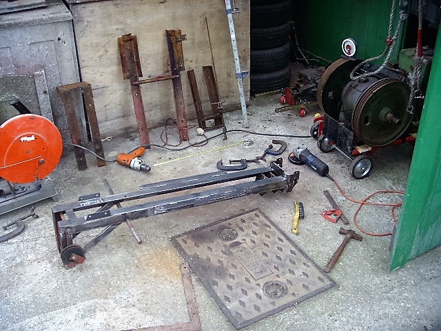

chris sutton 610 #5 Posted December 10, 2016 First job on the build was to extend the chassis but I decided to make a new one, Share this post Link to post Share on other sites

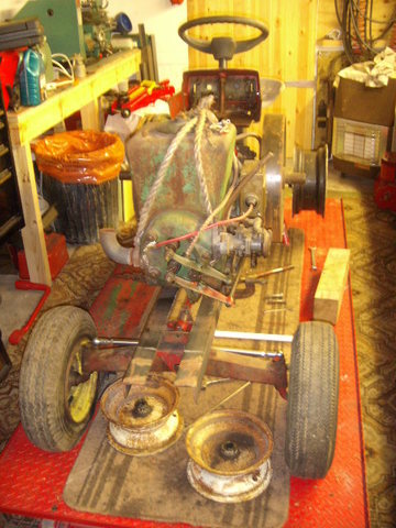

chris sutton 610 #6 Posted December 10, 2016 here's some more 2 Share this post Link to post Share on other sites
