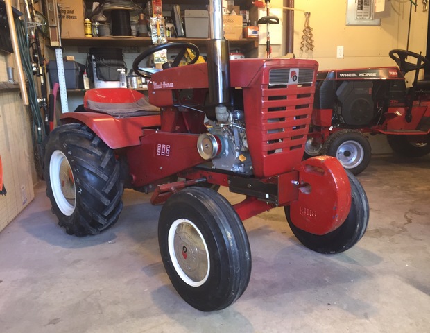

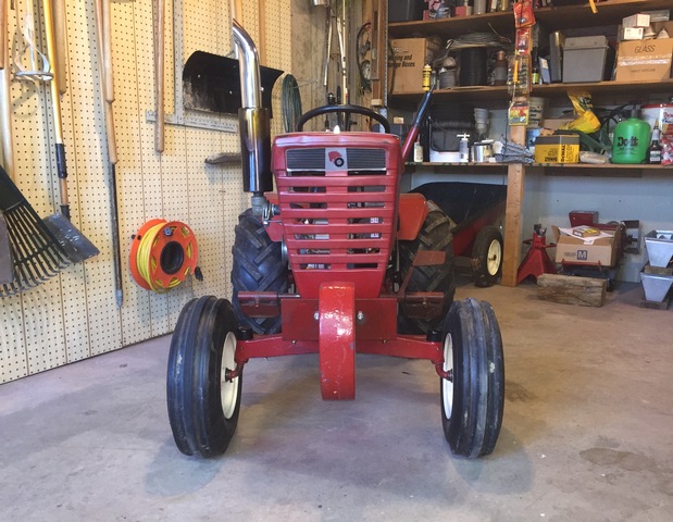

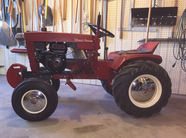

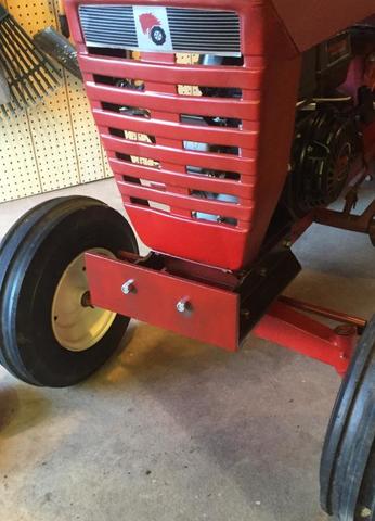

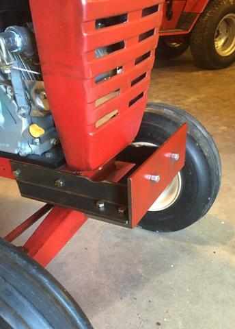

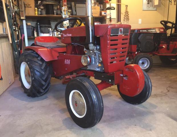

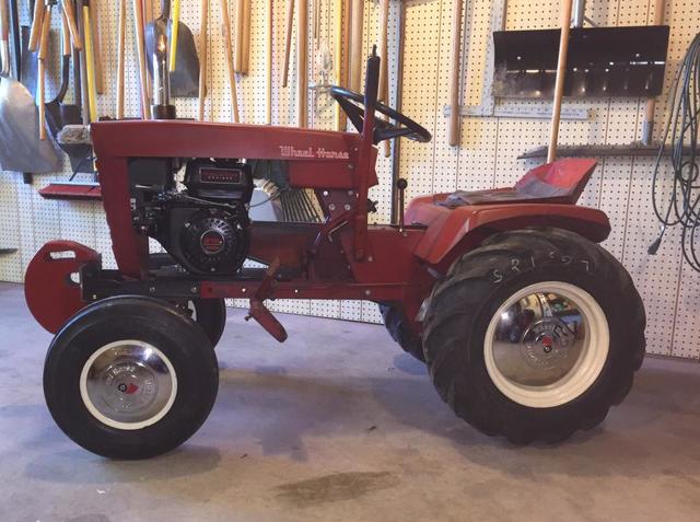

cschannuth 3,819 #28 Posted December 30, 2016 I had some time off over the holidays so I worked on the 606 a little. It was really light all the way around and almost impossible to keep the front on the ground so I loaded the rear tires and and bolted together a front bumper/weight hanger out of some scrap angle I had. I had an old weight I used on my 520 that fit the bill. To stay with the original paint/mild rat rod theme I decided to hit it with matte clear instead of painting it. The tractor definitely feels more planted. Other than reworking the seat I think I'm done. Although I may try to figure out a way to hang the generator on it. It uses almost no fuel compared to the 161 and the 314. 6 Share this post Link to post Share on other sites
T-Mo-(Moderator) 4,678 #29 Posted December 30, 2016 Looks great. I like the finish of the paint, or lack thereof. Nice job. 1 Share this post Link to post Share on other sites
cschannuth 3,819 #30 Posted December 30, 2016 28 minutes ago, T-Mo said: Looks great. I like the finish of the paint, or lack thereof. Nice job. Thanks. It's a fun little tractor and it's the only one I have without nice paint so I can really enjoy using it. 2 Share this post Link to post Share on other sites
WVHillbilly520H 10,376 #31 Posted December 30, 2016 (edited) Craig, great job on the front weight hanger (wonder what inspired you there also got something else waiting for you when you're ready), looks good on the 606, Jeff. Edited December 30, 2016 by WVHillbilly520H 1 Share this post Link to post Share on other sites
cschannuth 3,819 #32 Posted December 30, 2016 By the way, the beautiful stack muffler/pipe was hand crafted by Jim Kemp of this great forum. I loved the raw look of his great work so I tried some high temp clear as a coating. Even though I slowly cured it over a few days it still started to turn dark. I thought about painting over it but I really like the dark muffler so I'll probably leave it as is. I highly recommend jimkemp if you need a stack. It sounds great, it's reasonably priced, he will customize it, and it is really great quality. 7 Share this post Link to post Share on other sites

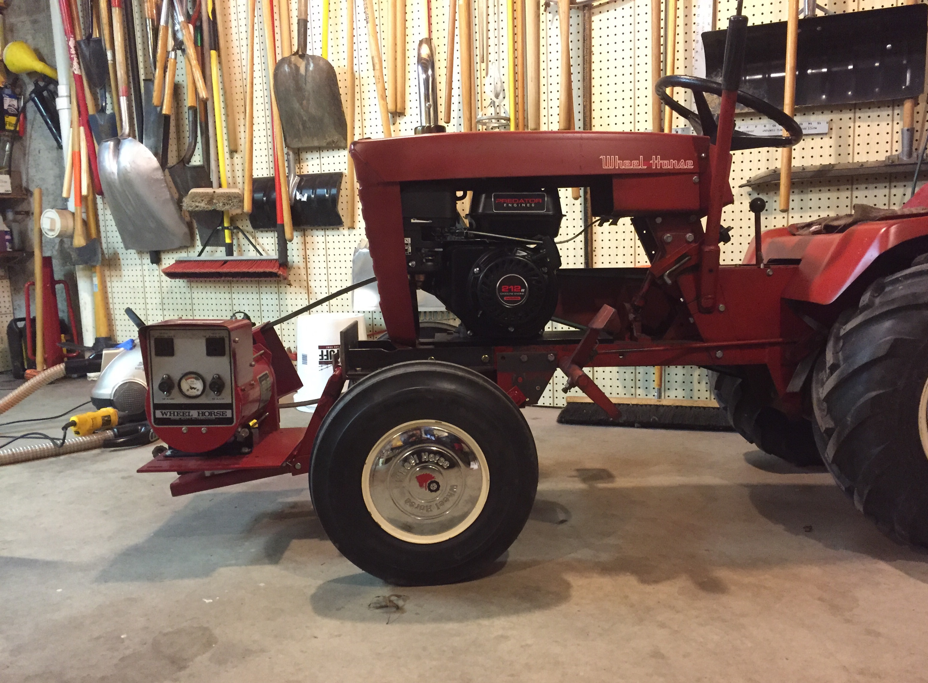

cschannuth 3,819 #36 Posted January 1, 2017 (edited) I showed this to my kids and my oldest son said I belong in a tree. I asked him why he said that and he said it was because I was a nut. I guess he's right. Once I got it in my head that I could make that generator fit on that 606 I had to give it a try. I turned around an attachamatic I had laying around and added some angle iron hooks on the front weight bracket and it lined up pretty well. The belt is too short but it worked ok so I tried it out. It pulled a shop vac and my grinder without too much trouble. Edited January 2, 2017 by cschannuth 1 Share this post Link to post Share on other sites
dclarke 4,111 #37 Posted January 1, 2017 Looks like it sits on there pretty well, Craig. Nice job! 1 Share this post Link to post Share on other sites

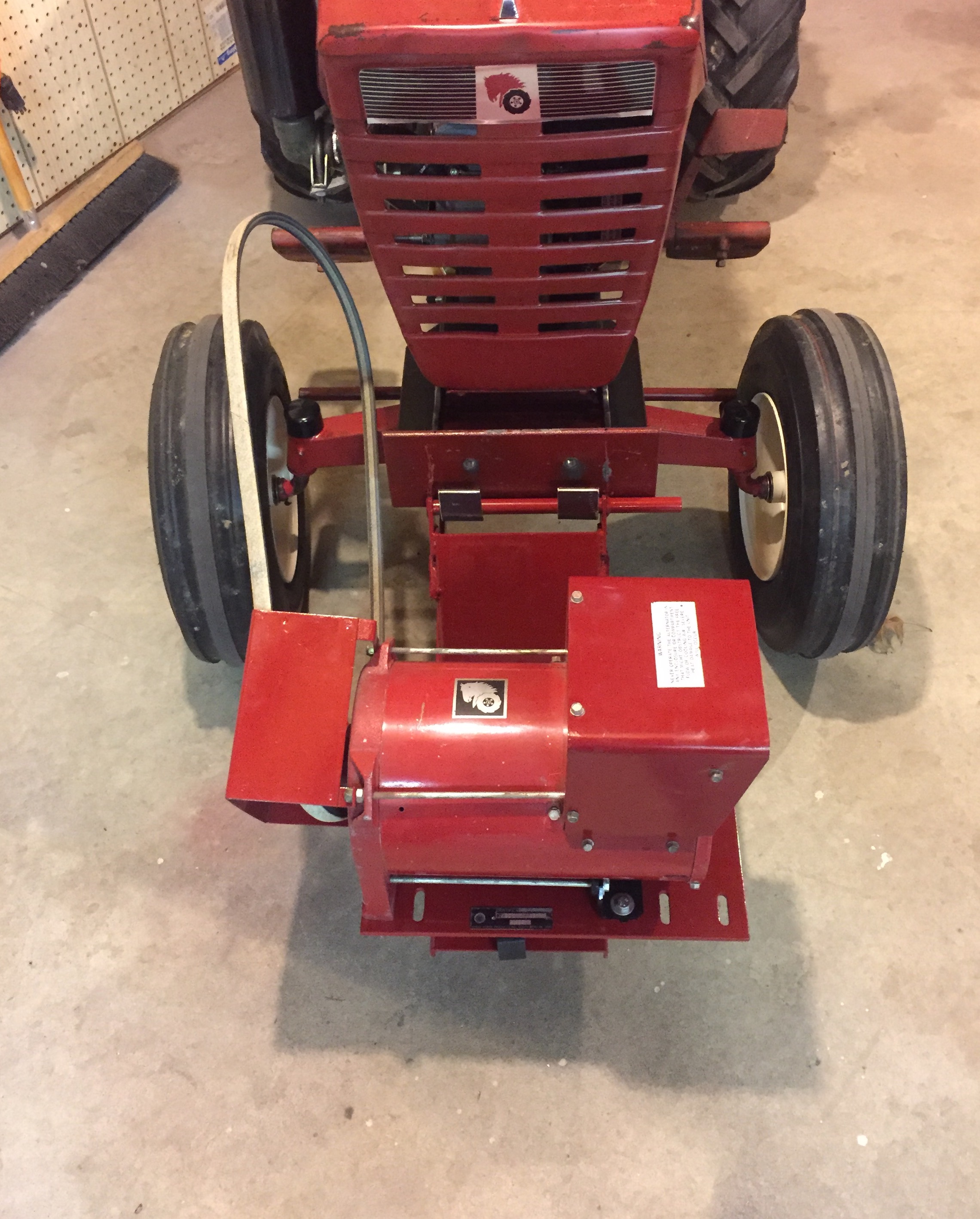

cschannuth 3,819 #38 Posted January 2, 2017 I still need to align the pulleys and get the correct belt but I think it'll work if needed. I'm a little concerned about the weight on the motor shaft but I can limit that with a block between the generator plate and the generator frame. Share this post Link to post Share on other sites
WVHillbilly520H 10,376 #39 Posted January 2, 2017 Way to go Craig, thinking outside the box, maybe just an idler pulley/spring tension set-up(like the snow blower) would be enough to keep the generator motor going set in a stationary position without too much stress on the engine crankshaft?,Jeff. 1 Share this post Link to post Share on other sites
oldredrider 2,553 #40 Posted January 2, 2017 I might suggest you use a snow blower lift tube to adjust and hold the generator in position to reduce stress on the engine pulley. 1 Share this post Link to post Share on other sites
