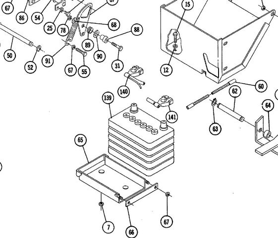

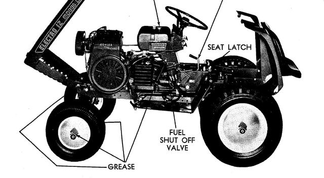

pfrederi 19,810 #10 Posted December 1, 2016 There are at least two sizes of battery box. I will measure them later. I just use some scrap wood to hold L&G batteries in the bigger boxes. Charger/Electro used the bigger box and i assume originally had an automotive style battery with top terminals. Pics ar from Electro12 manual...looks automotive to me. 2 Share this post Link to post Share on other sites
Ed Kennell 44,722 #11 Posted December 1, 2016 Yep, looks automotive, thanks Paul. Share this post Link to post Share on other sites
Racinbob 12,706 #12 Posted December 1, 2016 Excellent Paul. Is there any indication of the group size of those batteries? 1 Share this post Link to post Share on other sites

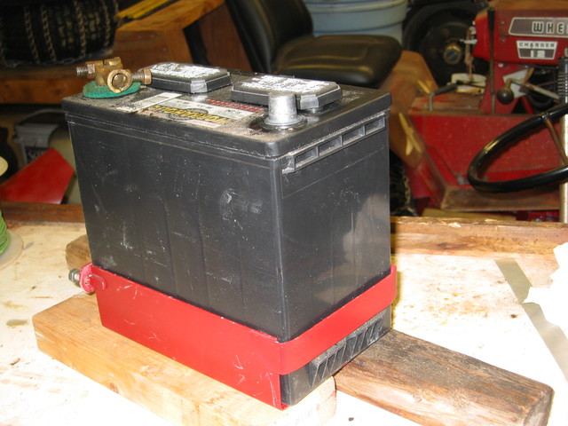

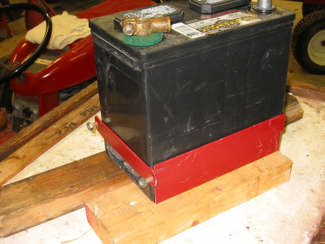

pfrederi 19,810 #15 Posted December 1, 2016 (edited) Charger/Electro Battery trays were 8-1/2 x 5-1/2. Newer style are about 7 x 5. Picture is a 22NF in the older bigger tray. it is 9-1/2 inches tall to top of terminal posts that would seem to clear the gas tank in my Charger and Electros. Based on that Grp 45 or 51 51R would seem to work also http://www.batteryweb.com/bci.cfm Pictures won't upload right now will try later Edited December 1, 2016 by pfrederi 3 Share this post Link to post Share on other sites

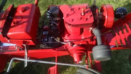

Achto 30,895 #16 Posted December 1, 2016 5 hours ago, Racinbob said: I'd like to see pictures of the automotive battery installed. From 1960 to the end in 2007 I've never seen one Here's a pic of my 1076 with an auto battery in it. 2 Share this post Link to post Share on other sites
pfrederi 19,810 #17 Posted December 1, 2016 is the negative terminal on the PTO side of the tractor? Share this post Link to post Share on other sites
Achto 30,895 #18 Posted December 1, 2016 1 minute ago, pfrederi said: is the negative terminal on the PTO side of the tractor? Yes. This tractor was really bad when I got it but was untouched as far as modifications. I did my best to put every thing back to the way it was. Share this post Link to post Share on other sites
