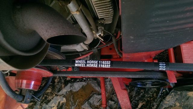

Pat Marchwick 93 #1 Posted November 30, 2016 I have a 44" two stage blower on a 520h . Works fine but would like a spare belt. I looked thru the operators manual and it does not say what the belt size is and to one on the machine has worn off the markings. I am a fair distance from a good parts store and would like to pick one up on my next trip to a larger city. Thank you Share this post Link to post Share on other sites
WVHillbilly520H 10,376 #2 Posted November 30, 2016 It's actually a weird size 5/8"wide x 64.5" long if you go with tractor supply I would go 5/8"x64" but try eBay or other online retailers and get the Toro/WH belt IMHO it'll last longer,Jeff. 2 Share this post Link to post Share on other sites
gwest_ca-(File Mod) 11,521 #3 Posted November 30, 2016 The drive belt has been added to this page Drive belt 116332 (HB x 64.50" or 5/8" x 64.5") If you have the 79361 model get the correct parts lists determined by serial number as there subtle differences in them. The belt used is the same for all of them. Garry 3 Share this post Link to post Share on other sites
