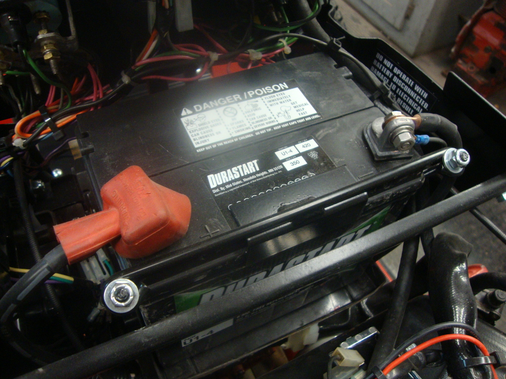

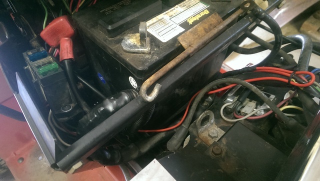

lynnmor 9,064 #26 Posted December 30, 2016 OK, I'm a critic, that battery clamp scares me. If it were to move forward, or the battery back a bit, things could get ugly real fast. The original went over the front corner with a piece of angle to keep it in place. 1 Share this post Link to post Share on other sites
dclarke 4,274 #27 Posted December 30, 2016 9 minutes ago, lynnmor said: OK, I'm a critic, that battery clamp scares me. If it were to move forward, or the battery back a bit, things could get ugly real fast. The original went over the front corner with a piece of angle to keep it in place. That thought's crossed my mind too, the original clamp was missing and I had this laying around so I stuck it on there. I probably should get the correct one. Thanks for reminding me. Share this post Link to post Share on other sites
WVHillbilly520H 10,379 #28 Posted December 30, 2016 1 hour ago, dclarke said: That thought's crossed my mind too, the original clamp was missing and I had this laying around so I stuck it on there. I probably should get the correct one. Thanks for reminding me. Maybe this will help you fab up one instead of buying,Jeff. 2 Share this post Link to post Share on other sites
bulletbob 1 #29 Posted December 30, 2016 extremely nice work! 1 Share this post Link to post Share on other sites
dclarke 4,274 #30 Posted December 30, 2016 (edited) 6 hours ago, WVHillbilly520H said: Maybe this will help you fab up one instead of buying,Jeff. Thanks, Jeff. That looks easy enough to make but I lost access to a welder when I retired a few months ago, until I convince the management around here that I need one it's just easier to buy the hold down. I appreciate the help though. Edited December 30, 2016 by dclarke 8 Share this post Link to post Share on other sites

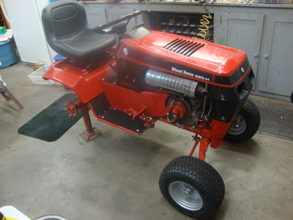

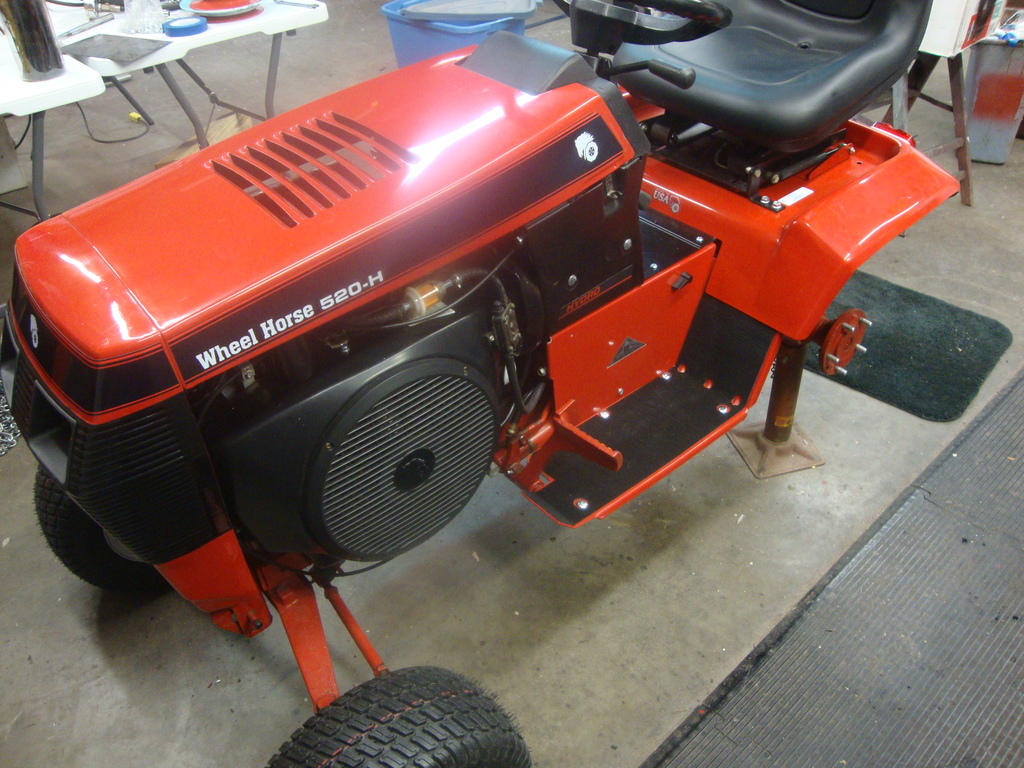

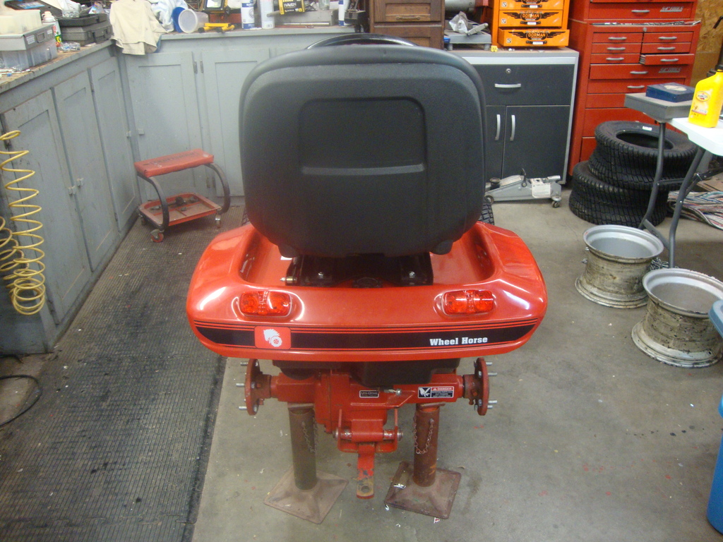

dclarke 4,274 #34 Posted January 2, 2017 The last few days I've got a little more done on this 520, I got new bearings and a seal put in the PTO and got it back on. I've also got the tins buffed out, the footrest pads glued on, the black on the front of the hood repainted and got those mounted and have started putting the new decals on. Now to get those rear rims blasted and painted. 14 1 Share this post Link to post Share on other sites

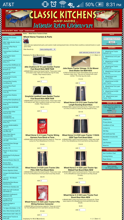

GMan 82 #37 Posted January 3, 2017 Denny, If you don't mind me asking, where did you get the replacement "footrest pads" that you just installed? I have a unit that needs them replaced too! Thanks in advance...........Gary Share this post Link to post Share on other sites
dclarke 4,274 #38 Posted January 3, 2017 12 minutes ago, GMan said: Denny, If you don't mind me asking, where did you get the replacement "footrest pads" that you just installed? I have a unit that needs them replaced too! Thanks in advance...........Gary I got them from Eldon at classickitchensandmore.com....... Scroll down towards the bottom of his web page and you'll see Wheel Horse parts. 1 Share this post Link to post Share on other sites
WVHillbilly520H 10,379 #39 Posted January 3, 2017 (edited) Maybe this helps with the footrest pads...thanks Denny... Edited January 3, 2017 by WVHillbilly520H 2 Share this post Link to post Share on other sites

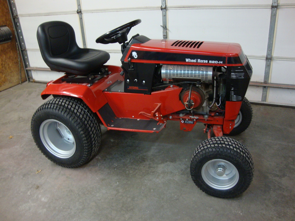

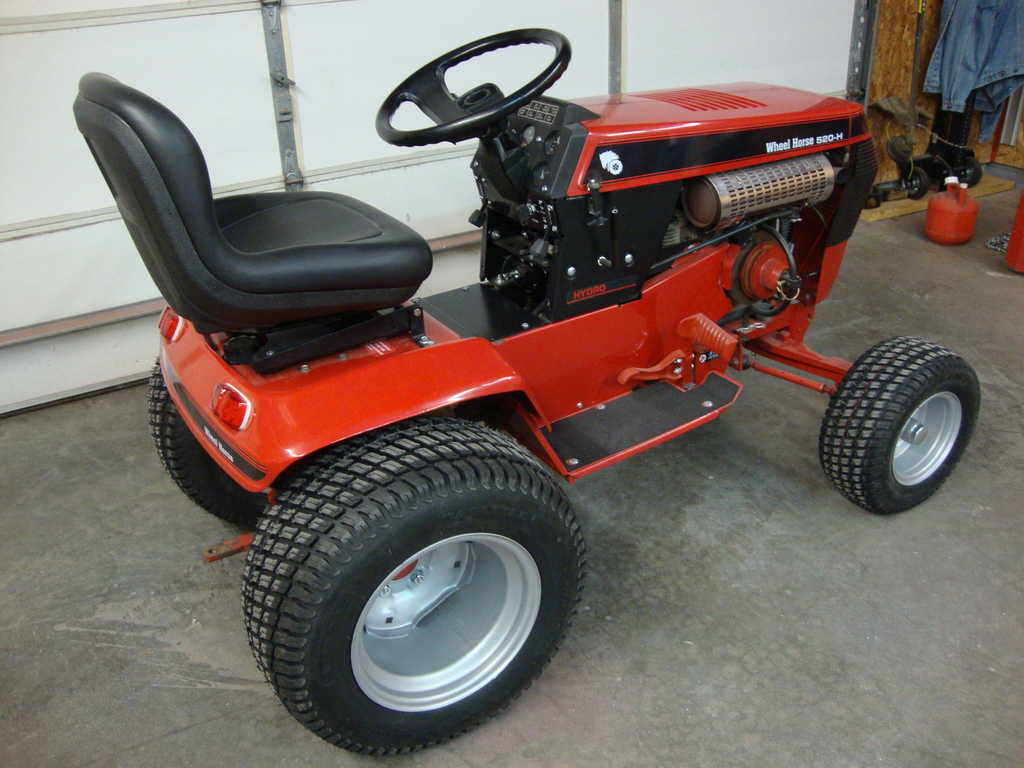

dclarke 4,274 #46 Posted January 8, 2017 Well, I'm getting closer to having this back together. I've got the rear tires on and now have the correct battery hold down installed and a set of LED tail lights. I've still got to paint a cover plate for the dash tower, put the rest of the decals on and get a steering wheel insert from Glen. I found out the alternator wasn't charging and a new rectifier regulator fixed that. Next week I need to take it outside and warm the engine up good so I can torque the head bolts again and I'll need to fine tune the foot pedal linkage....... I painted the rims Argent Silver from Eastwood's. Do you guys spray a clear coat over that and if you do what do you use? 16 1 Share this post Link to post Share on other sites
