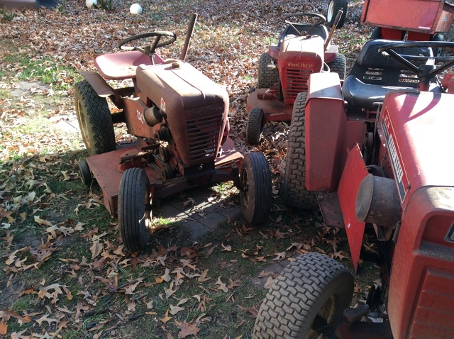

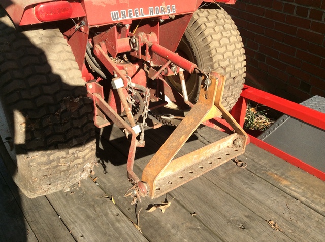

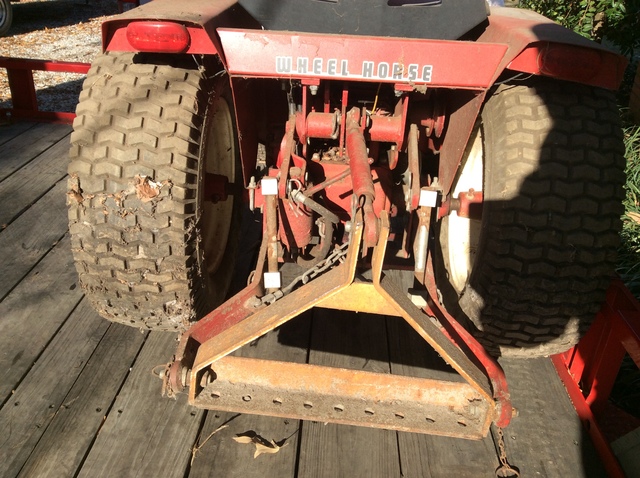

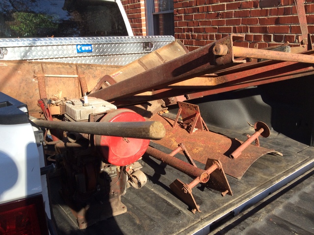

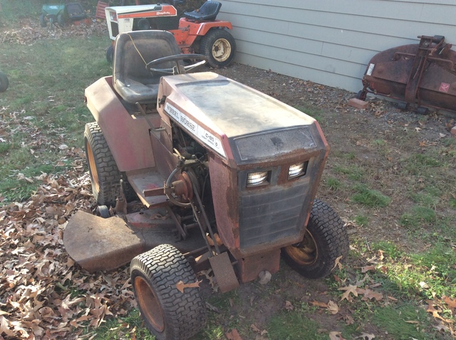

limited12 360 #1 Posted November 27, 2016 (edited) I have always heard there was no cure for the wheel horse fever, i now believe Made another haul today, and looks like i might need to make a couple more later Todays pick up GT-14 with 3 point hitch, ny other two did not have this pump on the rear, can some one tell me what this was Nice unmolosted 704 all origanal Little lawn ranger with remanufactor engine C-85 rough but ok 2 short frame blades 1 rj snow plow 14 hp kohler Edited November 27, 2016 by limited12 17 Share this post Link to post Share on other sites
953 nut 61,717 #2 Posted November 27, 2016 7 minutes ago, limited12 said: pump on the rear, can some one tell me what this was Don't see a pump, but you do have an independent lift cylinder so a mower and a tiller could be mounted and operated independently. Pretty sure it is home brewed but a great idea. Nice Haul, guess I should tell everyone I am getting out of the hobby so a whole herd would follow me home. 3 Share this post Link to post Share on other sites

C-101plowerpower 1,606 #5 Posted November 27, 2016 1 hour ago, 953 nut said: Don't see a pump, but you do have an independent lift cylinder so a mower and a tiller could be mounted and operated independently. Pretty sure it is home brewed but a great idea. Nice Haul, guess I should tell everyone I am getting out of the hobby so a whole herd would follow me home. looks like it might have come from a d series 1 Share this post Link to post Share on other sites
KC9KAS 4,744 #6 Posted November 27, 2016 If that is a GT-14, that is the correct setup for the independent 3 point lift. I have one like it! 2 Share this post Link to post Share on other sites

KC9KAS 4,744 #8 Posted November 28, 2016 (edited) If the GT-14 still has the mid lift cylinder AND the back 3 point lift cylinder there should be 2 lift valves. The mid mount would have been the valve to the right of the forward/reverse motion control. The "optional" 2nd cylinder valve would have had and extension to and through the left side of the tunnel. The handle would have been on the left side of the tunnel. I actually mounted mine in the tunnel to the left of the motion control lever. It is somewhat crowded there, but it is done! I have photos, but Photobucket is not cooperating right now! Edited November 28, 2016 by KC9KAS spelling 1 Share this post Link to post Share on other sites
limited12 360 #9 Posted November 28, 2016 Thanks guys 49 minutes ago, KC9KAS said: If the GT-14 still has the mid lift cylinder AND the back 3 point lift cylinder there should be 2 lift valves. The mid mount would have been the valve to the right of the forward/reverse motion control. The "optional" 2nd cylinder valve would have had and extension to and through the left side of the tunnel. The handle would have been on the left side of the tunnel. I actually mounted mine in the tunnel to the left of the motion control lever. It is somewhat crowded there, but it is done! I have photos, but Photobucket is not cooperating right now! I do have two lift valves 2 Share this post Link to post Share on other sites
