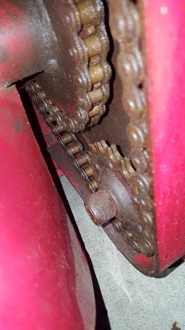

dirtnap 39 #1 Posted November 26, 2016 (edited) Today I got a chance to put my new to me snowthrower on my 'horse today. The stud on the lift flag had worn almost half-way through so I ground off the weld on the back side and happened to have an exact match that I welded on. Everything else went smoothly and all the bearings seem real tight except for the bottom sprocket pictured here. It's got a fair amount of play in it. I have the manual but not a part diagram. Is it part 93-1614? Are these sprockets still available online? How about the chains? Edited November 26, 2016 by dirtnap Share this post Link to post Share on other sites
Walt 339 #2 Posted November 26, 2016 Believe the sprocket is available as for chain it is cheaper to go to TSC or motion industries over ordering from TORO. In a 10' box of #40 chain you will get enough to replace it twice for for around half the cost. 3 Share this post Link to post Share on other sites
Eric C 109 #3 Posted November 27, 2016 Yes. The sprockets are pn 93-1614. I just ordered 2 yesterday from mowpart.com. 1 Share this post Link to post Share on other sites
