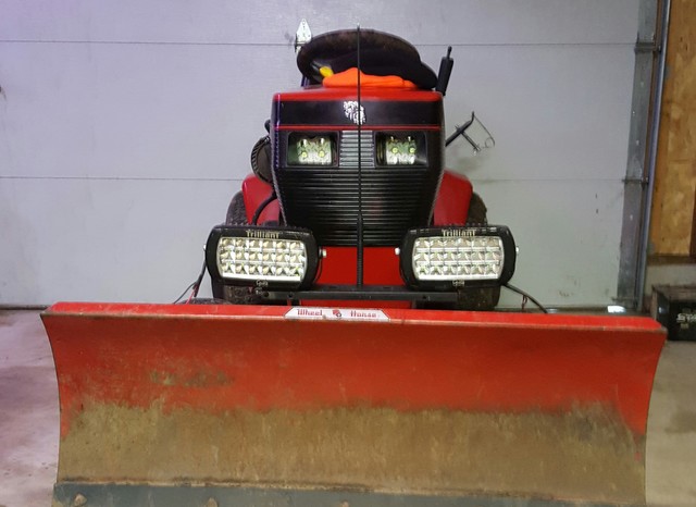

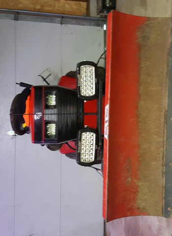

koalassquad 27 #7 Posted November 28, 2016 I made an extended plate, and put a second battery in my 314-8 for my LEDs. 3 Share this post Link to post Share on other sites
