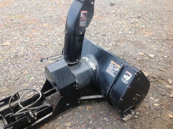

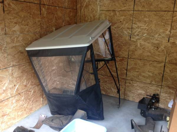

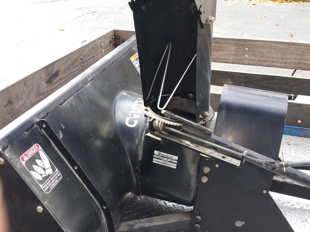

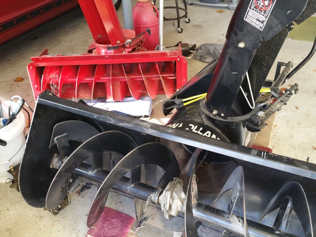

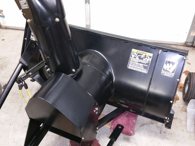

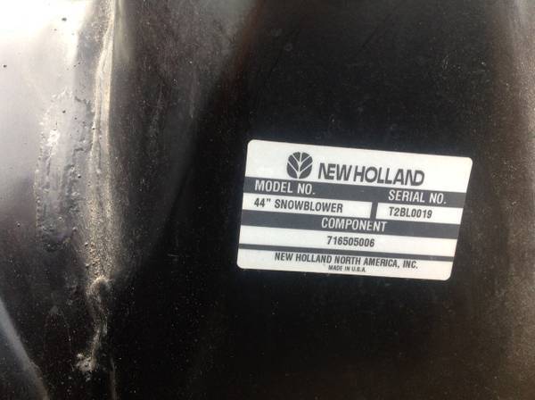

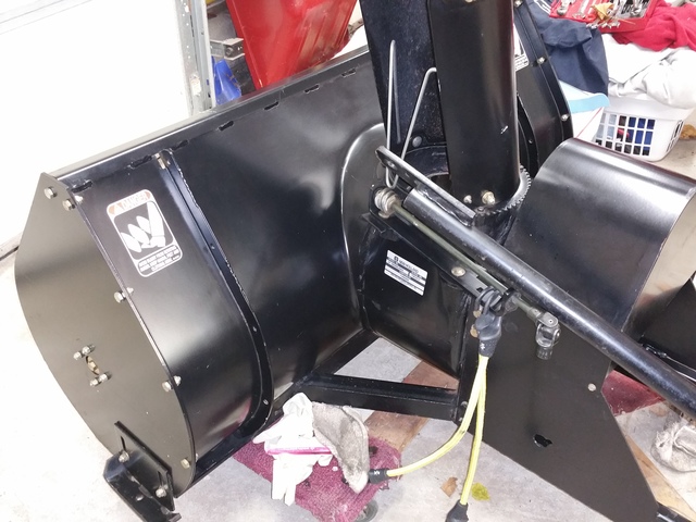

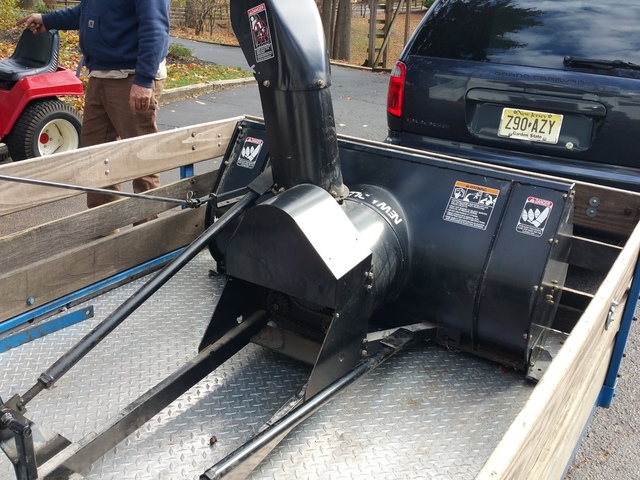

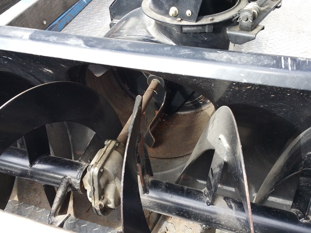

JERSEYHAWG / Glenn 4,498 #1 Posted November 23, 2016 (edited) Ok, I got my New Holland 2 stage and cab home today. Its going on the 522xi. I would like to have an extra belt around and maybe a extra chain. This came off an 80 hour machine I dont anticipate problems, but thats when you get bit. These were made by toro wheel horse for new holland. Identical but for the paint color. There is a picture with model / serial number. Who knows where to get these items? we all luv pictures, so here are a few, I have plenty of dirt to clean off them, and some touch up to do. These 2 stage xi units are BIG....... oh, and a fwiw, my mint used twice and not by me xi single snowthrower will be in the classified shortly, WITH my xi blade. keep your eyes peeled. I dont need 4 snowblowers and 4 blades. Enjoy and thanks for any help. Glenn oh, and for a laugh, the jumbo dolly I made,,,and NEVER used it for the 2 stage ,, Edited November 23, 2016 by JERSEYHAWG / Glenn 4 Share this post Link to post Share on other sites
doc724 925 #2 Posted November 23, 2016 Glenn, the WH equivalent two stage blower for 5xi is 79366. Belt is 1004164. $56 from Jack's Small Engines 1 Share this post Link to post Share on other sites

DennisThornton 4,771 #9 Posted November 24, 2016 That blower looks way different than the memory of what I bought for my 522xi... 1 Share this post Link to post Share on other sites
gwest_ca-(File Mod) 11,430 #10 Posted November 24, 2016 Every once in a while I run across Toro numbers with the New Holland equivalent in Toro manuals. From those have leaned the 2 in the T2BL0019 serial number is the model year. The 716505006 Component number is their model number. Garry 1 Share this post Link to post Share on other sites
JERSEYHAWG / Glenn 4,498 #11 Posted November 24, 2016 (edited) 17 hours ago, DennisThornton said: That blower looks way different than the memory of what I bought for my 522xi... Dennis, what's differant? Or should I tell you when it won't mount up. Edit: Dennis, did you get a 2 stage to? You can see my xi single in the background. 2 differant beasts in mounting and hardware. Glenn General question for 2 stage owners reading this, while going through the manuals, checking chain tension, zerks, oiling spots etc. One of the manual pages shows zerks, or oiling, the bearings from the front of the auger housing on the left and right side of the auger. I looked pretty good. I don't see any zerks to get those bearings, what the heck are they talking about? Edited November 24, 2016 by JERSEYHAWG / Glenn Added xtra stuff Share this post Link to post Share on other sites

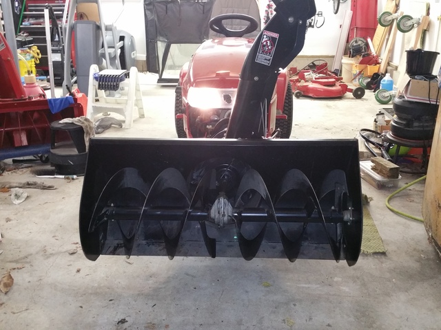

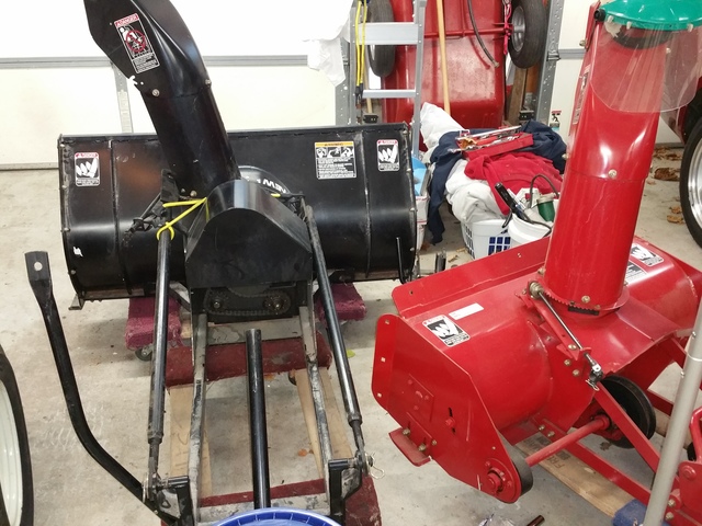

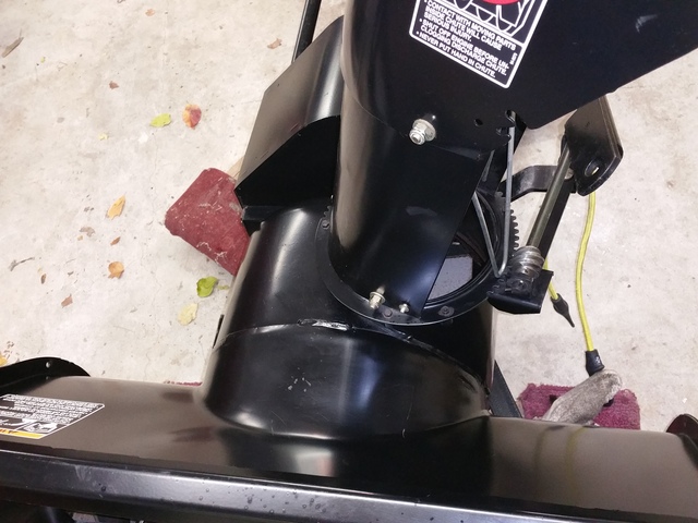

JERSEYHAWG / Glenn 4,498 #12 Posted November 24, 2016 rust spots sanded, painted up, waxed up, cleaned up, pre season maintainence items being done, getting ready to mount. oh, pulled new holland decal off. looking for a wheel horse decal I got laying around here to put on. shes cleaning up good. Glenn 1 Share this post Link to post Share on other sites
DennisThornton 4,771 #13 Posted November 24, 2016 2 hours ago, JERSEYHAWG / Glenn said: Dennis, what's differant? Or should I tell you when it won't mount up. Edit: Dennis, did you get a 2 stage to? You can see my xi single in the background. 2 differant beasts in mounting and hardware. Glenn General question for 2 stage owners reading this, while going through the manuals, checking chain tension, zerks, oiling spots etc. One of the manual pages shows zerks, or oiling, the bearings from the front of the auger housing on the left and right side of the auger. I looked pretty good. I don't see any zerks to get those bearings, what the heck are they talking about? Maybe it's just the color that's throwing me off or my poor memory but the 2 stage I bought came off a 522xi for sure. I'll have to be looking at mine soon anyway since I just cleared off 2" of not so fluffy white stuff with my C-85 and blade. Guess it's time to get the bigger one running too! This snow was for the blade and not the blower! 1 Share this post Link to post Share on other sites

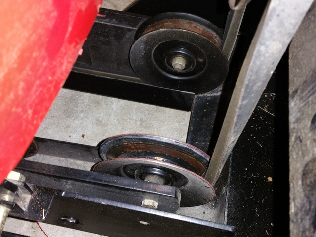

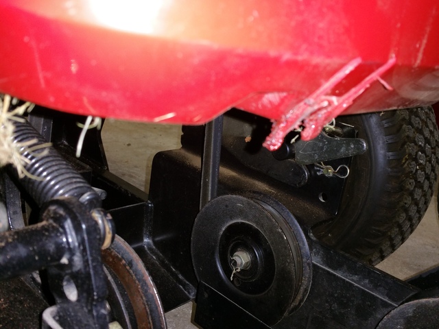

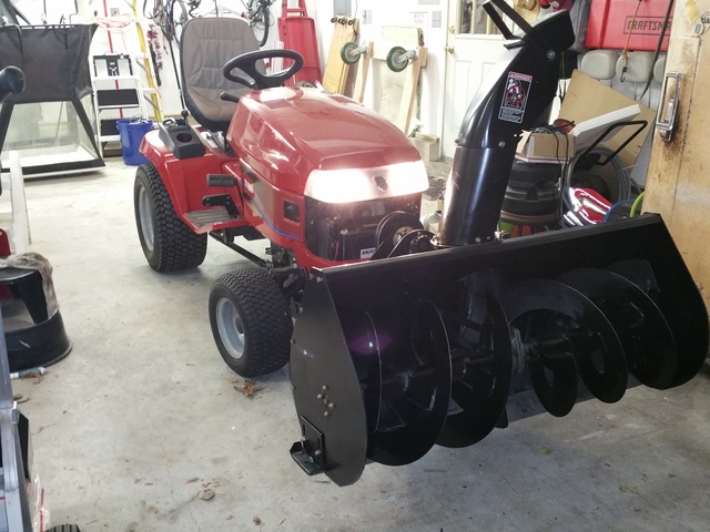

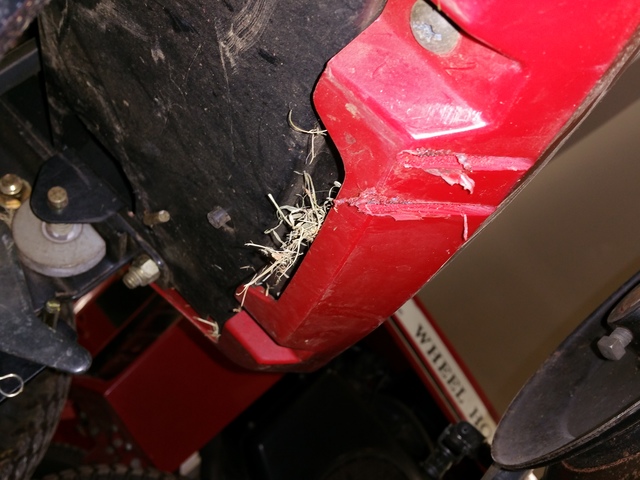

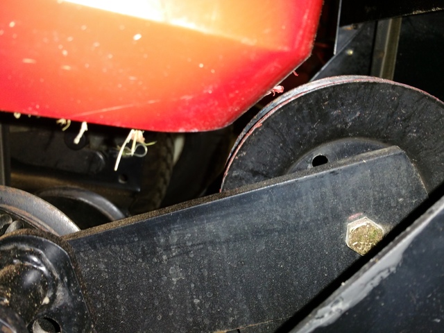

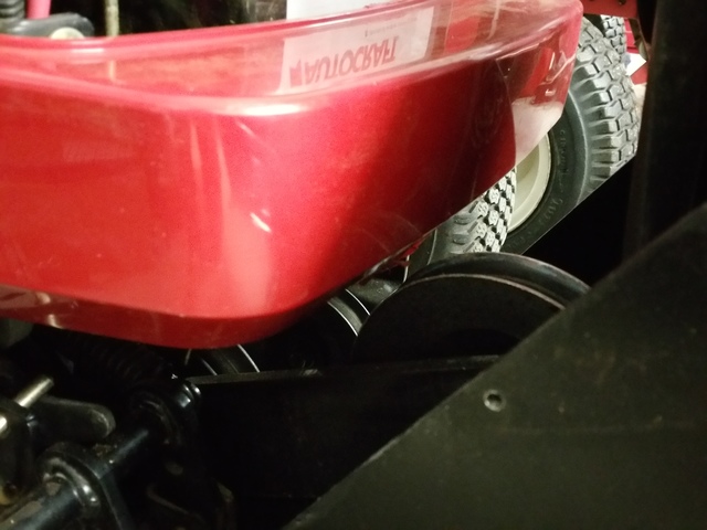

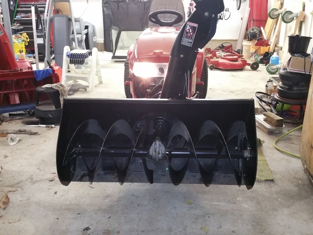

JERSEYHAWG / Glenn 4,498 #14 Posted November 27, 2016 (edited) HOUSTON, we got problems here. first off, the 2 stage is on, took me about 5 hours, including running for clevis pins and such. Glenn notice HOW HIGH I had it out side the garsge, dark as heck, wanted to run the snow blower ,,,,,hear some weird noise, looking, cant see shet......... when I get in the garage, i notice something out of place on the lower trim piece under where the battery goes, BTW ,,,, ran for a new battery to. I lay on the floor, look up at the trim go holy smokes ,,,, the pulley was goughing a hole right in the lower trimpiece,, ,pissed me off, followed instructions. dont know what I did wrong. cant open the hood with the blower in up position. how do you adjust this to not lift so high? I am burned out....less washers on the flag, there is only one couldnt fit 2. try putting flag on another lift hole? Add washers? anyway. heres the damage.,,,,, help appreciated. a nice machine with damage now. theres the pulley, these the damage. Glenn On top of everything else, no spring tension rod for the pulley box. Edited November 27, 2016 by JERSEYHAWG / Glenn 1 Share this post Link to post Share on other sites
gwest_ca-(File Mod) 11,430 #15 Posted November 27, 2016 May be something in these 8 pages you can download Garry 1 Share this post Link to post Share on other sites

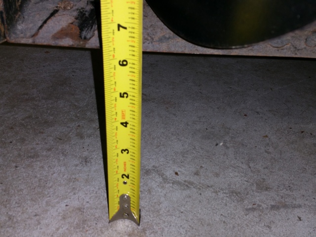

JERSEYHAWG / Glenn 4,498 #16 Posted November 27, 2016 (edited) Ok, here's what I learned today on the xi 2 stage and the lift problem. If you put the flag pin in the middle hole with NO washers, it still lifts it pretty high, 6 inches off the ground, BUT, that belt pulley in the pulley box that gouged the 2 wear spots in my valence trim piece now has about a half inch + - of clearance. John (SHALLOWATER sailor) suggested taking the trim piece off. I might follow that advice. I will post pictures later, I hope this helps someone in the future, I learned the hard way. Glenn Edited November 28, 2016 by JERSEYHAWG / Glenn add pictures 1 Share this post Link to post Share on other sites

Kurt-NEPA 755 #18 Posted November 29, 2016 Ouch Glenn, that scar on the chin piece hurts. At least its down below where you can't see it. Great to see the blower up and running - congratulations. That combination is a beast. Kurt Share this post Link to post Share on other sites
